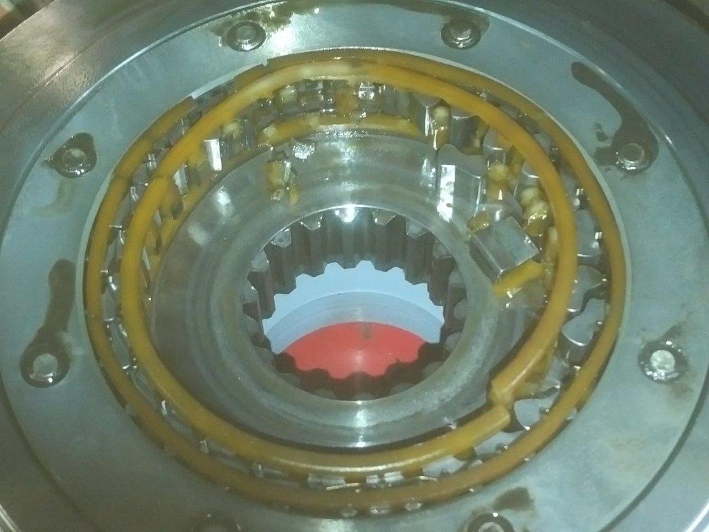

The starter clutch on my Multi Enduro 2016 has broken - the PLASTIC cage holding the clutch parts has disintegrated - is there a METAL cage alternative?

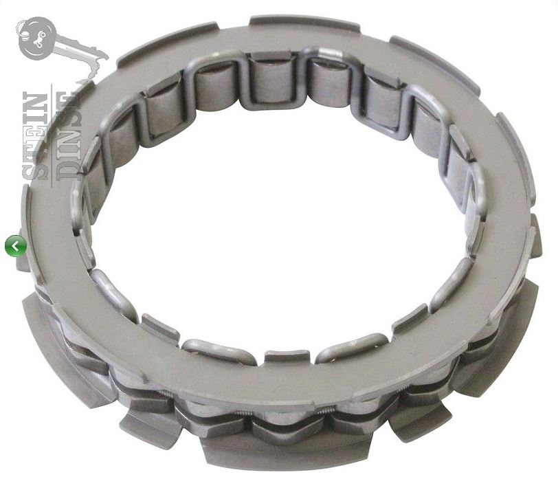

Certainly all the older bikes have metal cages, and the same one fits lots of models: https://www.stein-dinse.biz/product_info.php?products_id=186269 I wonder if the size is different?

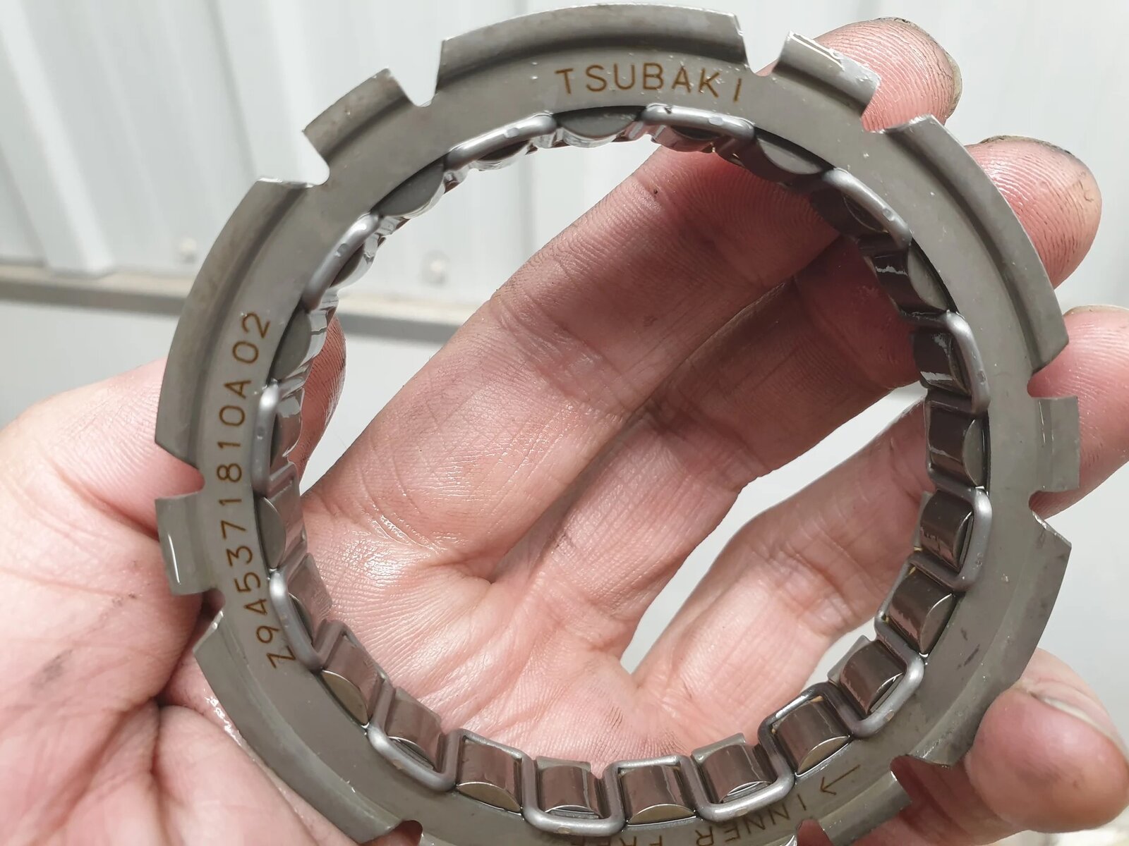

I have an old metal cage one from my 1098 - if you want I can send it to you/measure it to see if at least it’s the same dimensions?
That could be more promising RickyX, SD list the 1098 one for a whole range of later bikes: https://www.stein-dinse.biz/product_info.php?products_id=177605
I don’t necessarily subscribe to the “plastic bad, metal good” view, as these cages are under a low load, and should be sacrificial when something else major fails in the assembly, and reduces damage to a number of other areas where metal shrapnel is bad for short and long term. Like the main bearings. That said, this is likely to be the replacement item - but do your own checks.
