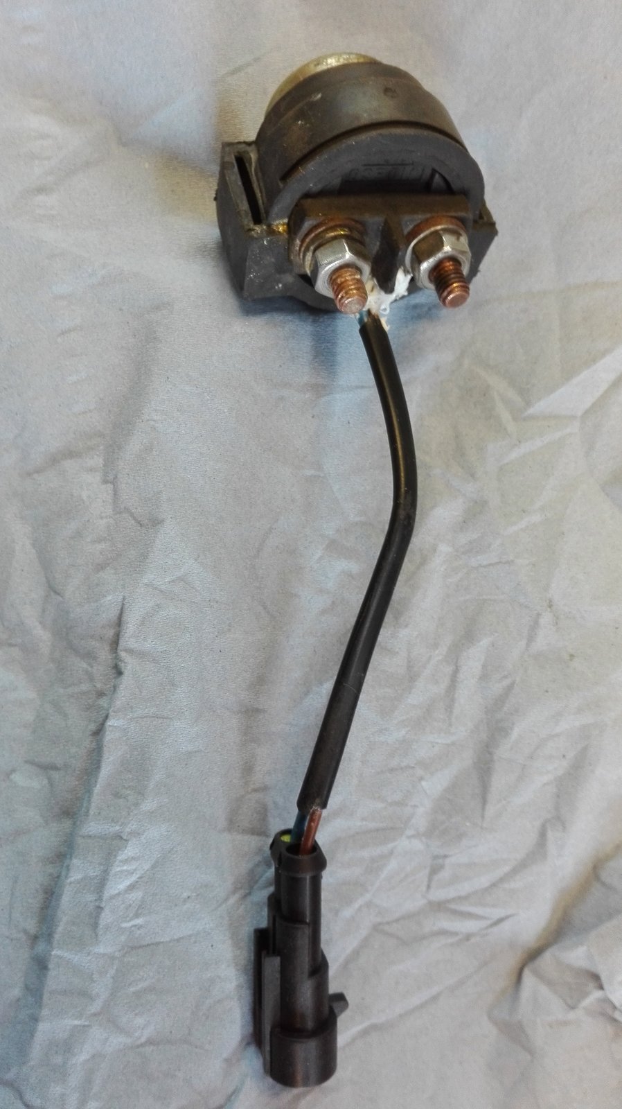

Since the solenoid itself was ok but it's connector was source of the problem, I decided to solder wires directly to the pins in the connector and fit an AMP connector to the other end and fit the matching connector to the loom. It's working great now. The white goop is silicon I used to seal it.
