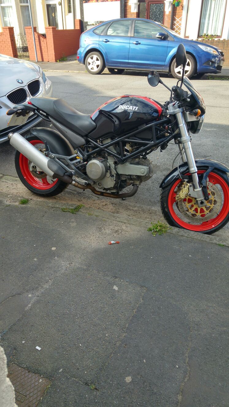

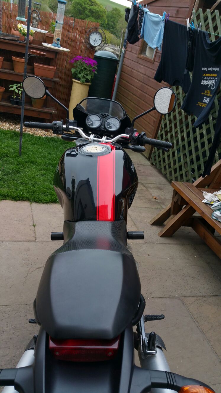

  1. Hi all. Just got me a m620. No service history and the solenoid seems to be shot. Anyone know where to find this?
    I haven't seen the bike yet but it's been delivered along with bits and bobs including a solenoid. My wife did sent me pics of it though.
  2. Thread moved
  3. Sorry.
    Here is some pics of it uploadfromtaptalk1463466533469.jpg uploadfromtaptalk1463466545894.jpg
    Sent from my SM-N910F using Tapatalk
  4. Without knowing the bike... First find the starter motor. It's a black cylindrical object (8 - 10cm diameter) attached to the main engine casing low down (at the rear, probably). It has one thick wire attached. Follow this wire away form the motor. The solenoid is at the other end. This works for almost all bikes.
