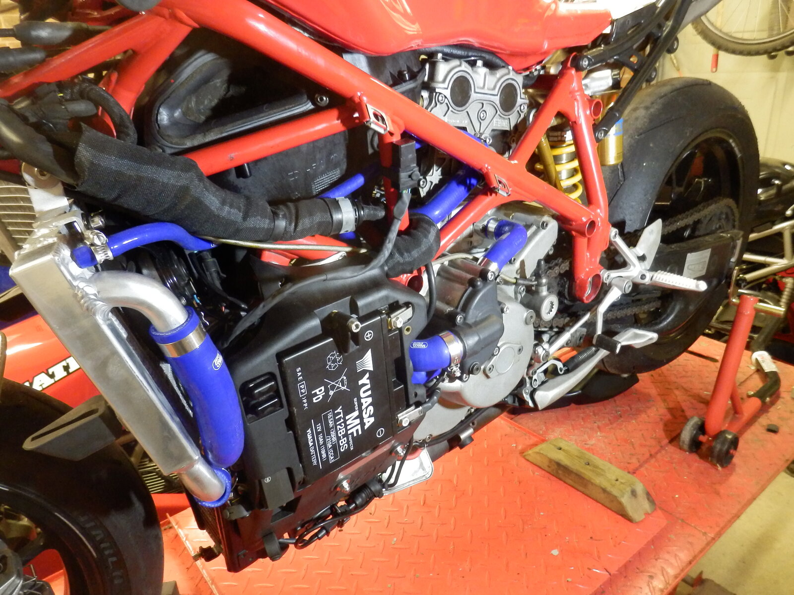

  10. I made up a patch lead and moved mine right up to just inside the fairing panel so that all I need to do to change it is release the two Dzus fasteners and pull the panel out a little.
    I've had so many issues in the past with these relays on my 1000ss and M1000 that I wanted quick access to it at the side of the road and always carry a spare.
    Although I've not had any issues with it on this bike at all.
    It can be seen here just below and to the Right of the forward Dzus fastener receptacle.
  11. Like that mod looks good
