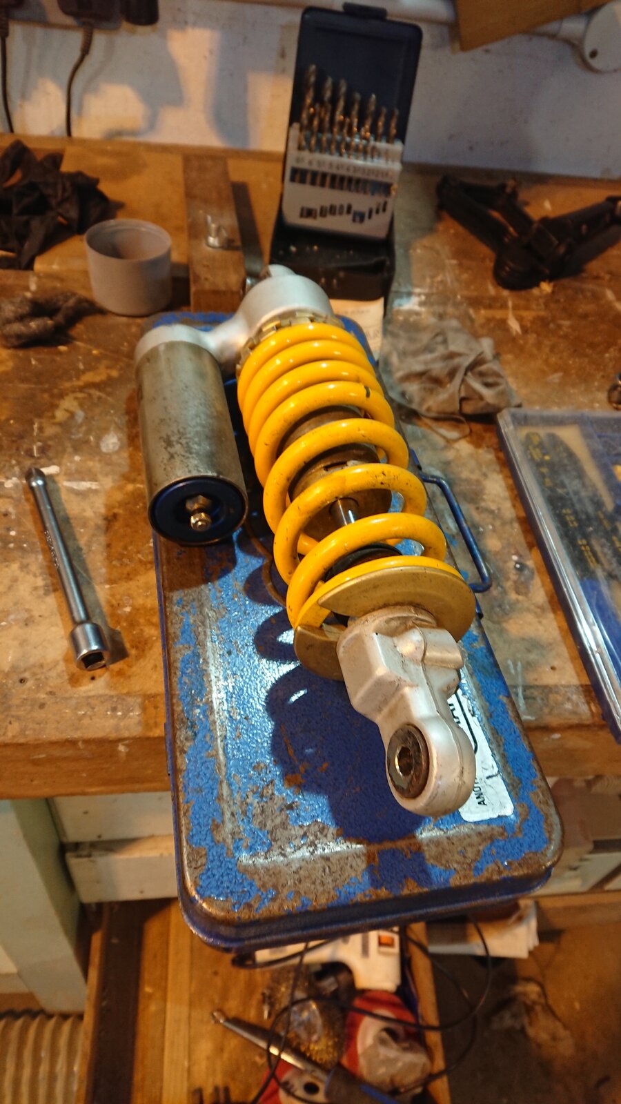

  1. This is the suspension unit on my 95 600ss. Can anyone tell me how to set it up as a starting point to adjust to my weight? I'm 64kg. DSC_0323.JPG

  3. The start point would be to set the sag.
    This would mean putting the shock back in the bike first.
    Summary of job is to take the weight off both wheels, measure the suspension travel to a known point. Then let bike back onto wheels and, while holding it upright, measure the distance to the same point.
    The sag is the difference between the unloaded and loaded measurements for front and rear.
    Can’t remember the numbers right now, but you need to then adjust your preload so that you get the required sag at front and rear by repeating the above exercise.
    Somebody will be on in a mo with the required front and rear range shortly...
  4. Thanks for the info. I found this on another thread..........
    It depends on which shock you have fitted to the bike.....If it is the Sachs Boge one with the blue adjustment knob on top of the reservoir, it should be 14mm preload.
    Rebound screw at the bottom, should be 6 clicks out (anti-clockwise) from fully screwed in (clockwise).
    Compression blue knob, should be 25 clicks out (anti-clockwise) from fully screwed in (clockwise).
  5. Damping does not affect the sag. Sag is purely down to spring rate and preload.
    Sounds like what you have found is the factory settings - these will not be customised to your weight, unless they used a person of your weight at the factory.
