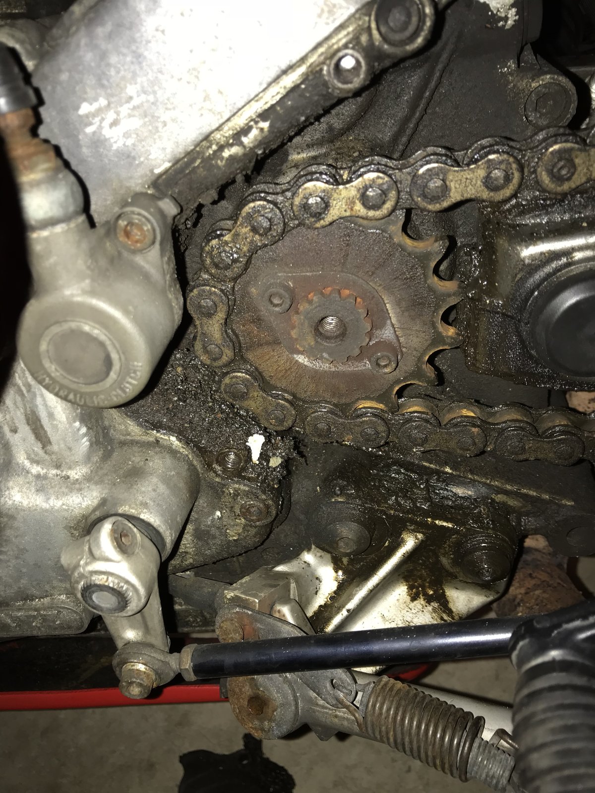

    1996 900 SS - just got the other day.
    Stripping bits and bobs down to see what needs doing. (How expensive a problem it is going to turn out to be)
    Looks like there’s a leak on front fork seals and the rear ‘bushing’ on the rear shock has a bit of play to it.
    Exhausts (non-standard vipers I think) are poorly mounted and don’t make a good seal. Most other things are basically just tidying up jobs which are fine (I hope).

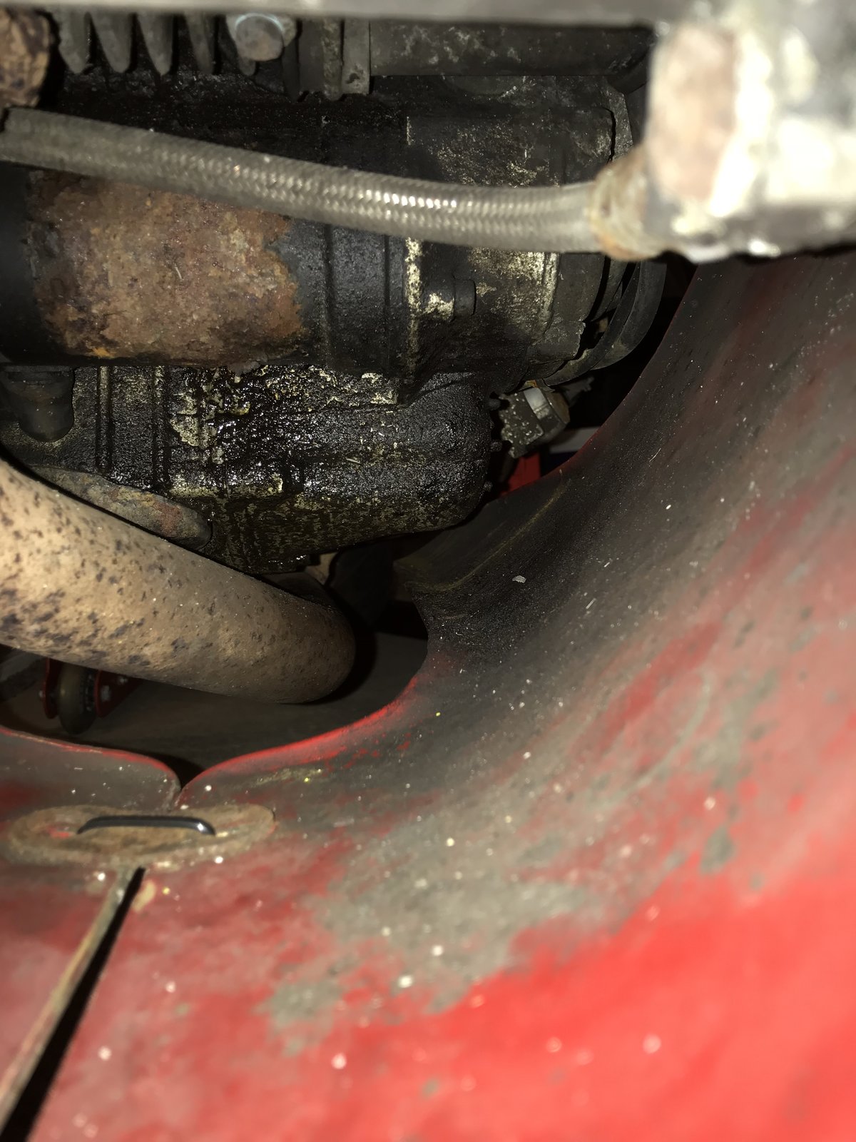

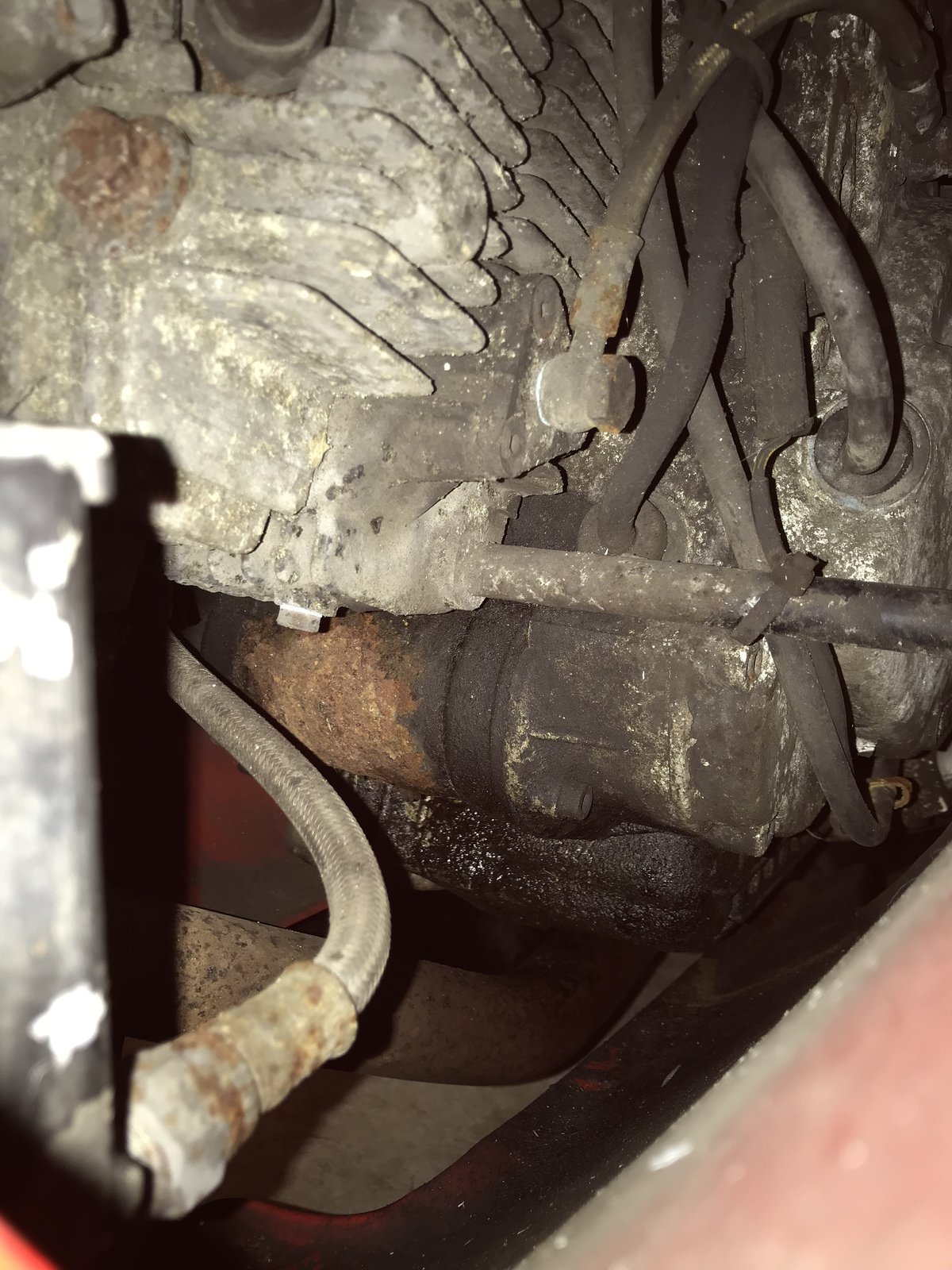

    The most worrying thing I have at the moment is visible oil on the left hand side and the underside of the motor.
    I’ve included pics, but was wondering what you lot think. Where should I start investigating?
    Could it simply be an over-zealous chain oiling?
    Leak from horizontal cylinder?
    Leak from oil cooler?
    Hydraulic clutch?
    Or something else.
    Cheers
  2. You should thoroughly clean it first. What a mess. And it will help you diagnose problems and weak spots easier.

  3. Agree with above, a good clean and then have a good look around, the mess around the front sprocket could well be chain lubricant.

  8. On your first picture in your introduction, it was clear there was oil a plenty underneath it.You say it's not running, Had you oiled the chain in this pic?
    Also This picture interests me the most so a clean would help

  10. My old Monster (same motor) had the clutch seal go and you could see the weep trying to lift the paint, also the clutch reservoir will drop as you pump the clutch to check for that one. When I chopped it in the vertical cylinder had a leak from the bottom but that would be more obvious.

  12. if that's got a scott oiler I wouldn't say its done that chain much good from the rust on it lol
    anyway agree it needs a good clean to see where oil is worse if it is oil
    main places fluid could come from
    clutch slave cylinder common fault
    output shaft seal
    clutch pushrod seal faulty
    or as I found stripped threads for the bolts for the side casing letting oil weep cleaned helicoiled threads jobs a good un
