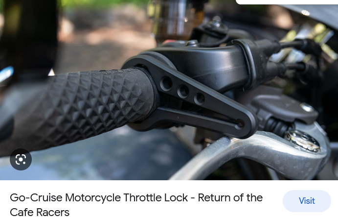

  11. As a young lad I blew the engine up in my DT125MX and fitted an IT175 engine with it's associated carb.
    That didn't have a choke, but I developed a solution for a fast idle to warm it up without having to sit and hold the throttle open.
    It was simply a Mole grip on the twist grip that rested on the brake lever and held the throttle slightly open whilst I got my gear on.
    If I was doing it these days I'd probably try a large elastic band around the twistgrip and master cylinder that gave enough friction to be able to set the throttle in a position without it returning to the stop.
  12. Reminded me of this or similar.
    Cheers Gaz
