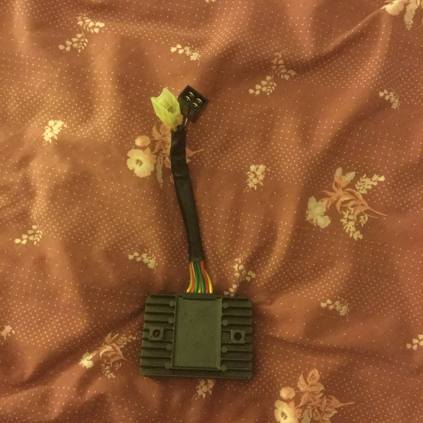

  4. This is an OE rectifier/voltage regulator part no. 54040111C which as you can see has a white connector for the generator wires and a black connector for the battery. Your's shouldn't be any different. Andy

  6. Can't see a reason to do that but at least you've only one colour to worry about and it doesn't matter which yellow goes to yellow. Andy

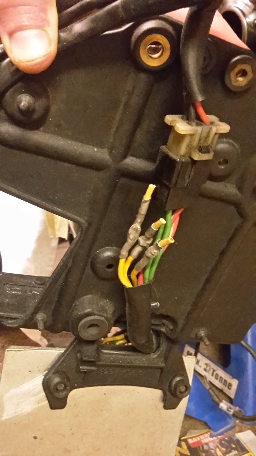

  7. This is the situation I've got. Pic is taken from the back of the battery tray, where the rectifier wires thread through.
    At least that answers my question, think I'll put a plug in there then.
    Thanks guys
  8. I've cut my block out cos they get full of dirt and can cause the rectifier can over heat and burn the wire which happened to me
  9. I use a water proof heat shrink over the two regulator connectors as they are at the mercy of the elements. Andy
