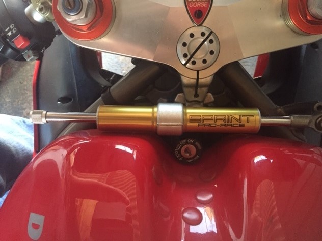

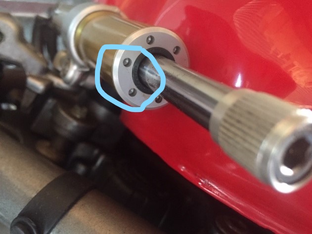

  7. Do you have a picture of it? I'm unfamiliar with that particular damper but I have rebuilt dampers for a living for quite a few years. I have successfully rebuilt standard Ducati 748/9xx steering dampers and yours seems to be of similar construction.
  8. Here is a picture and of where there is a small amount of oil, I did clean as it was on the underside of the body so not sure if this is new or was missed and it not been ridden or moved for a week. I guess it would leak more with more aggressive movement. I will take it out and see what happens. Untitled 1.jpg Untitled 2.jpg
  9. When they leak they usually don't fix them self. On a pressurised damper a small leak might not have any negative effect for a long time but on a through rod damper like this it's a problem right away. From the look it's similar but easier to fix than the standard damper as the ends appear to be screwed in. I can talk you through the process if you want to have a go yourself or I can fix it for you if you cover postage, oil and seals etc. I don't have access to a Dyno to check it afterwards but I doubt this type ever sees a Dyno as it doesn't see the high frequency input that wheel suspension deals with. If it feels right it's I'd say 99 percent it's going to be right.
