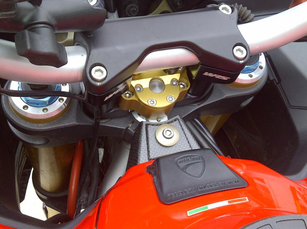

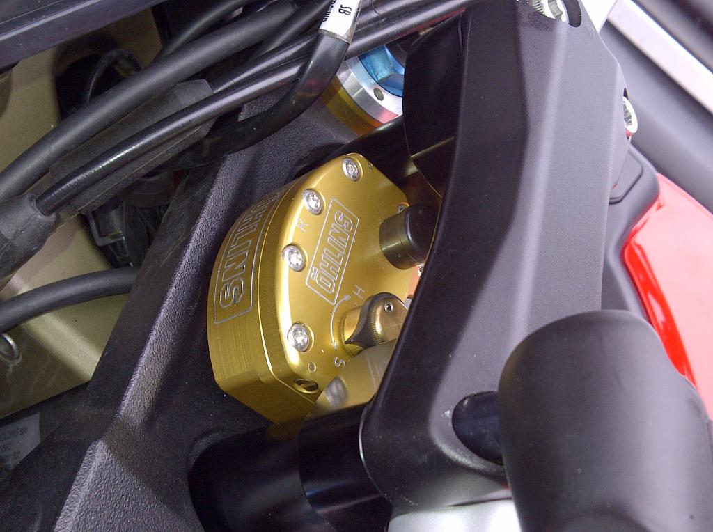

  14. Just fitted mine.
    As soon as i've done a few hundred miles I'll report back.
  15. That looks lovely. Was it easy to install? What was involved?
  16. Lay blanket over tank, remove handle bar clamps (x4 bolts), remove bars and lay on tank.
    remove risers (x2 bolts).
    Fit new billet risers (as these have bracket to hold Ohlins damper).
    Fit Ohlins damper (x2 bolts).
    Fit fixed point billet'ed clamp to above steering lock.
    Then two people to joint Damper to fixed point. A bit fiddly.
    Then re-attach bars.
    0-25Nm and 10-50Nm torque wrench required.
    Took above 3hours, but mainly as the billet risers were way too tight on the new mounting rubbers and needed honing down.
    I think it was due to the anodise finish.
    No instructions from WRS, total cost was about 600Euros.
    If the risers were correct then about 2 hours.
    #18 AirCon, Jun 24, 2013
  17. I cannot seem to be able to add that to the cart on that site. Do you know if its available else where?
  18. Did a short test drive to Wimbledon in rush hour traffic, so that's not much fun even on a mutley.
    I've set the bars too far forward, despite my pencil marks. Going to rotate them backwards,
    then off to Exmouth for the day, 6 hour round trip so a better report to follow.
    Note I purchased the Öhlins from fleabay, not the Web link above.
