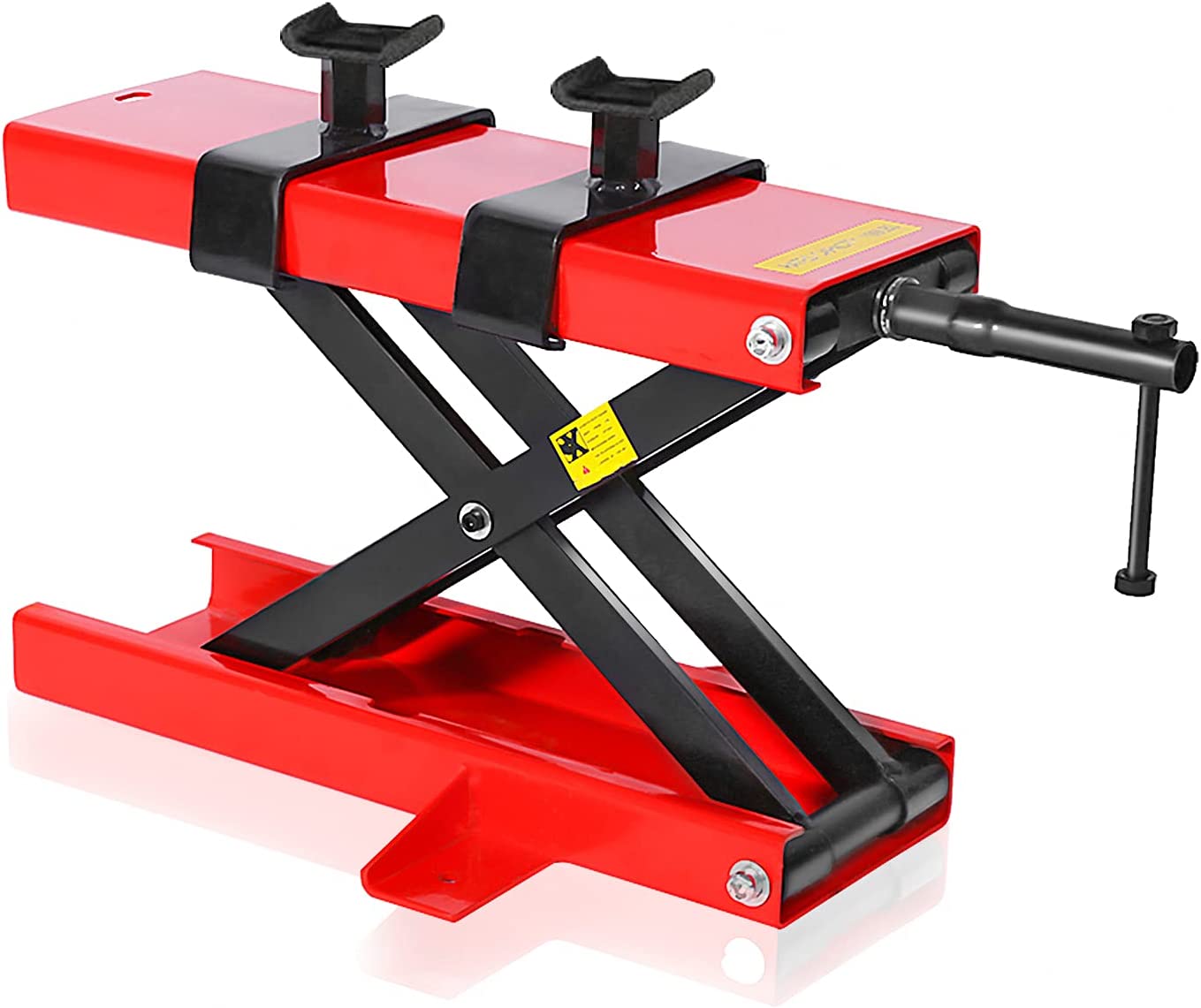

Trolley jack and a block of wood under the motor/frame I also have one of these which is even better, though mine has adjustable pillars

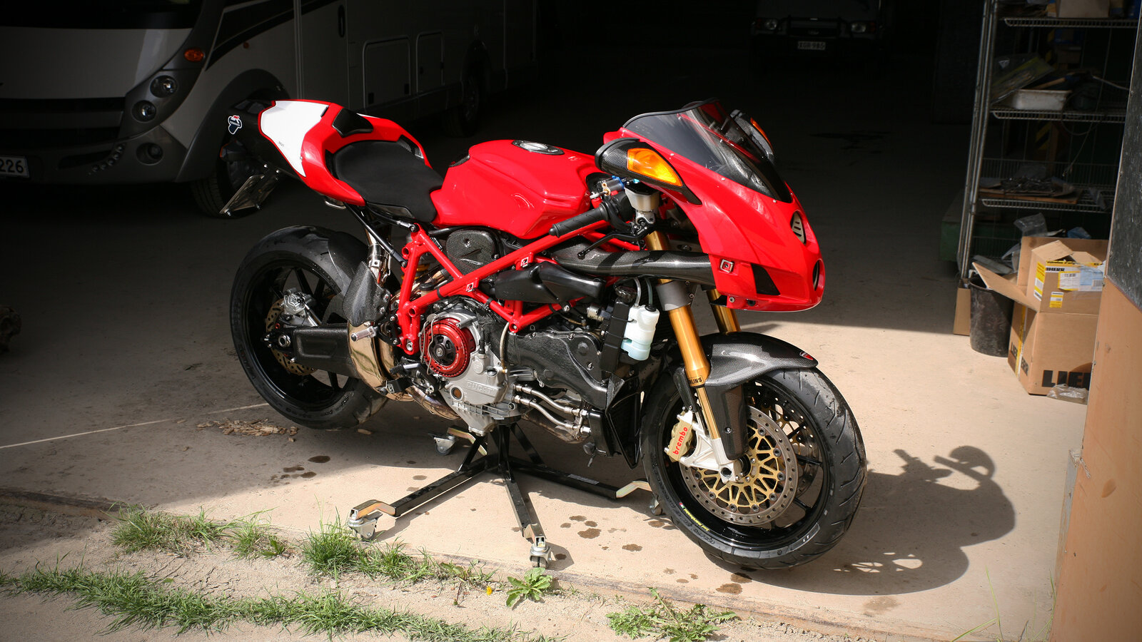

ABBA type stand and lots of blocks of timber. Or, straps through frame and onto garage rafter. Or both for extra peace of mind.
For the uninitiated, ie myself. How do the stands like Abba and Bursig react when you remove a significant weight from one end of the bike, like say the complete front end including forks, yokes etc? Do the bike and stand constantly need to be moved or balanced?
For the Abba, some weight will remain on the front wheel but greatly reduced. You can get a kit to lift the front but I just strap to the roof.
