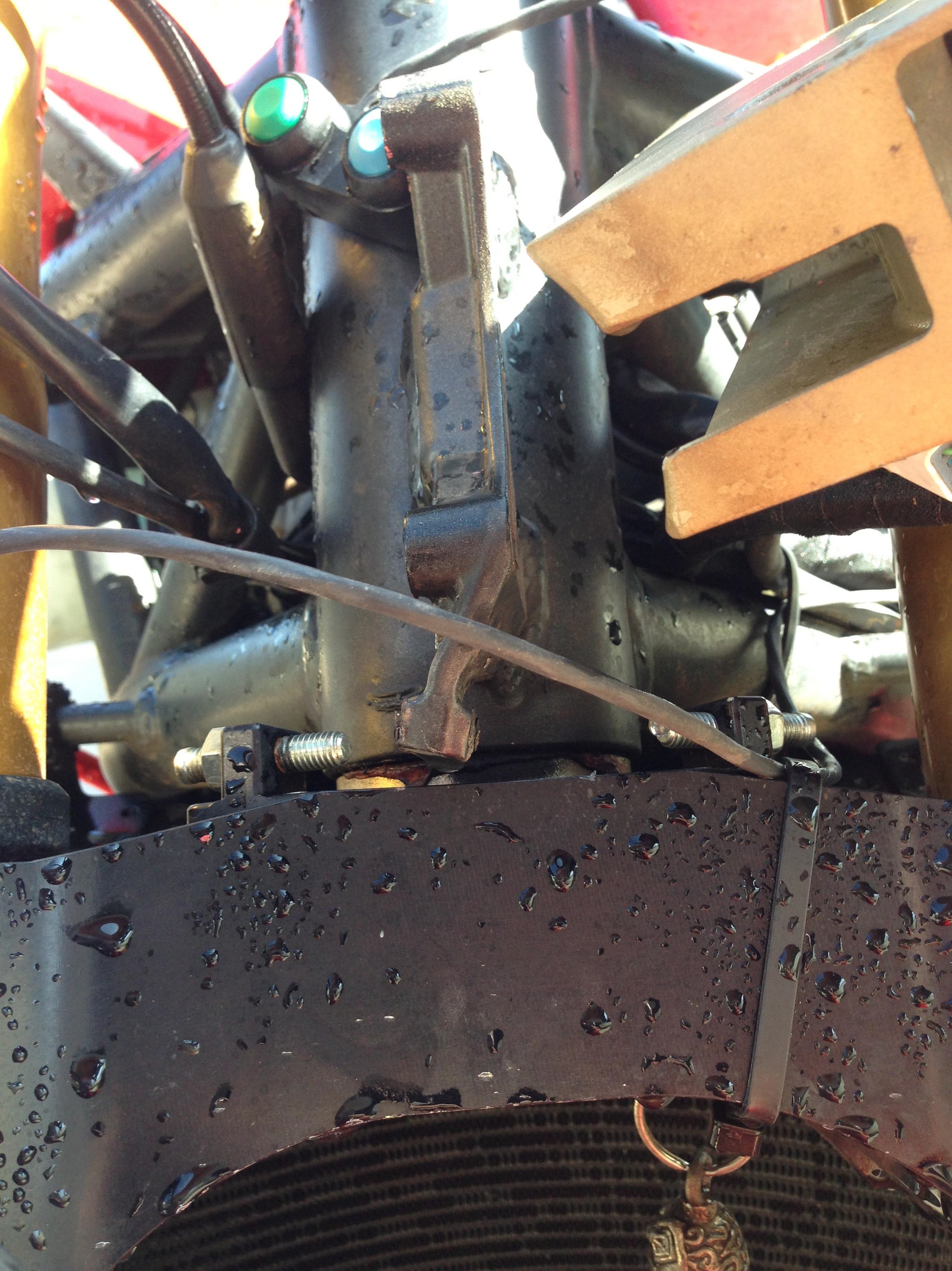

  12. Cheers @bootsam if you've get any pics of what the tang is & where to find it, that would be great. As currently I've no idea what your going on about ;)
  13. I just googled it and found this. You can see the tang and the adjusters clearly. This one has had a shunt too. :)
  14. Thanks buddy... Will see if I can see it 1at without having to remove the front nose cone off
  15. Just use the adjuster screws. You can reach them down either side of the dash. Look down and you can see them. Dead easy to adjust. 5min job. Honestly.
    Sort the tang out later whenever youve got the front off some time in the future.
  16. So to confirm, adjust both screws on each side inwards a fraction then test to see if they catch & steering locks
  17. Turn bar to the left as far as it will go, then loosen off the adjuster on the right until you can put the steering lock on. Leave a bit of play (a tiny bit) and then tighten the lock nut. BTW its an allen head on the screw. I forget the size.
    Oh unless its been mullered like the one in the picture.
