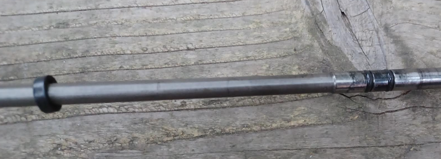

    I recently carried out a quiet clutch mod, replacing the backmost steel for a friction plate.
    Been working perfectly well in the 150+ miles since.
    However on my last ride out, I noticed that the clutch lever didn't feel as it should.
    And, in fact, when I arrived home I couldn't get the bike out of gear, i.e. pulling the lever right in wouldn't release the clutch.
    I've removed the pushrod today, and added some lithium grease (assuming this is ok to use).
    However, I can still feel the pushrod "sticking" as the lever is pulled in.
    Never had any problems with it before the quiet mod, whether that is just coincidence though..
    You thoughts would be appreciated as always..
