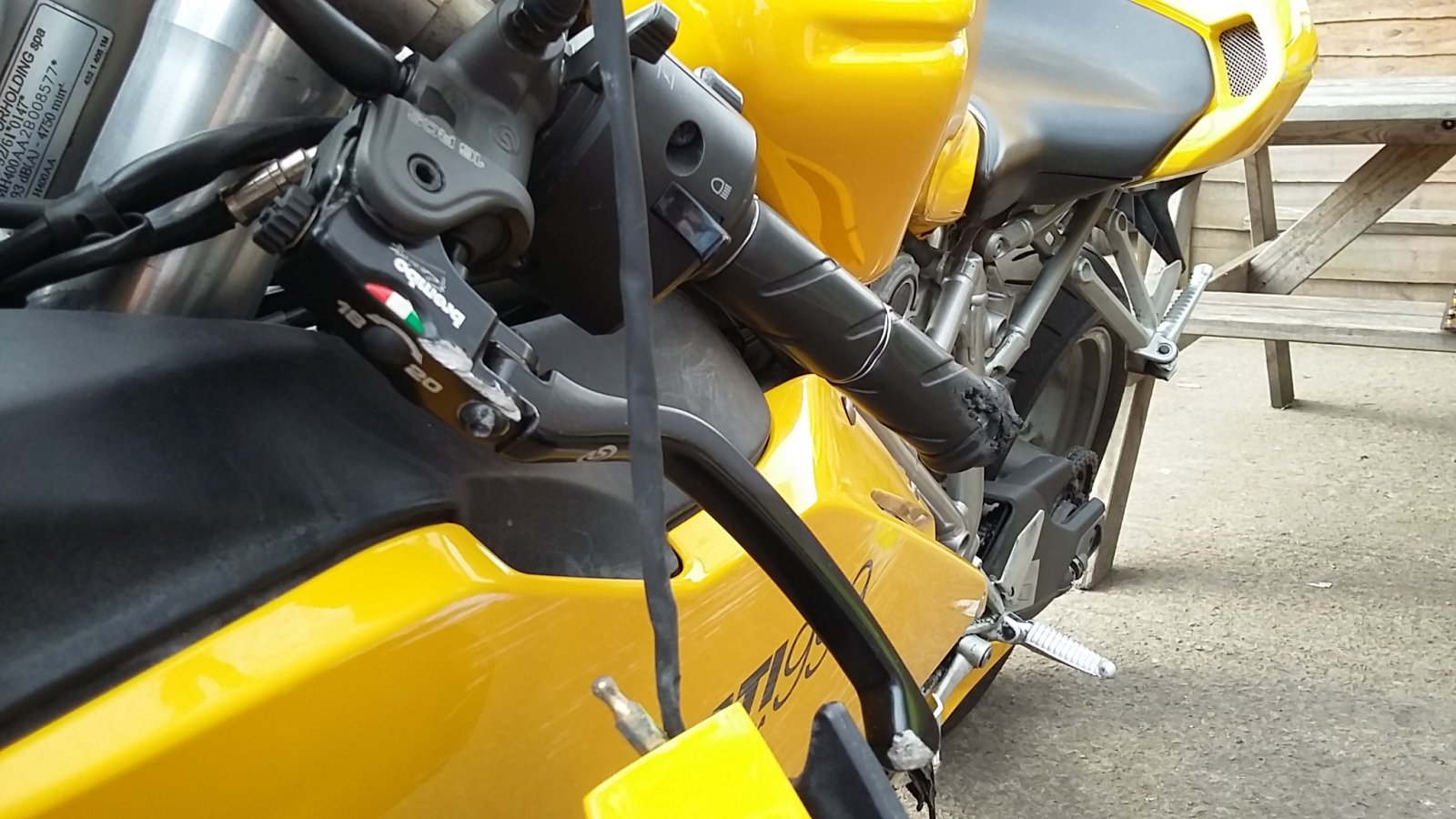

  15. Bit of an update on this thread with unfortunately a very sad twist.
    I had the bew RCS levers fitted last Friday and went to collect the 999 around 430.
    Perfect road and weather conditions.
    I literally rode 300metres from the garage when disaster unfolded.
    Tickling along at 30 mph ish in built up area. When a myopic car driver in a golf reversed off his drive into the road about 30metres from me. Couldnt swerve due to opposing traffic. Grabbed a handful and footfull of brake but to no avail. Bike went down and I parted company.
    My bike is a write off. Im devestated! Must have went down at no more than 20mph but it slid and ended up with the front end under his back bumper off which he continued to keep reversing over and managed to bend the headstock, forks and frame.
    For what its worth the levers were bloody lovely. Clutch was like a well oiled rifle bolt.
    If anyone fancies buying a pair of virtually new RCS levers give me a shout as ive had them stripped off. Bit of road rash on clutch lever though.
    One less 999 on the road now Im afraid.

  18. That's incredibly bad luck hope you find a new 749/999 as they are going up in price now
  19. I've literally just bought a really nice condition 2006 749 in yellow, needs the cold starting looking at. Running really, really rich and needs the choke on slightly to stop stalling. Will get it to my trusted spanner man Asap but I'm hoping nothing major needed to sort.
