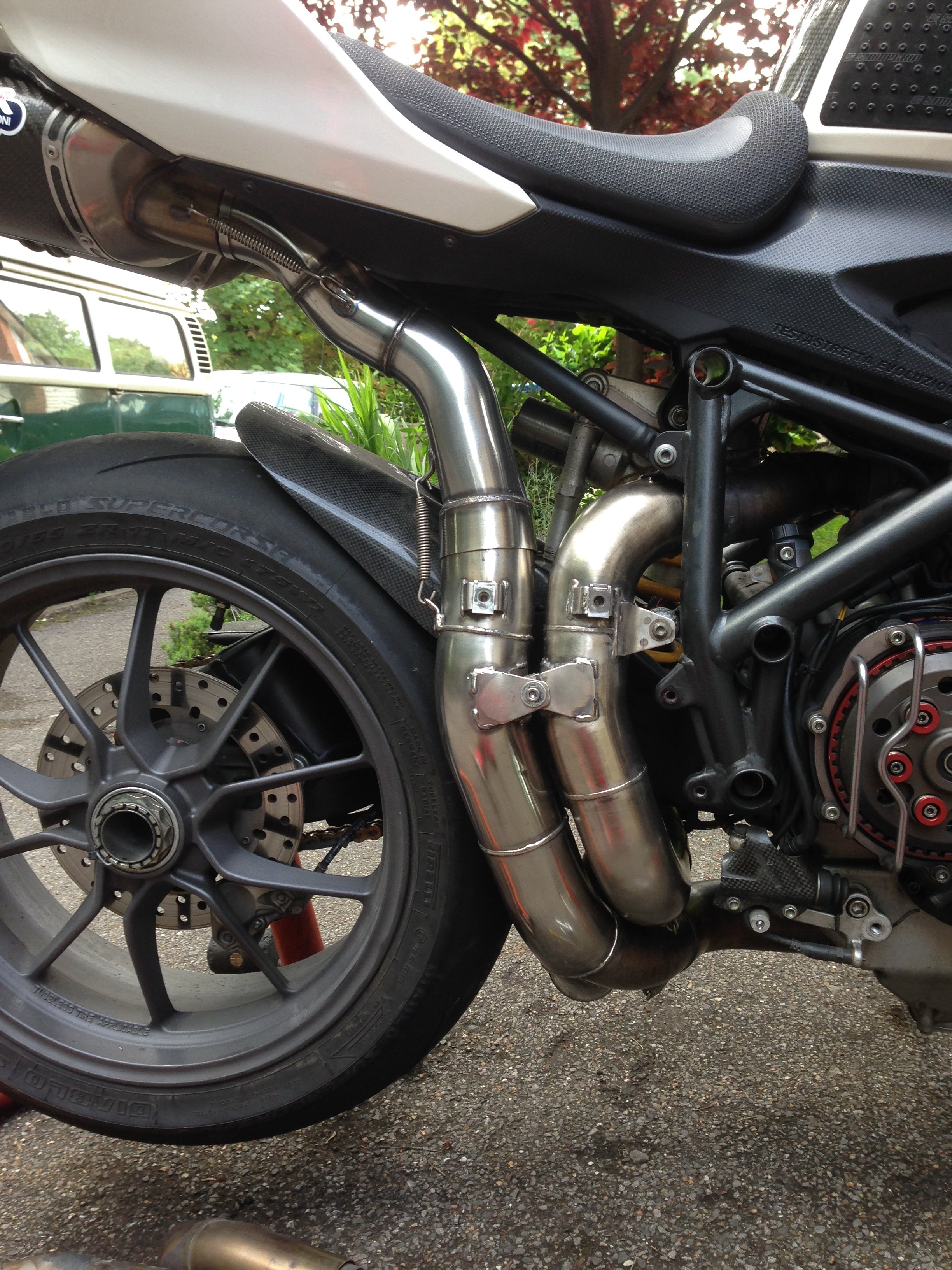

  13. You will only need a tacky pressure plate if you have an open cover. I run mine generally with the OEM clutch cover. Unless its hot where I am going, in which case i use a grille thing instead. I prefer plain pressure plates. The plainer the better. Mine is a kind of dark grey. Rather typically ive just put the oem back on after my alpine trip. I will look for the pic that i posted for my 70mm as this showed my clutch. I will edit and post it back here or take the damn thing off again for you and take a photo tomorrow. Your OEM one will work fine.

  14. That looks good. As an aside your exhaust look nice and shiny too. No need to go to the bother of removing the cover Bootsam that photo is fine.

  15. Forgive my red spring caps. I had 2 of my spring pillars undo a bit and it wore the caps against the inside of my oem cover and filed down my black ones. I had some red ones spare. Honest.
    Exhaust will be black soon enough.
