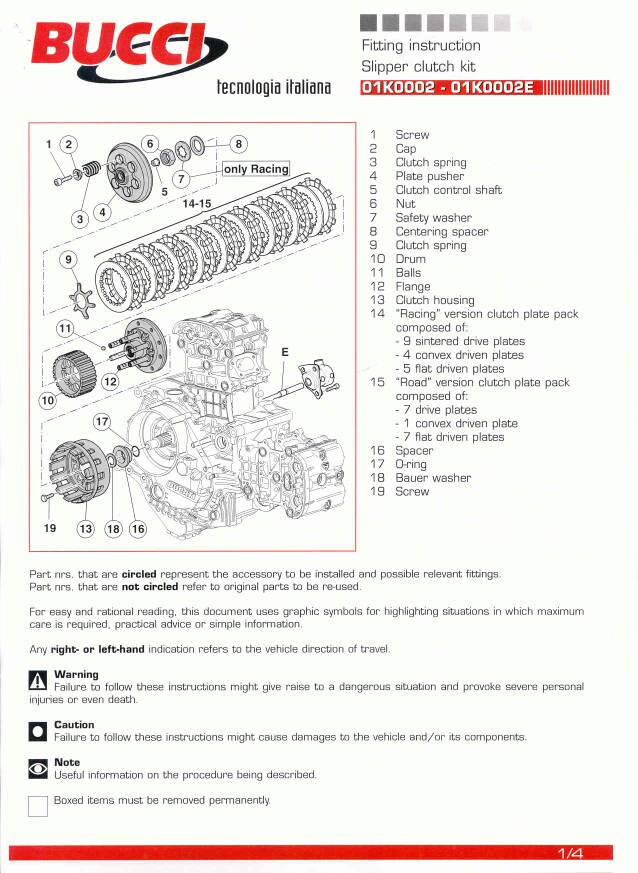

As above. I remember someone posting about swapping over convex plates. But damned if i can find that thread or post. All the plates in my clutch are new, both the friction and the plain ones. It had no convex. I have some spare convex from my OEM plates and some from my 916 and the set the STM came with, so I have spares. Any advise on where to slot in the convex? I think it was the 2nd plain plate down...my short term memory is shit. Cheers.
The plate arrangement should be something similar to this although the clutch is different. Deffo a specific order as I did mine wrong initially and rearranged sorted it
