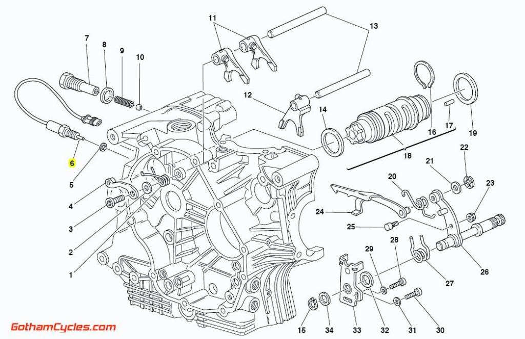

  2. sounds like neutral switch is kaput or loose. If it was on 996 style bike i'd say it's an easy check being the only wire going into the gearbox, but i'm not so sure on the newer stuff where it is
    Just had a little check on the interweb, and it looks to be a similar place, right at the back of the gearbox.
    Unplug it from the loom and check the light. If not on, put a bit of wire in the loom side shorting out the pins. If either of these fixes the fault it's just switch related.
    part number 6.

  4. The switch was fecked on my 1098 motor.
    Not too expensive to buy...:upyeah:
  5. Is it an easy fix ? Is it the one that passes through a flexible plastic grommet?
  6. On back of engine/gear box.
    Unplug the connector and remove old switch with a small spanner, then screw the new one in, tighten, reconnect connector.
    No need to drain the oil...:upyeah:
