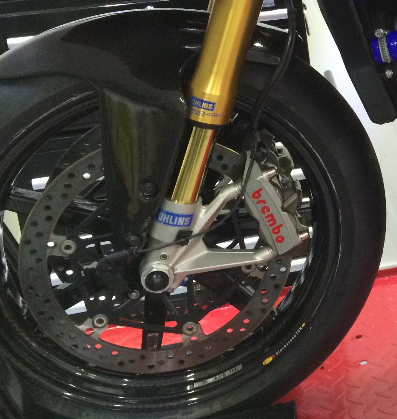

  1. Just wondering what the situation is if fitting 320mm disks to a 2010 sfs? Is the any problems with the dtc or anything else? Any advice appreciated
  2. Which Streetfighter ? The 1098s has 330mm discs as standard with the spacers being part of the speed sensor bracket. That means you'd have to find a new speed sensor bracket. If you SF had 320mm discs as standard so long as the offset is right, should be no problem. Andy
  3. Its the 330mm disks 1098s, I did wonder about the spacers, Will just forget what I had planned then. Appreciated
  4. Also the 320 discs don't have the DTC pick-up bobbins.
  5. It's not impossible, just need to find which bike has 320mm discs and a speed sensor. You should be able to use that bracket. Andy
  6. What are the benefits of the 320mm discs?
    My 1098R has a nemesis TC system which doesn't use the standard front pick up, so no concerns there.
  7. Lower rotating mass so in theory, should make it easier to turn. Andy
