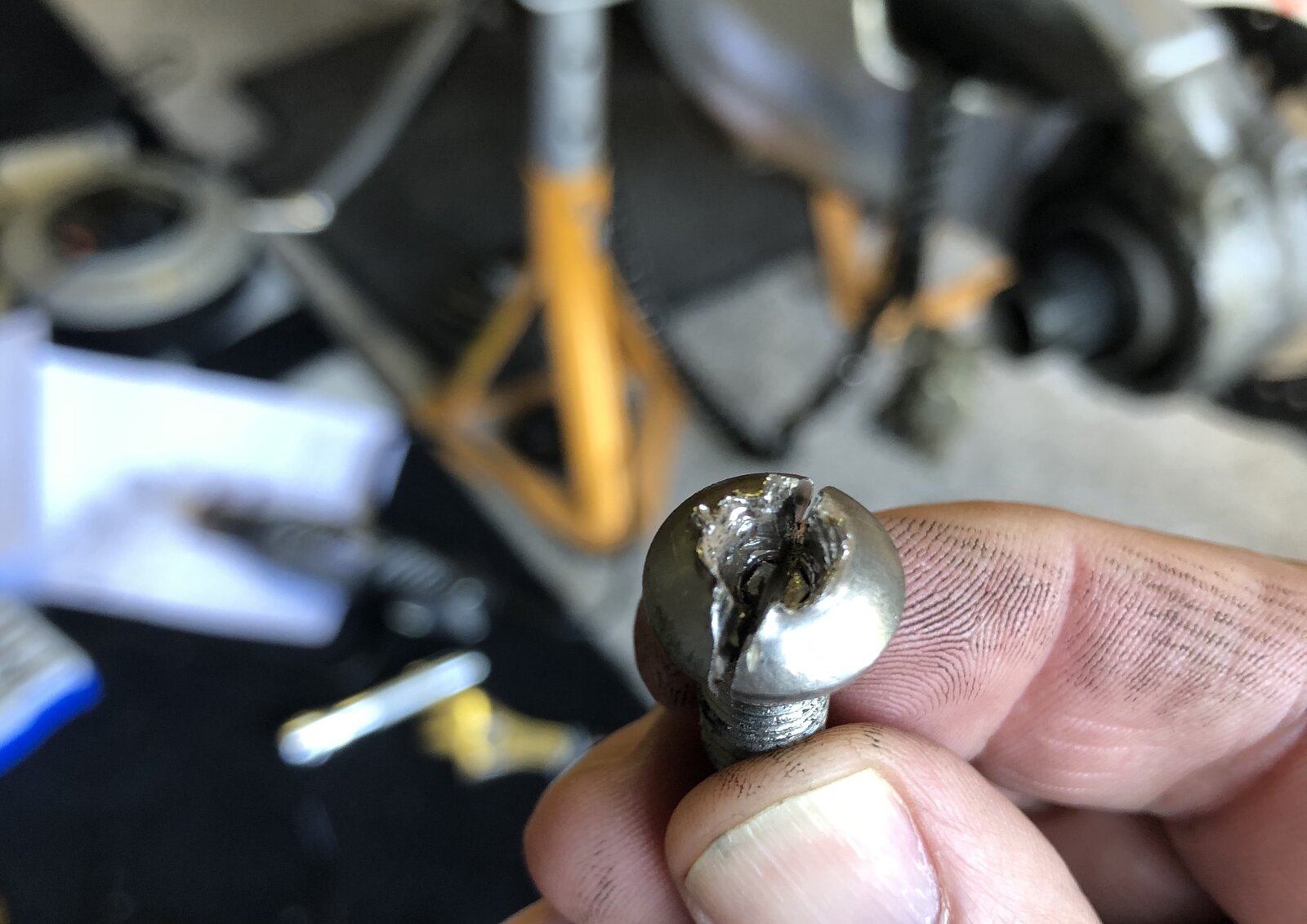

  1. Had my bike just ONE day and i've manage to strip an allen bolt trying to get the trim around the radiator off :( Really f'd off :( What's the safest way to get it out? I don't want to damage the plastic around the bolt.

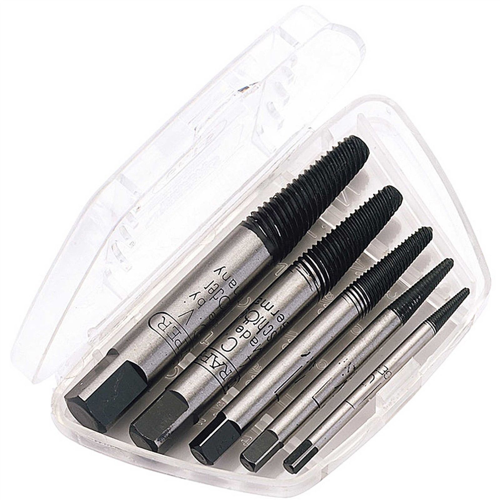

  2. You say you stripped it, Take it you mean the allen key is turning in screw head? If so use an easy out
  3. Yup allen key just goes round and round. Easy out?
  4. If you have some torx bits find one that needs tapping with a hammer nice and solid as they are slightly tapered, should do the trick.
    • Agree Agree x 4
  5. if its an allen head use something like this, wont need drilling, Halfords etc have them,
    For some reason the forum isn't letting me add link, Just put draper easy out into ebay

  8. Yep had this problem last week Allen bolt on my rear for the rear calliper. Tried everything, hammering a torx bit in, impact drive, drill and easy out (snapped the easy out in the bolt). In the end I got the dremel out and cut a slot in the head for a flat blade screwdriver and a spanner to turn it with.

  11. I've had this happen to me 3 times now. (1098R fuel pump flange, Hyperstrada subframe bolts & 1098 fairing) The way I got 2 of these out was to Dremmel a slot in the head (as above) and use a screwdriver to remove. In 2 of the cases, where the bolt isn't seen, I replaced them with hex headed stainless bolts.

  14. Some good ideas here. The bolt is sunk with plastic surrounding it :( Scared to use a dremel. It might be my only choice. I’ll gave another go with a torx and a hammer. Wish they didn’t use such small sizes. The problem occurred because it was smaller than my smallest proper Allan driver in my socket set and I stupidly resorted to using a cheap one.
  15. If it's one of these button head types they are horrid and take a size down from a regular cap screw, I aways use something else to replace them, even if it's not as pretty
    I do what others have suggested, cut a slot in it and try to get a screwdriver to remove.
    If that doesn't work I batter the living shit out it on one side ten the other with a hammer and old screwdriver or perferably chisel if it's big enough
    Easy outs can get you into more trouble as they are hardened, if you break one in the screw you are in for a lotta fun (ask me how I know?)
  16. Worst case, centre it, and then drill out with slightly smaller diameter drill, it then will come out easy enough, most of the time torx bit will do the trick but if it’s a real small size and very soft cheap bolt it might just mush up
  17. I use a punch and hammer and drift them out enough to get a set of grips. No fear of slipping with the cutter

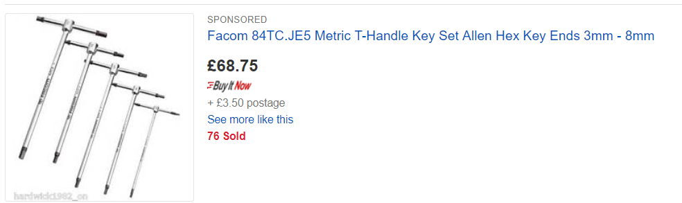

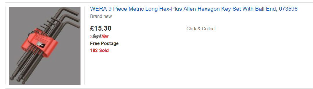

    Then by yourself a set of Facom T allen keys (good sharp hard edges) and a set of Wera L shaped Ball ended wrenches.
    The Wera Hex Plus style - that seems to round less as they are shaped differently
