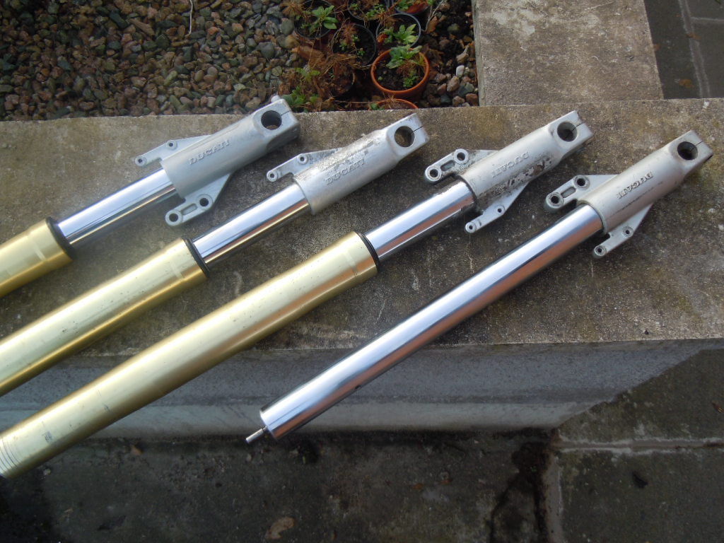

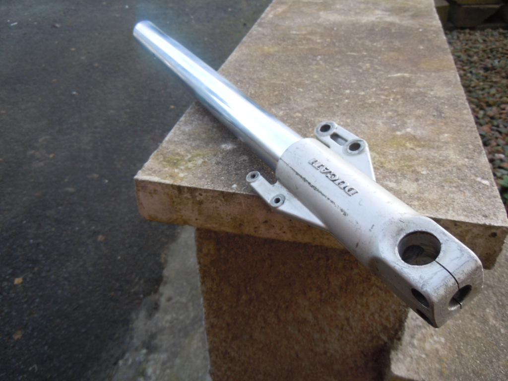

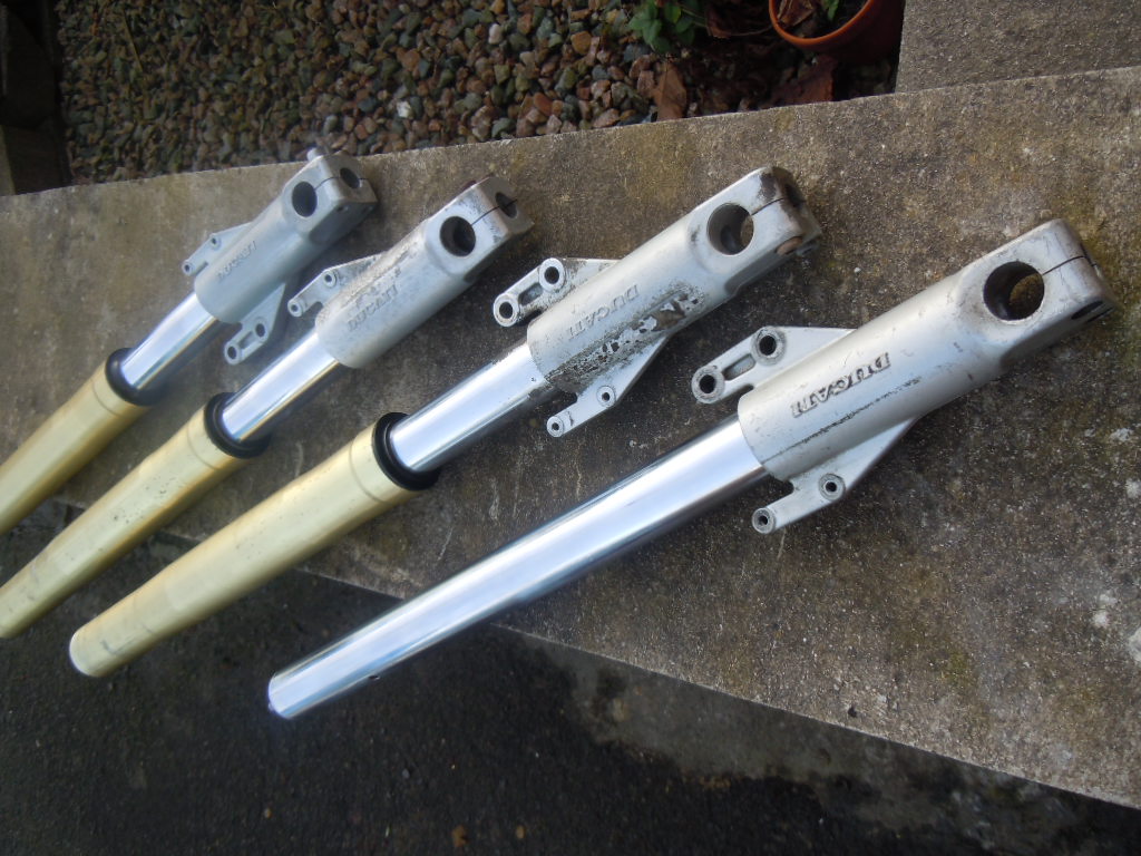

    I have a couple of photos for those interested, (no laughing at the back)..

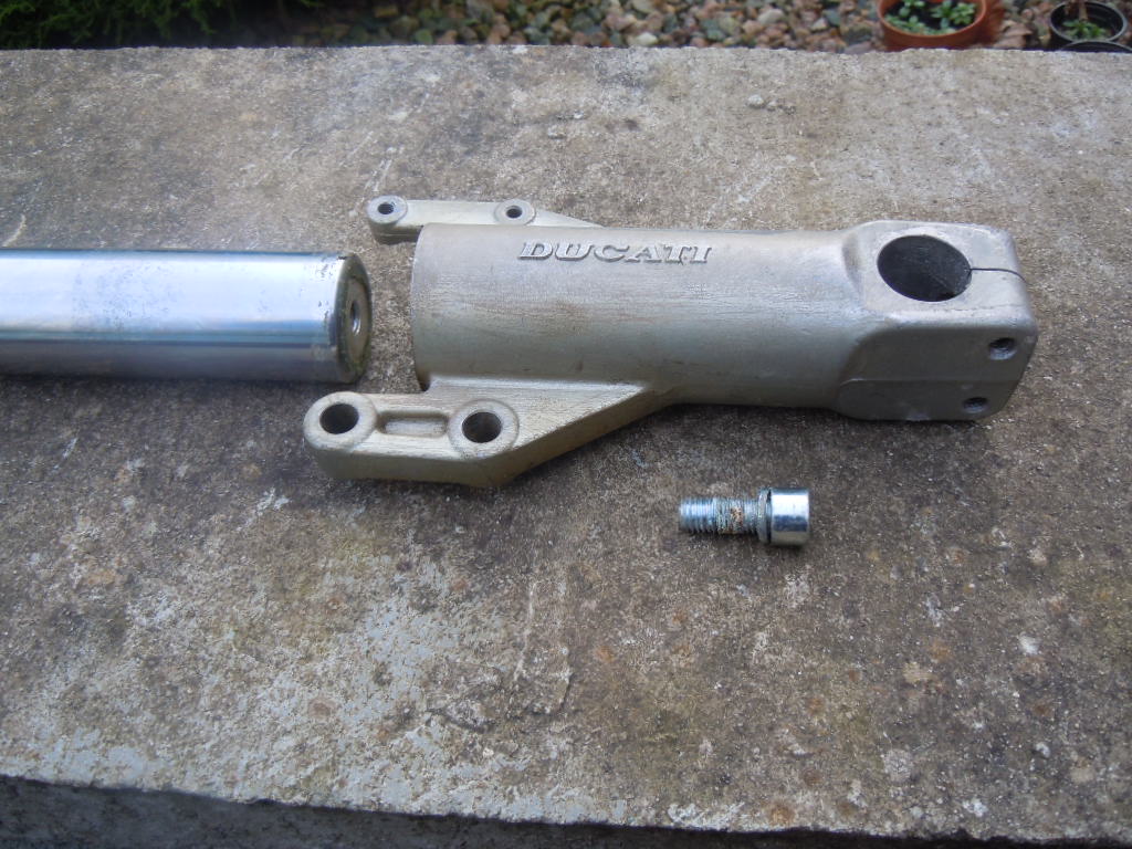

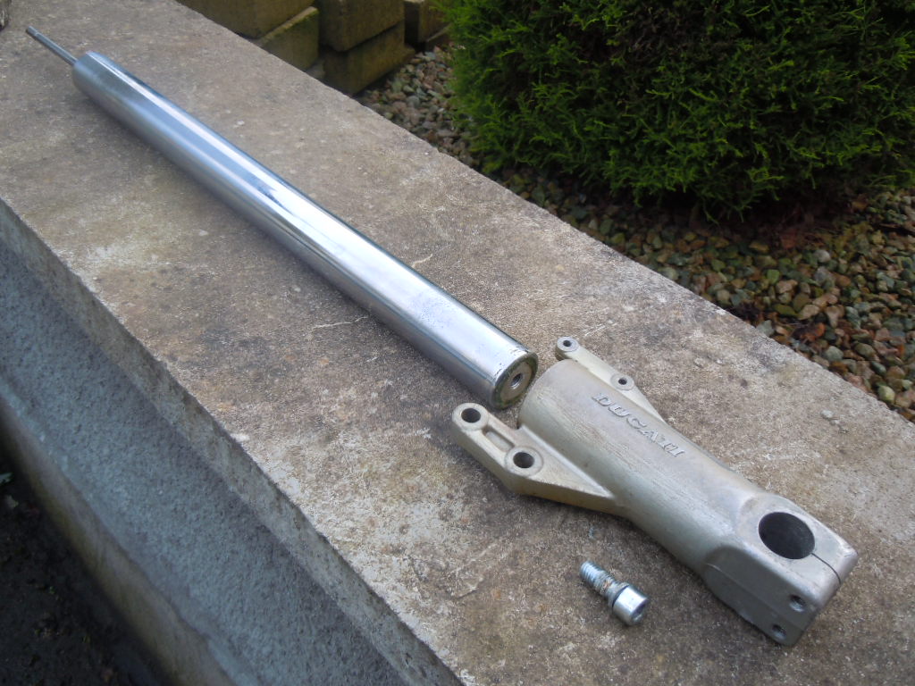

    Here are a couple of photos of the Stanchion and Clamp and the fixing screw..
    After cleaning the Stanchion and the bore of the Clamp, the parts will still be an interference fit. In the centre region of the bore, there is a 3 thou relief for retainer.
