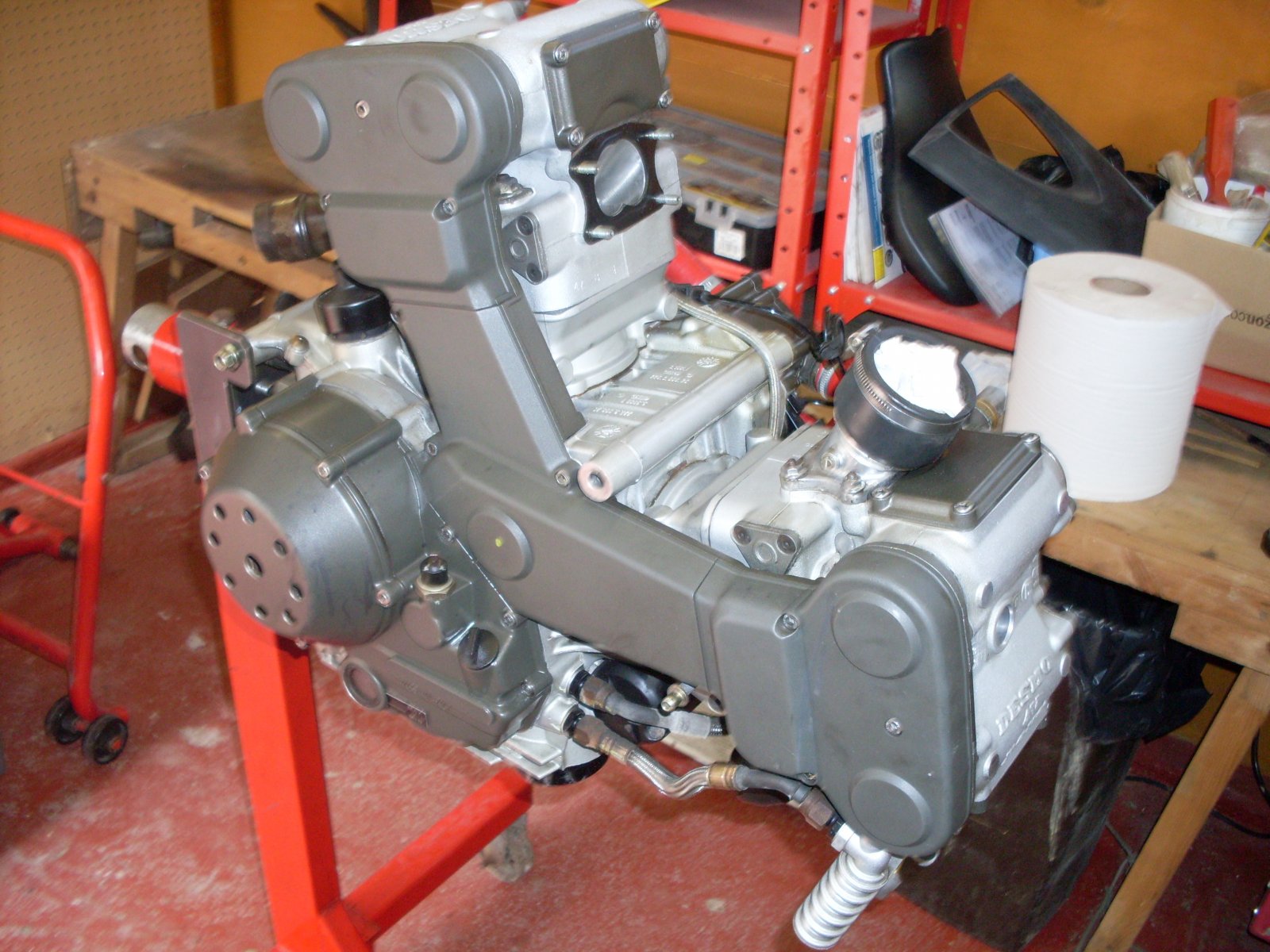

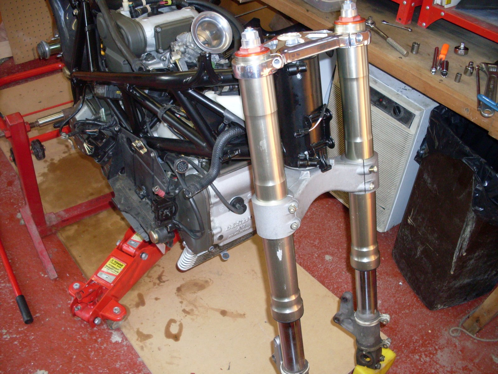

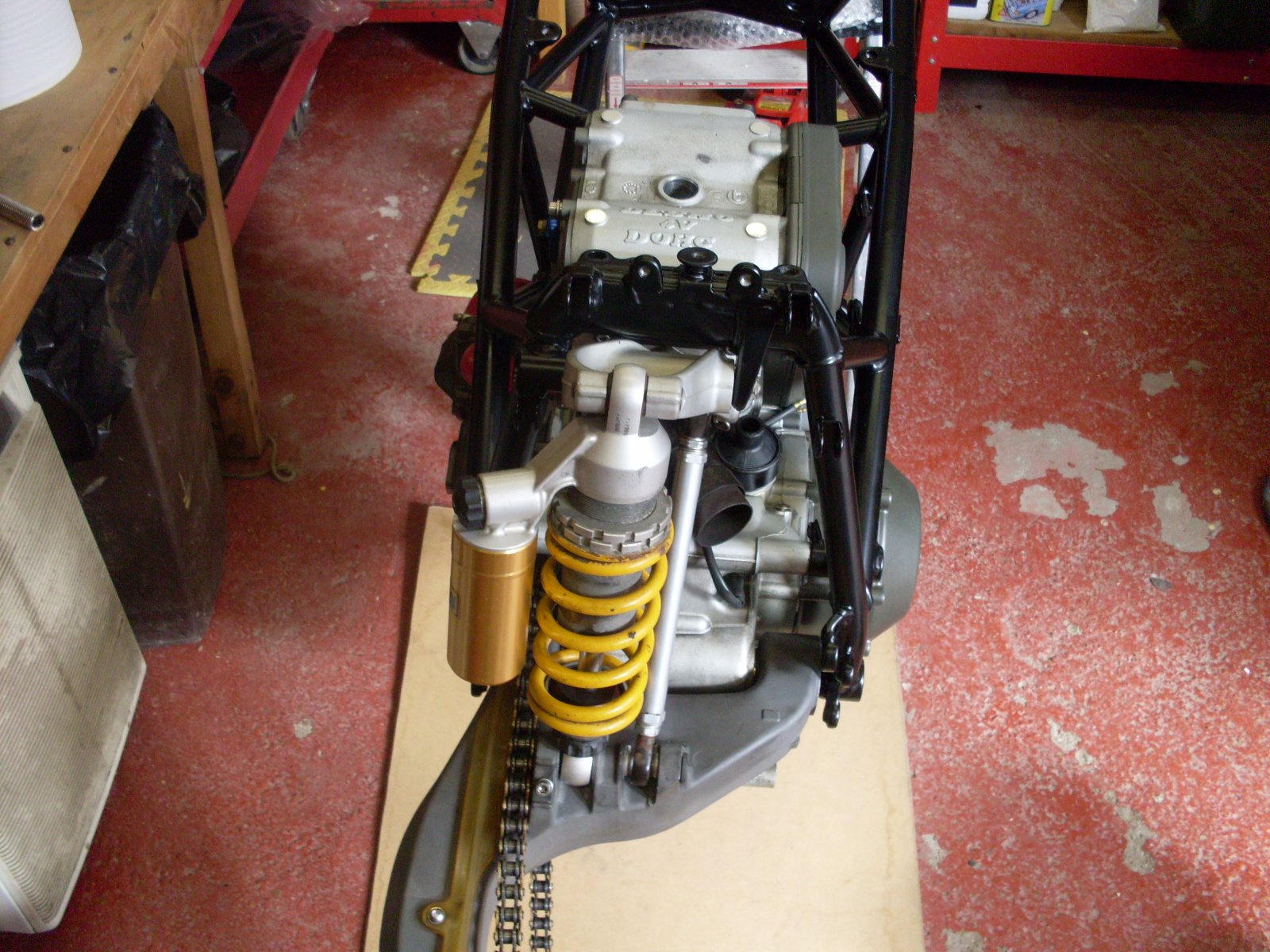

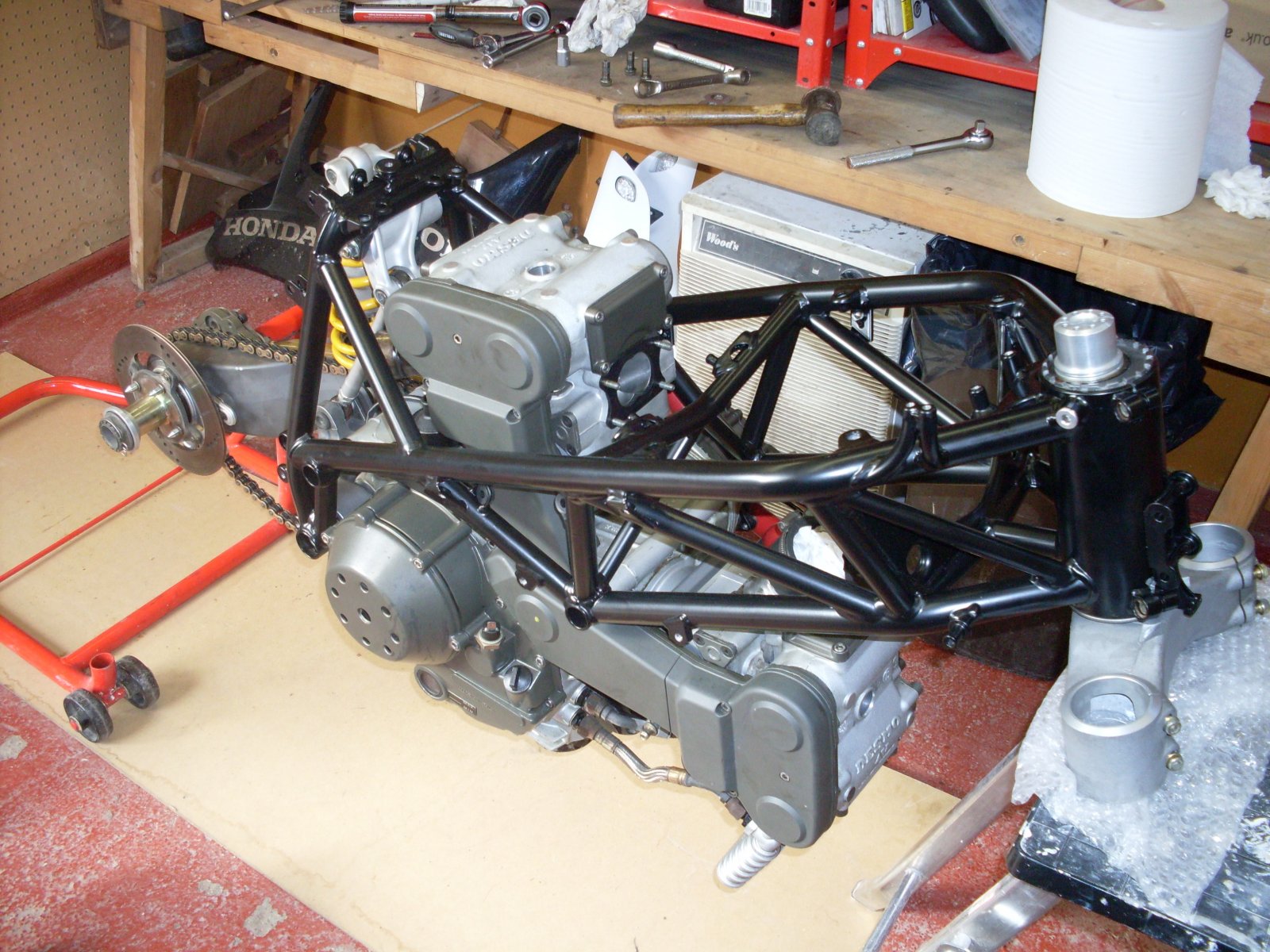

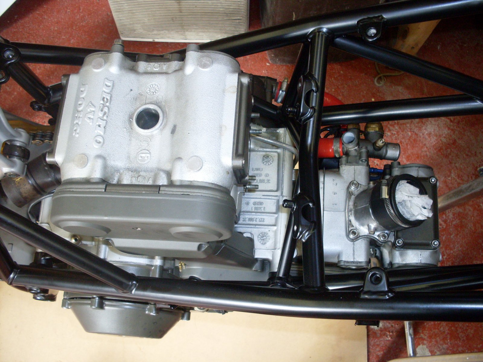

A few photos of my 748SPS being rebuilt might help as it might give you an idea how to proceed. As can be seen in one photo I used a short step ladder to hold up the front end. One photo shows the frame which was lowered over the engine and then everything lined accordingly and lifted up.
You seem to have the shock and height adjuster on the wrong sides . Only way you can do that is if the rocker is upside down.

I probably did at that point. I subsequently changed to an adjustable ride height adjuster and corrected the error.

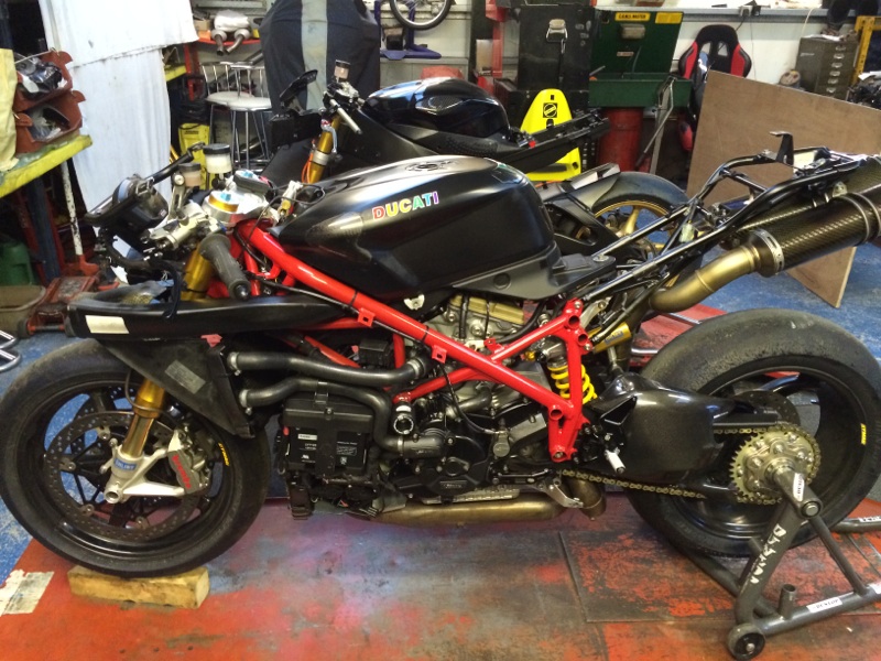

Still got it !-) Got a couple offers which weren't what I wanted, so kept it, just had frame painted, belts done etc. Just abt ready for Almeria in February,
