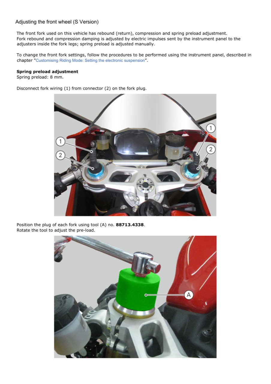

  17. The Ducati part number for the socket tool is 887134338 - I’m guessing it’s a dense Nylon socket rather than metal.

  18. Do you have the 1299S workshop manual @bootsam ?
    This is the page concerning fork preload - seems I’m right in guessing that the tool isn’t metal.
    If you don’t have the manual I will post a link.
