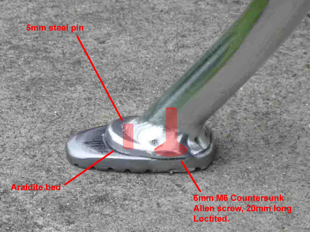

  3. I have done it.....See pics...............Want to know how?
  4. Its a steel plate (originally galvanized....door water bar) which I shaped and filed.
  5. Als method is very similar to my own where the stand was worn so I drilled and tapped a hole in the bottom and used alloy plate and filler rod to secure it to the base

  6. Thanks Al, I'll go that route looks nice and clean.... I'll dial in the suspension first as it seems I need a much thicker plate than you have.

  9. I did mine because the bottom of the stand was well ground away from use, but because I eventaully fitted 70 profile front tyre, it needed a bit more lift so I also made some extra plates from aluminium approx 2.5mm thick, which means I have had up to three additional ones sandwiched between the bottom steel plate and the stand..............then I use a longer C/S screw...........I was surprised how little is needed to bring the bike more upright.
