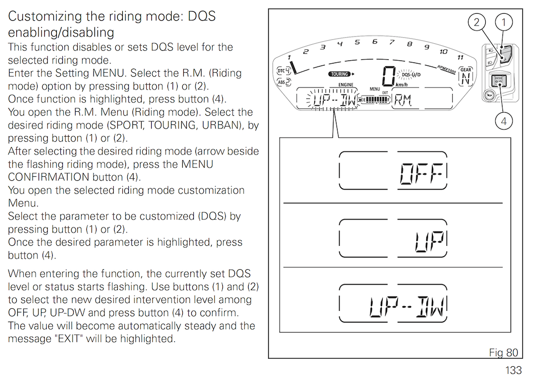

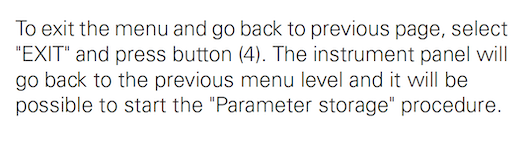

  2. I've heard of these Q/S problems too. I had a look my own bike to check how to turn the Q/S off. From the menu it wasn't obvious. I had too read the manual.
    From the menu you select RM (Riding Mode) and for from there. Here are the instructions.

  3. Many Thanks Derek,
    i have just been in the garage for half an hour but it is confusing, in fact i think i will still struggle with the detailed instruction you have very kindly sent to me, perhaps i will have one more go if all fails i will call into the dealership, i am sure one of the mechanics will do it a few minutes.
    I always ride in Sport mode & although i have enjoyed the QS i am going to have turned off, i can enjoy the bike without that..:)
    Thanks Again Derek :upyeah:
  4. Hi Derek..
    Update :- i think i managed to turn off the DQS.. display now just shows DQS [ not the "up & down" symbol as before]
