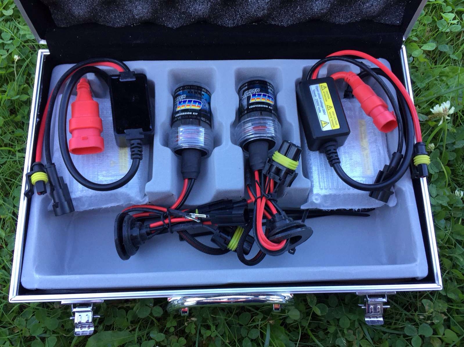

@Bob T do you know the manufacturer on my picture? Haven't bought these yet due quite high price. Are you using the same lights?
These are the ones i have mate, as recommended on here - Ducati 848/1098 07-09 Xenon HID Bulbs Slim Kit Lights | eBay
Got a set on mine both Hi & Lo Had them for ages, no problems. They are obviously a couple of generations old but still fire up amazingly quickly. A quick flash does nothing but if held on for a second or 2 the Hi beam fires up, so sort of limited flash. As the Lo stays lit when you fire up the main you don't lose any light, its not like a bulb goes out and another ignites, so no problem for me anyway. I got mine from DDM in the US when kits for motorcycles were comparatively rare, 55W rating. There are usually 2 ratings, 35W and 55W. Way more light, I have color temp of 6000K, on 55W this gives a blueish tint. If going 35W I'd drop to 5000K, I believe white with no blue and most light is approx 3800K. I would not go higher than 6000K as light output really starts to degrade above this and the light at really high temps takes on a purplish tinge. As bulb life is usually a function of starts with HID not hours, I also modded the lighting circuit so I can switch the lights on or off manually to stop the restrike that occurs when you start the engine
Looking at the picture I would say that it is made up of of standard ebay items. The labels on the bulbs are same as what I get from China. It will be expensive as someone has put it all in a nice box and as a middleman wants his slice of profit. That kit looks just right at £20. As I said in my last post I would only fit it to the dip. If you feel competent to dismantle the headlight then it is worth changing the projector on the dip side for a bi-xenon. Here is one for about £10 http://www.ebay.co.uk/itm/2-5-Auto-Car-Mini-HID-Bi-xenon-Projector-lens-Kit-HID-Headlight. I have two sitting here on my desk for my project, but may use one of them in the wife's BMW F800st. While the headlight is apart I will also remove the shield from the standard main beam projector that cuts off the light to the bottom, this is only there because Ducati saved money by using a dipped beam projector upside down. When I get the spare light on Monday, I will photograph and video all the steps to change the projector, and also to just fit a HID kit to the standard headlight and blog it. As I have bought a spare headlight I may even do a second one for the fun of it. I would also not bother with the 55 watt kit as the light output from the 35 watt will blow your mind as it is about 3 times brighter than standard 55 watt halogen bulbs.
