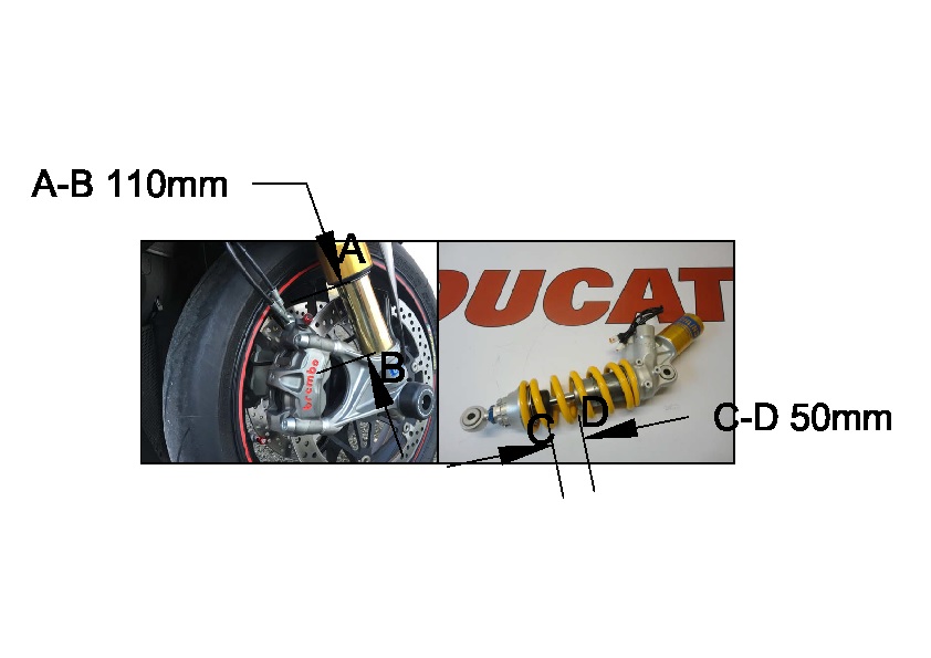

  1. Right Gents,
    Recently I changed the spring on my 1199s from a 90nm to an 80nm,
    So I thought I would try FC18 FR15, RC 21 RR18, I am still being bounced around a lot.
    now there are 31 FC, FR, RC & RR settings, I was under the impression the higher the number the softer it became, but here is what I have discovered, based on above settings the rear was only moving 25mm between C-D and the front was only moving 70mm between A-B.
    Well tonight while I was out I thought what the hell lets lower the compression and rebound settings, move the cable ties all the way back to point A on front fork and D on rear, so this is what I ended up with tonight when I got home
    FC14
    FR7 Front has traveled 100mm A-B
    RC16
    RR6
    Rear has traveled 35mm C-D.
    Am I missing something ? If the lower the number the stiffer it is supposed to be why am I getting more travel, I have tested my suspension along the same stretch of road so I can compare like for like.

  3. Are you getting more travel or is it not recovering and chunking down at the next bump? Maybe you have gine in opposite directions with comp/rebound?
  4. Deffo more travel, and I am not being bounced about so much it is coping with the bumps better, it has got me really perplexed.

  10. The numbers mean either:
    a. The number of clicks out from fully in - the bigger the number, the less the damping
    or
    b. The number of clicks in from fully out - the bigger the number, the greater the damping
    The greater the compression damping, the "harder" the suspension will feel.
    The greater the rebound damping, the "smoother" the suspension will feel - up until the point when there is too much rebound damping (at which point, you no longer have sprung suspension :D )
    The way to test which way round it all goes - set rebound in the middle somewhere and ride with compression set at the biggest number and then again with it set at the smallest number. If the suspension feels hard, with the compression damping set at "1" and soft with it set at "35", you can safely say that the lower the number, the greater the compression damping. However, if the suspension feels hard with compression damping set at "35", the reverse is true.
    Cool bears?
