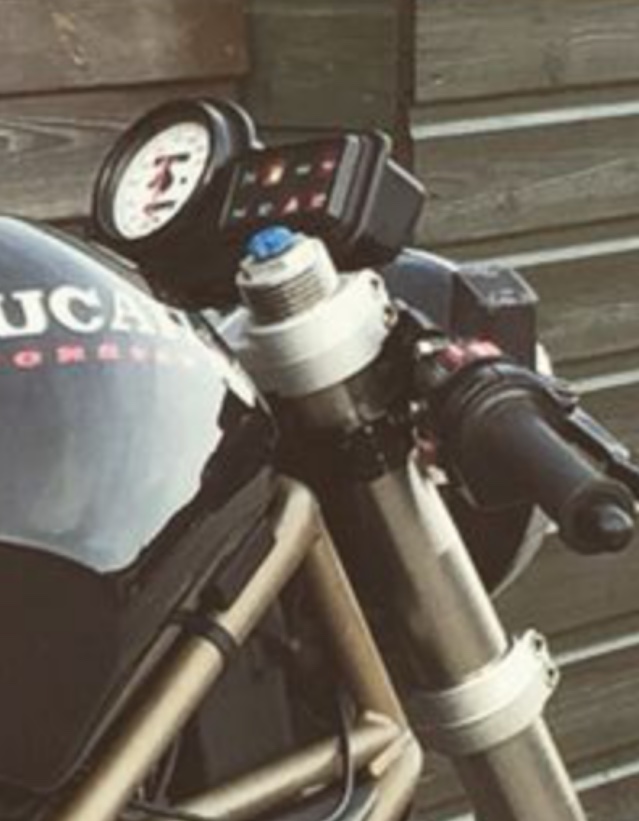

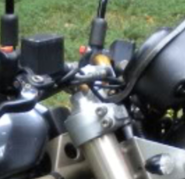

  8. as above, i'm sure you're aware there's always a compromise:- set up best for the track will never equal set up best for the (uneven, pothole-riddled) road. One easy thing you could try which could yield an instant improvement* if it suits you of course/if it hasn't been done already on your bike, is to drop the forks 20 to 30 mm through the yokes which has the effect of reducing the caster angle very slightly. It's of most benefit on say, M750/M900 or even early Multistrada and the bike will lean in/turn in more 'nimbly' as a result. Only downside is a very slight decrease in stability when travelling at trickling speed but do be aware of this.
    *as pointed out, not a direct answer to O.P.'s question.
    like this:-
    rather than this:-
