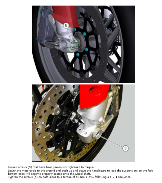

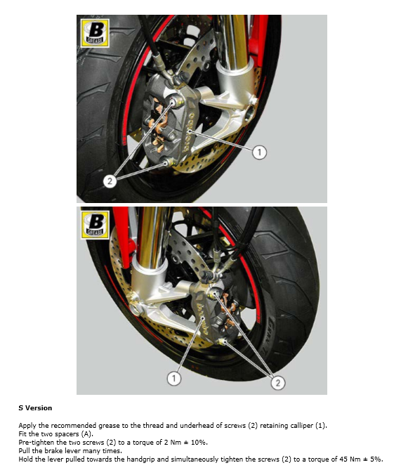

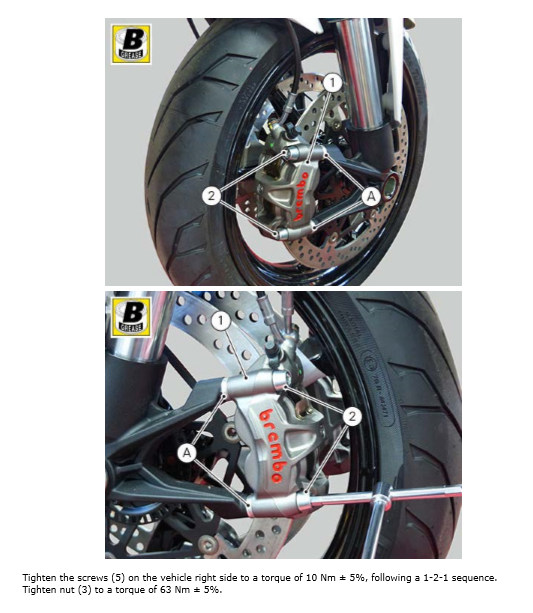

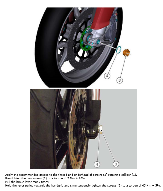

What have you set on the fork preload? 1/2 turn per 10KG? I would start by checking your tyre pressure and also that the axle is correctly seated in the forks.... - see last photos If all that is OK - makes no difference - try running in sport mode and see if it helps - if it does - just increase the damping on the forks through the menu..
I have had the wheels out to powder coat them but this was ages ago, I have double checked the fitting back in as well, so confident that’s fine. Running Bridgestone T30 at 36 psi front and rear, and as for adjusting the menu I can only do the mode, anything else is beyond me even reading the manual, I need an expert menu person to show me because for 18 months it has beat me.

Isn’t it 15kg? (While since I did mine!) And why would the alignment be a problem with anything? If it’s out it would be noticeable at far lower speeds and would be binding something
Can we have that in English...?? My suggestion was just to check it was all in line before playing with anything else.. It may be 15KG a half turn... that's why I added the ?? - also to find out how much preload he had.. I used to use nearly all my travel too - but never had any issues with the front at standard touring settings... I am heavy / was heavier and no issue... I ended up at just under max preload (8 turns I think)
