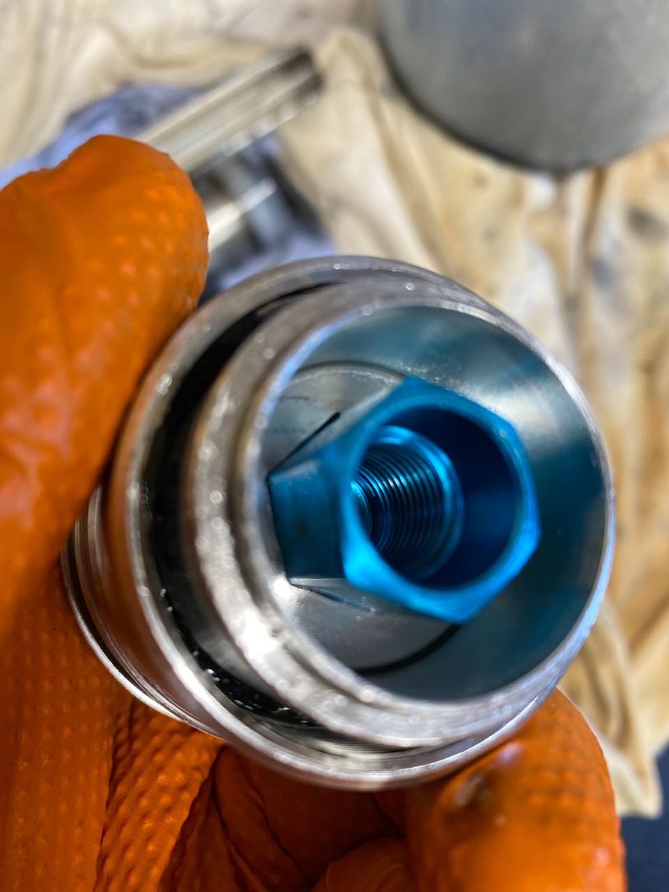

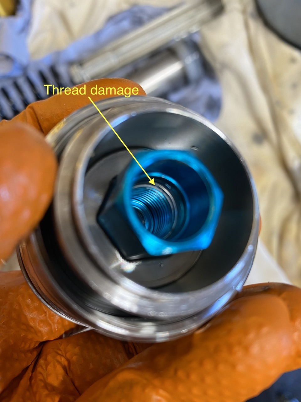

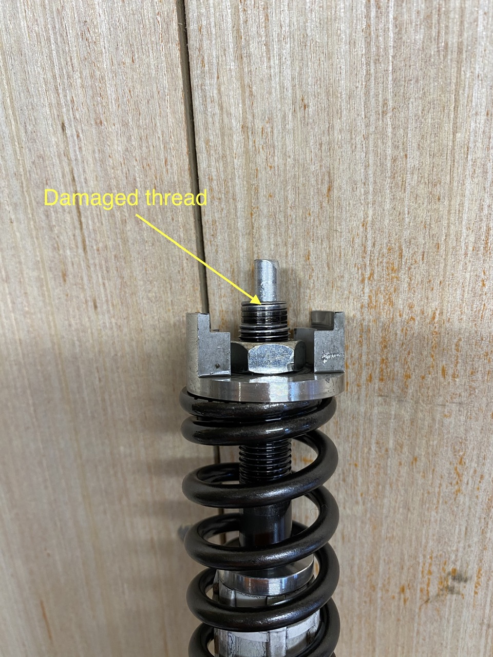

  6. This may not be the issue you have, but just in case.
    I used to own a Monster 1100S and it always had a noise, similar to that which you describe, coming from the front end.
    I stripped the forks down, didn’t know when they’d last been serviced, and discovered the preload adjuster nut had not been fully threaded onto its rod (presumably by someone else when reassembling who’d been in there previously). Bother the nut and the rod had been stripped.
    I cleaned the threads up,
    reassembled - properly - and all was good thereafter.
