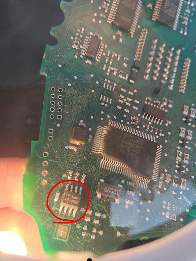

  5. Took apart the new dash. Is this the eeprom in question? 24C16WP

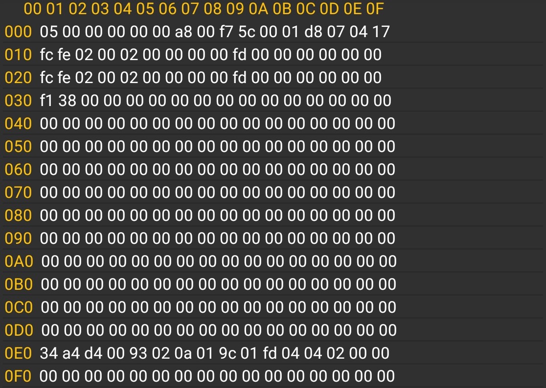

  6. Thank you Chris for your help I successfully copied my old eeprom and transferred it to the new dash and it works!
    Immo code was easy to recognise but out of curiosity I tried to find km reading but I don't understand how to calculate that reading from that hex code. Can you explain how that can be calculated, and can I create that number for different km reading if I need to?

    It is stored at line 010 00 01 and 020 00 01. The hex is FC FE.
    The PDF I attached shows how the odometer reading is calculated from the hex.
    You may find the info on a forum called Digital Kaos.
    In order for the dash to store the odometer value you also need to calculate a CheckSum otherwise the odometer will revert to the originally stored data. I do not know how to calculate the checksum. The checksum in your screenshot is FD.

  8. I have been playing with the odometer calculation from the hex value.
    Is your current odometer - 6527.8 km?
  9. That code is from my donor dash and it has 19634km on it

  11. Got it. Your odometer reading is held as FE FC 02
    Reorder this to 02 FE FC and convert to decimal
    That gives 196348 (divide by 10) = 19634.8km
    To work from the dash odometer reading to hex you must include the partial kilometre ie the .8
    Have no idea on how to calculate the checksum
