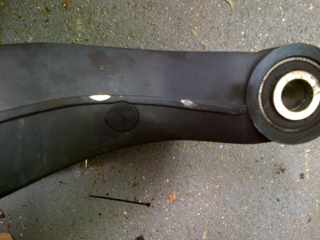

    I have an 04 999s on which i am going to replace the grey swing arm with th 05 black fabricated item .
    It is a straight swap but ................. on the grey arm the speedo sensor cable and rear brake hose are fixed to the underside of the swinging arm . The black item appears to have the bolt holes on the top .
    Is this where the cable and hose fit or am i misguided ?
    Advice /pictures appreciated ..

  4. Having just taken a black one off, the cable and hose are fixed above with P clips.

  9. Well thats the swing arm fitted , there doesnt appear to be any issues particularly with exhaust clearances ect .in fact the exhaust had been rubbing on the previous swing arm .
    Thanks to everyone for their help , Waggy tree for the hugger and Ian for the drawings for the chain tensioner blocks, i got these made in stainless , Ian if you want my spare set let me know .
    I have test ridden and all clearances apper to be ok .
