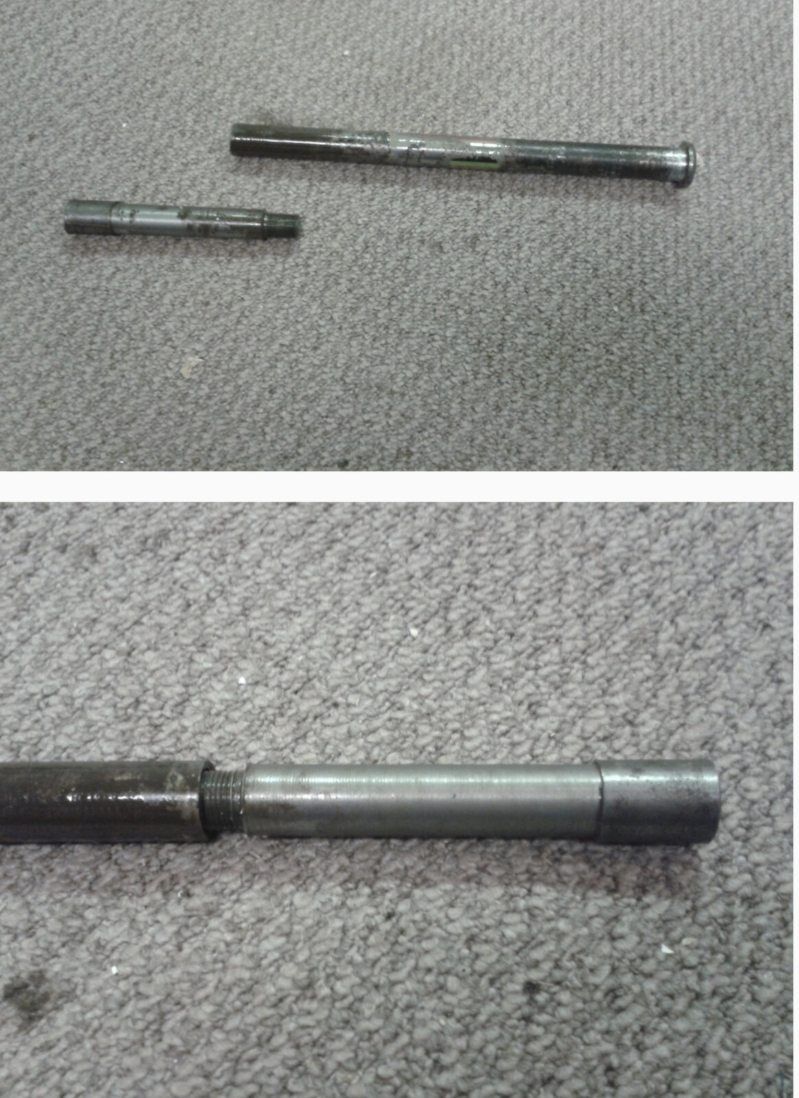

  1. I’m hoping to remove the swing arm bolt on my 916 so reading the horror stories I’ve been blasting it with plus gas on a daily basis for a few weeks now. I’ve loosened the bolt and I can drive the shaft back and fourth now with ease so hopefully it’s let go. Anyway would any of you gents have one of these for sale. I took the pic from another thread on here. Or could anyone here make one up for me. IMG_5788.jpeg
  2. If the pívot is moving freely, you won’t need a drift. Just use a 1/2” square drive to tap it out
  3. I just removed mine. Just a aluminium bar without the thread worked well. Just turned the end down so it will fit inside the thread and has a shoulder the bear on the spindle. If you need one, I can make it for you.

  7. Thanks guys I used a 13mm deep socket on a long extension bar and tapped it out. It came out very easy thankfully. I did put my trolly jack under the engine as a precaution but it didn’t really need it. Next question is torque is it 70/75Nm
  8. 73Nm greased up.
