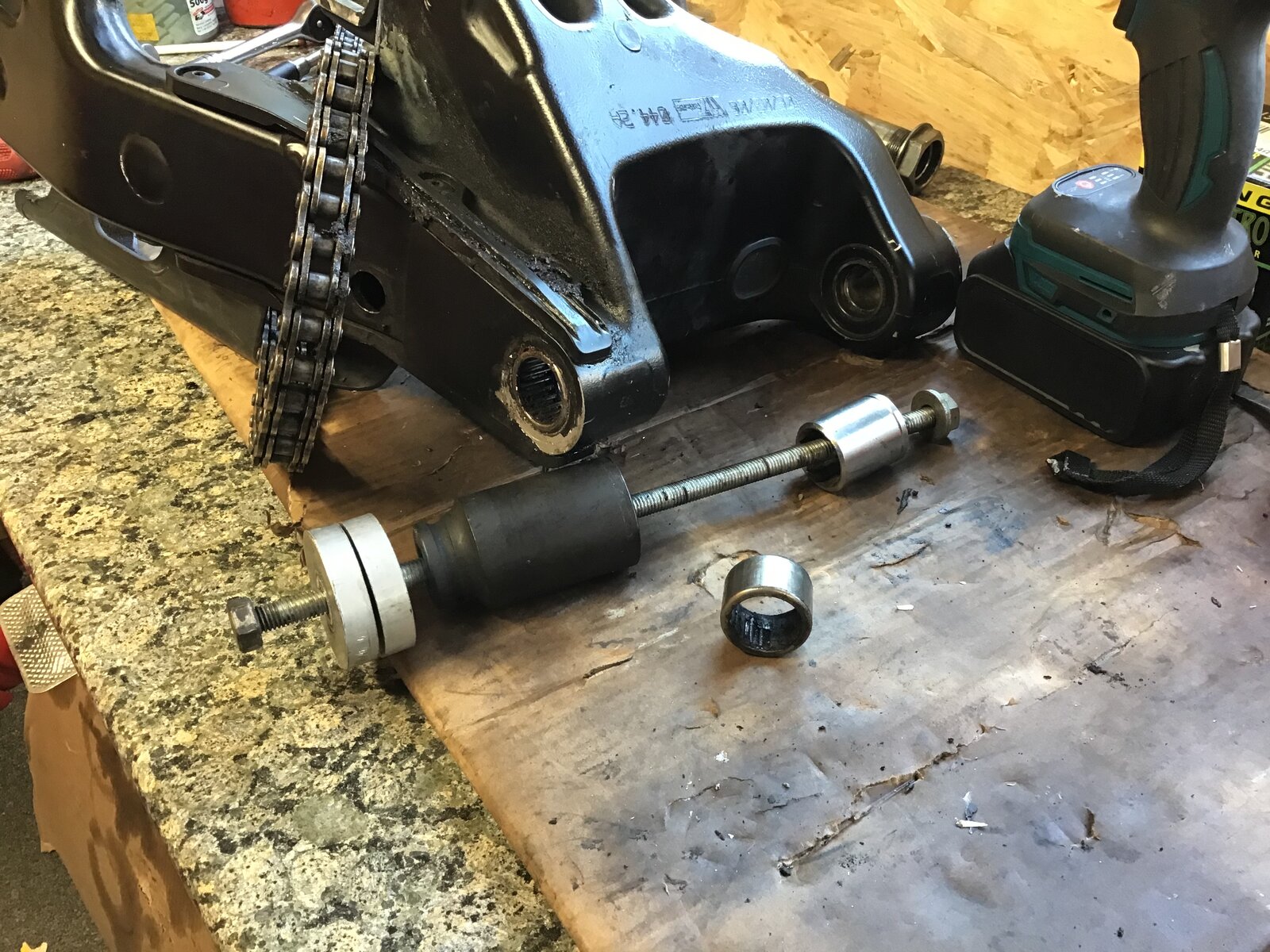

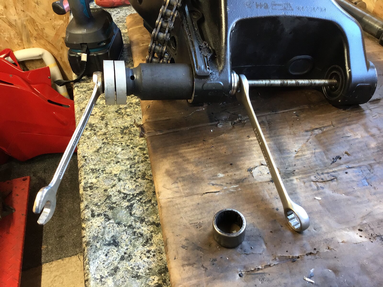

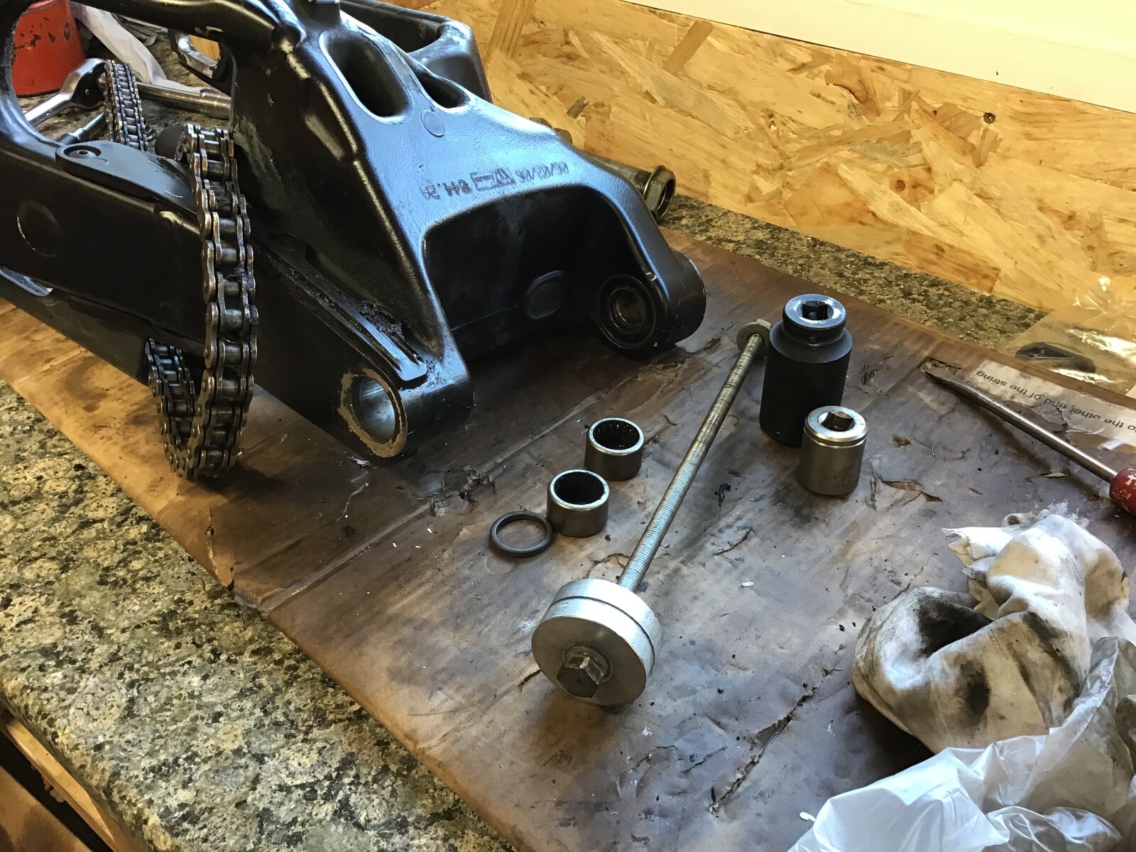

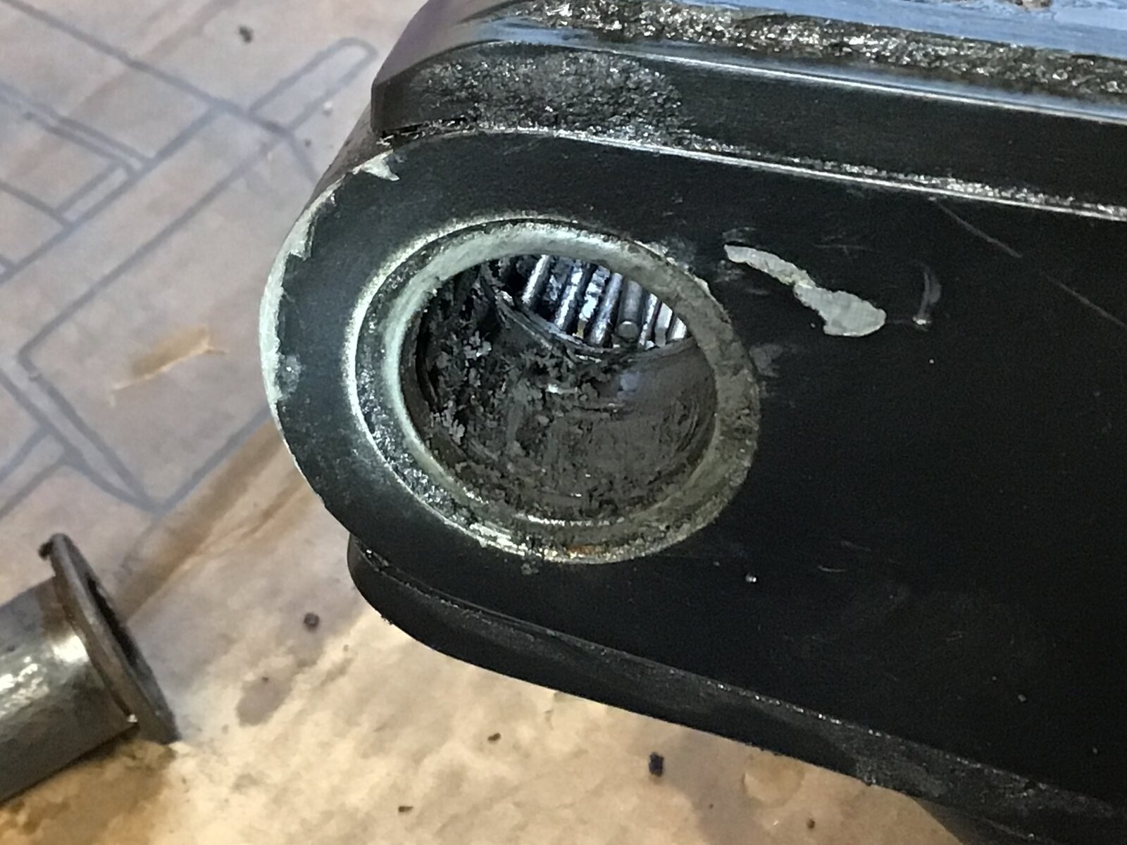

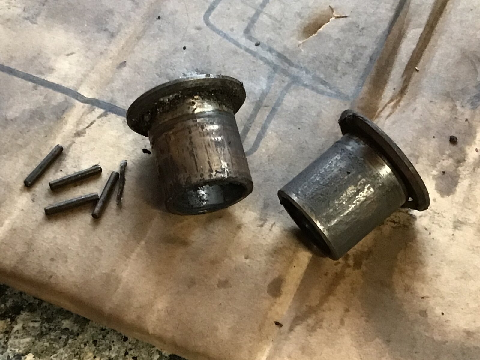

  1. I removed the engine of my 999 recently for repairs. This gave me the opportunity to inspect the swingarm bearings. The LHS needle rollers and bushes were in poor shape.
    This may have been covered before but in the interests of helping others i thought i’d post how i pulled the bearings from the swingarm using threaded rod and sockets. I hope the photos speak for themselves.
    Chris
    D65F0397-774D-4DE9-8F8B-D948406E72AB.jpeg D0859A36-07D9-463D-BF2C-F98373277674.jpeg 3C199302-2DCB-4436-8AF9-74B91AA884D7.jpeg E18E4BD5-B076-4BBE-8C05-DDE4B6F96E24.jpeg D22DDF25-5BBB-46AF-B92F-A0BF4AC13BC6.jpeg
