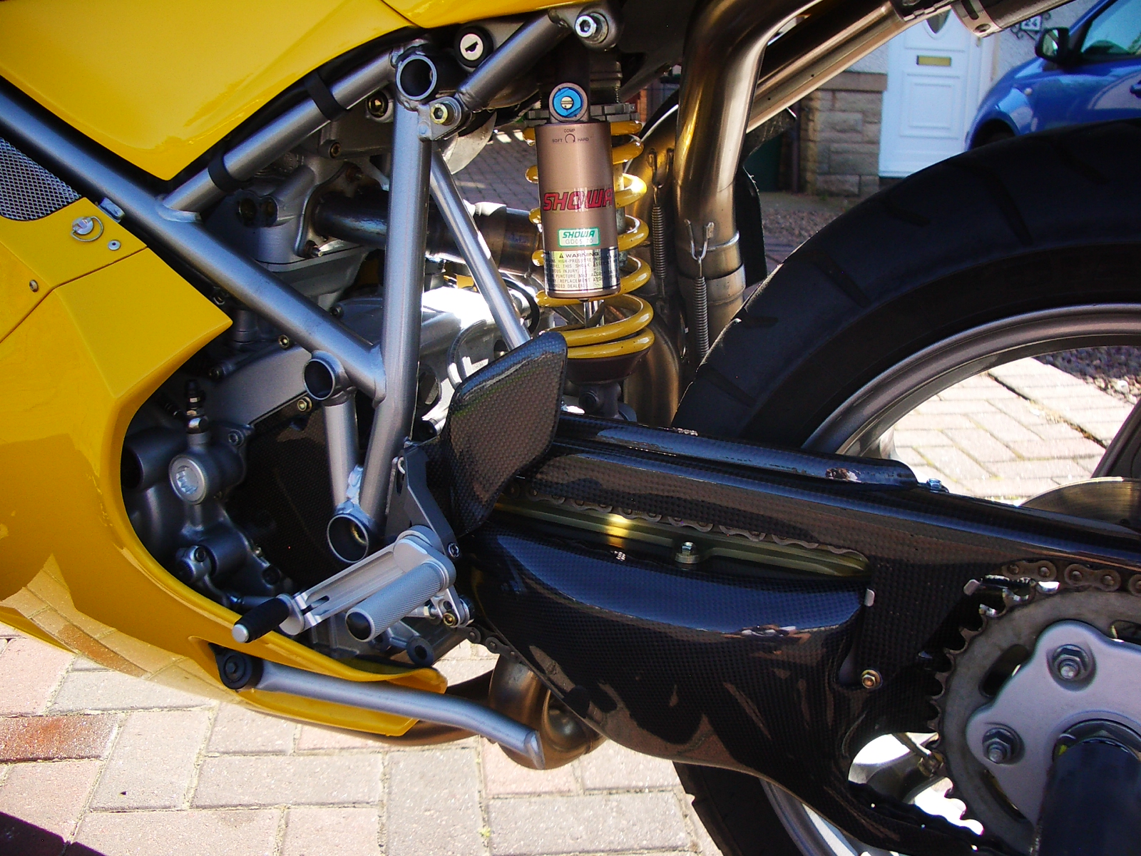

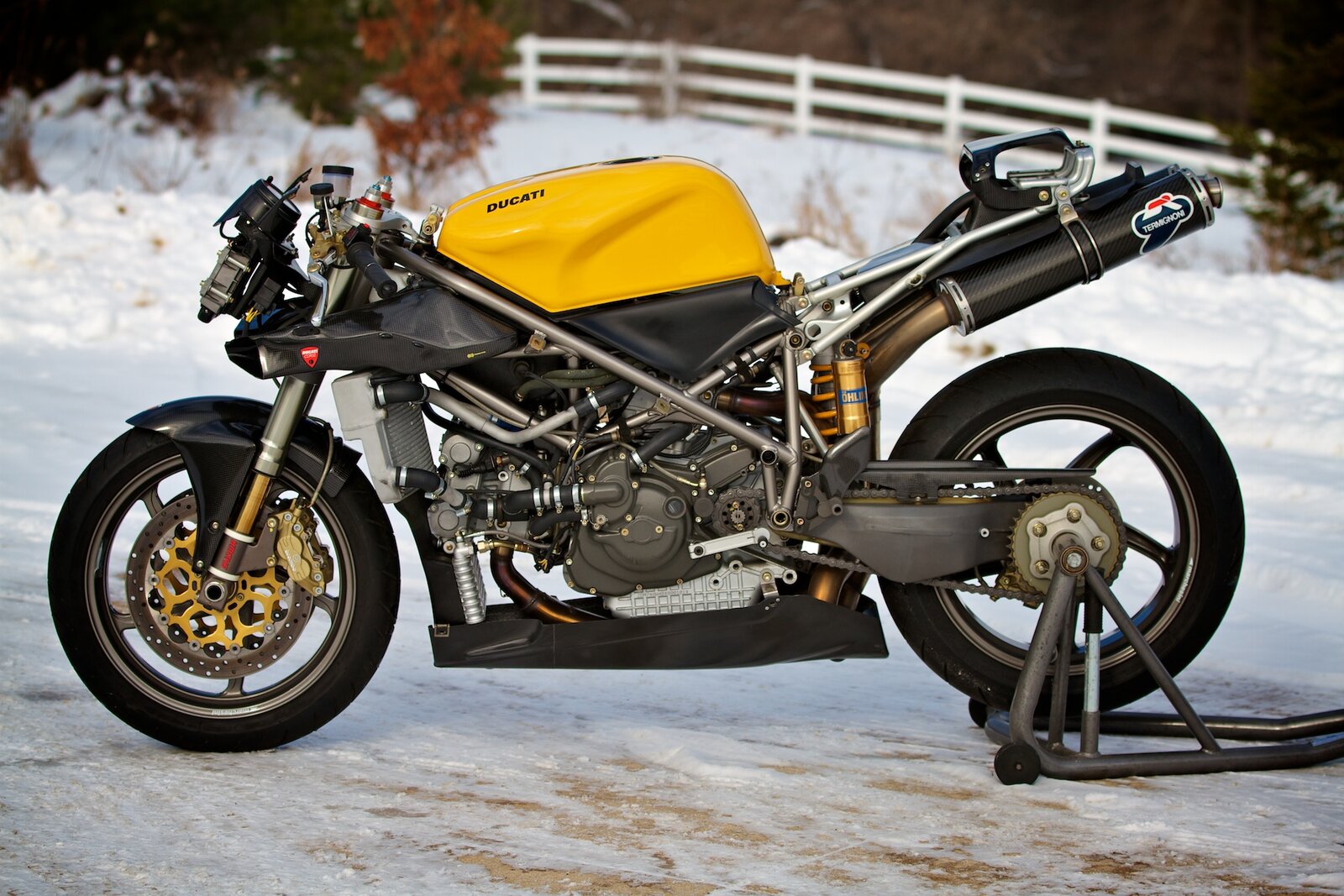

  5. A quick search through my picture database shows very clear pictures of the 748RS swingarms. The chain gaurds are the same. See below:
    @Denzil the Ducati, is this what is shown on your 748R fiche?
    I'm not overly concerned with this, curiosity has got me and I can't figure out why Forza are selling theirs for €580, other than it's NOS..
  6. The picture of the chain guard on the 748R is not the standard one. Certainly not the same as the one on my 748R. Next time I fire up my desktop, I’ll try and dig out the parts catalogues I have found over the tears. Andy
  7. That's because they're RS'.. ;-)
    Should look like mine on my S..
    #7 Bullitt, Feb 11, 2021
  8. Where’s a face palm when you need one :joy: Andy
  9. Bullitt, your 2 photos show the RS style chain guard which is listed as being fitted to the MY98 and MY99 R models as well as many of the RS bikes. The 02 748R has the same chain guard fitted to most of the road bikes in the 748/916/99/998 series as shown in the photo of the S. One difference for the RS style part appears to be an additional threaded boss and screw inboard of the sprocket to accept the rear chain guard mounting screw, this is not fitted on the standard swinging arm/chain guard as shown in the S photo.
