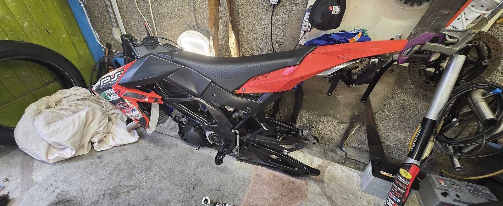

  1. Not hot on the heels of my 400/4 build and no where near as in depth - as ive opened a couple of other threads re acquiring an SXV550 (getting a van and the v5 update) - imo the ultimate supermoto....still is and nothing else touches if for sheer mentalness....

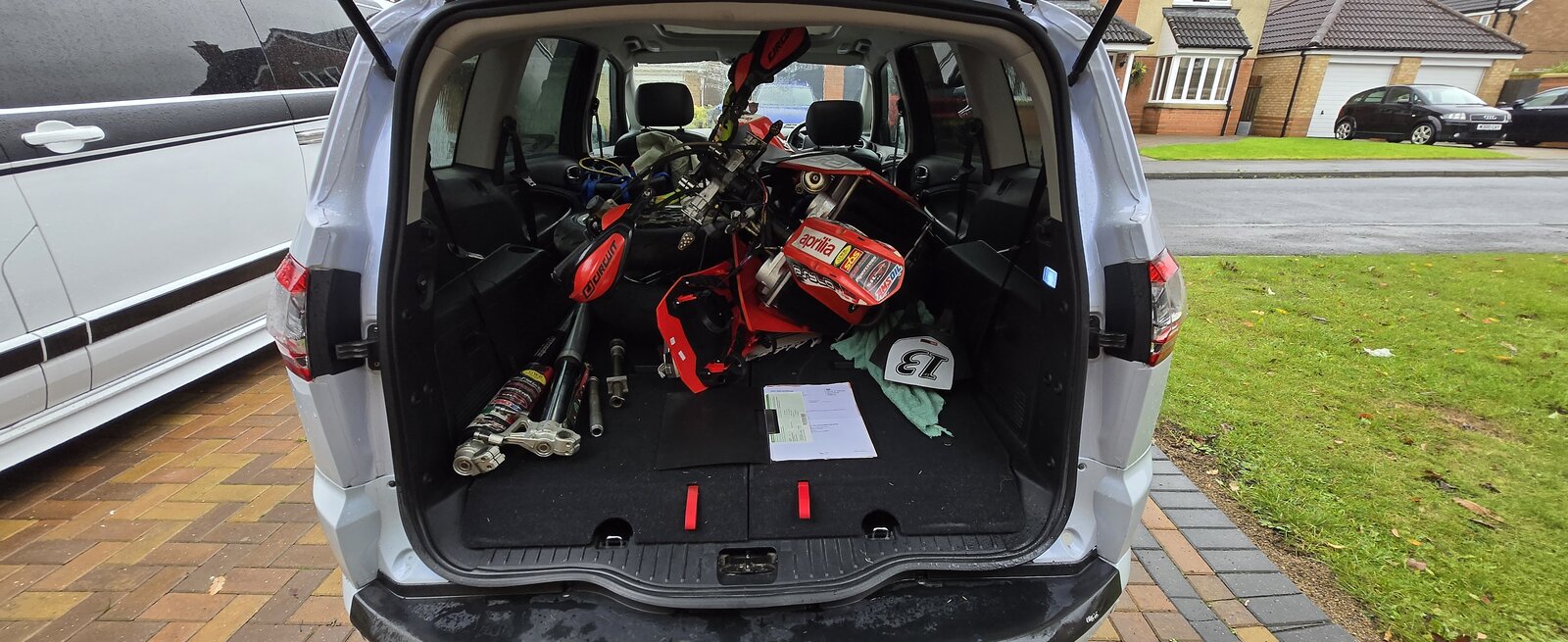

    Its mine now....work has started in earnest...ive not ridden it yet - i brought it back with no wheels on and no forks...seemed pointless just to build it up and then take it apart again..! so without further a-do....to the pics...
    Arrived like this...and then turned into this...

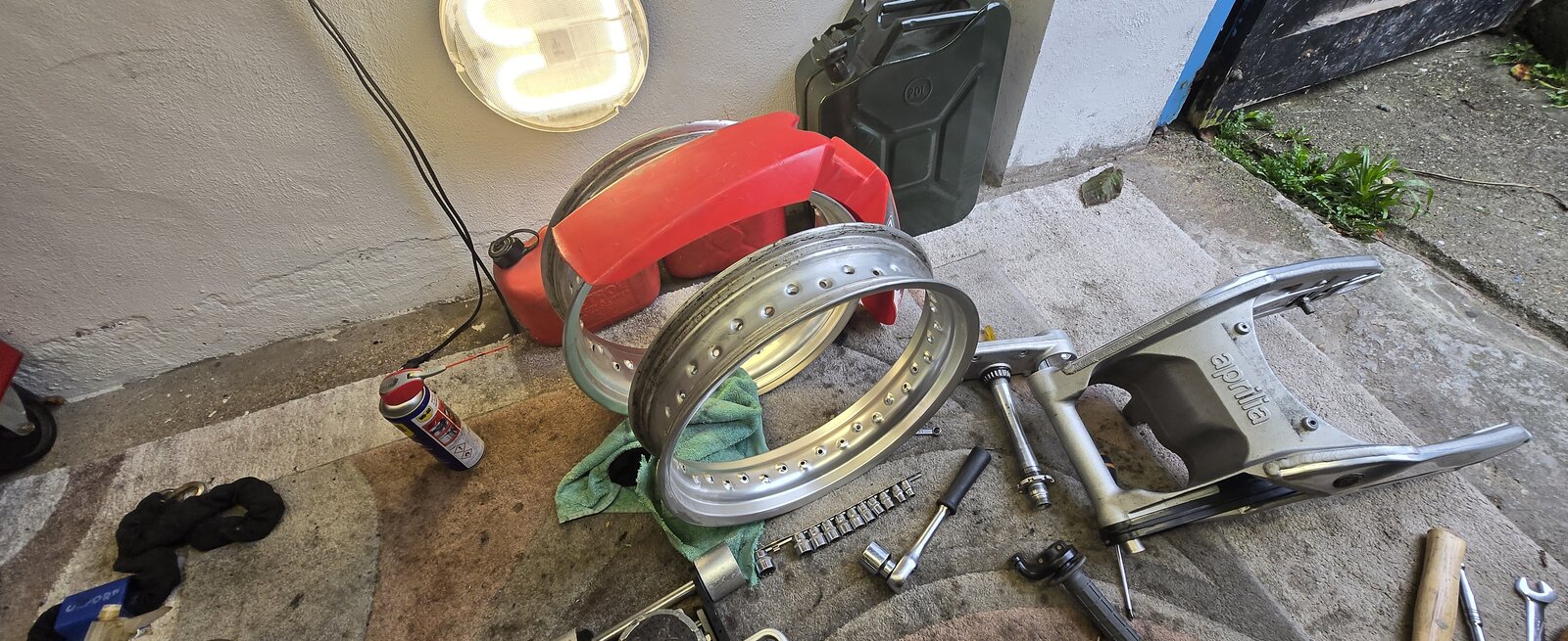

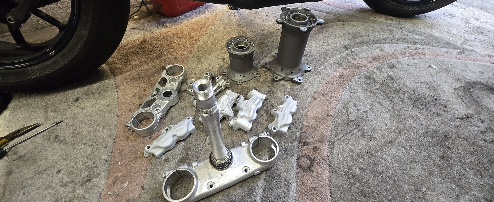

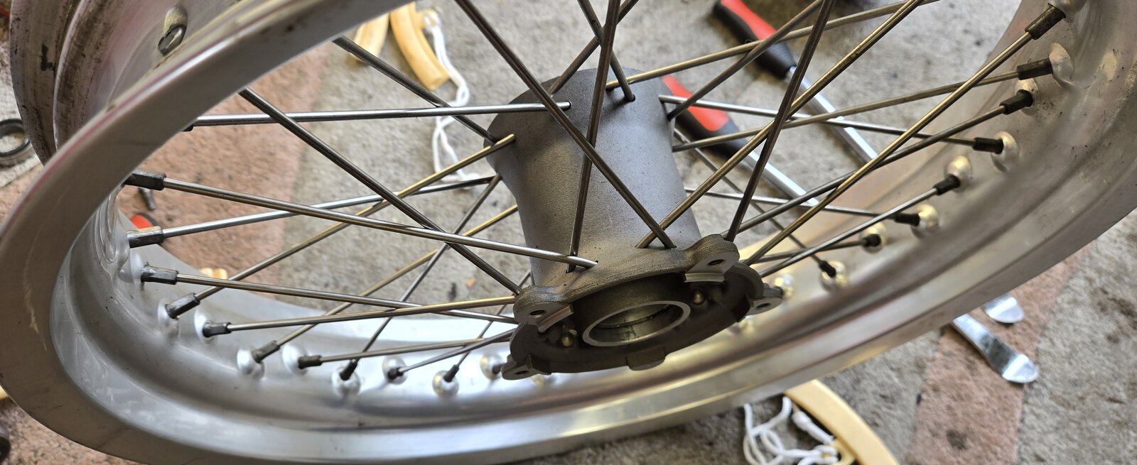

    Wheels torn down for coating....powder for the rims and cerakote for the hubs...

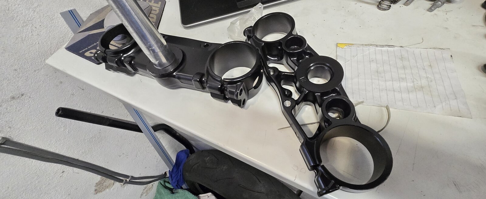

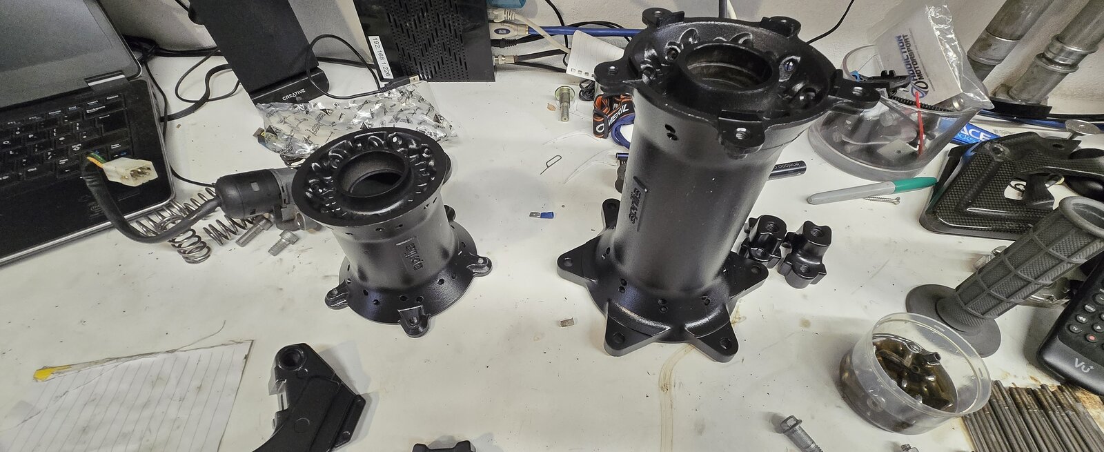

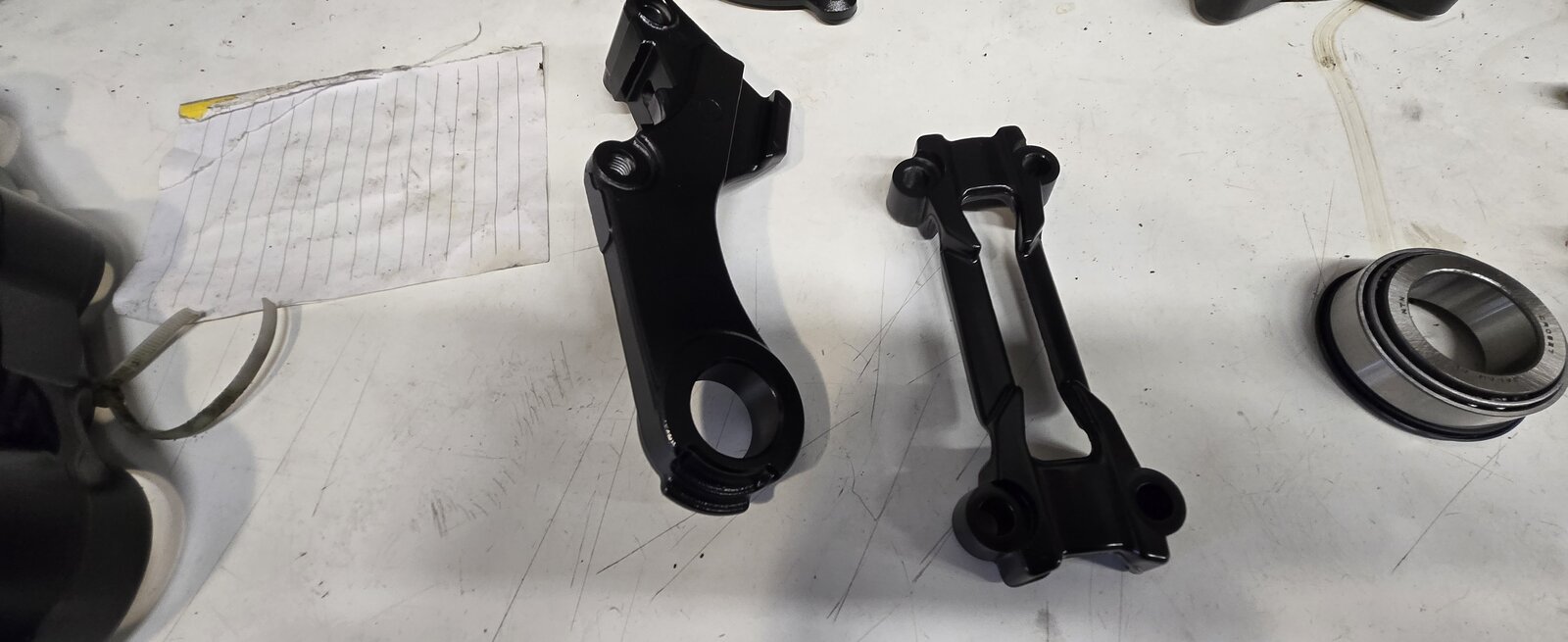

    Collected the cerakoted stuff today...started off like this...
    Those are my HPK's in there from the z1000 - the shitty nickel plating came off so got those stripped and blacked out as well...
    Came back like this...

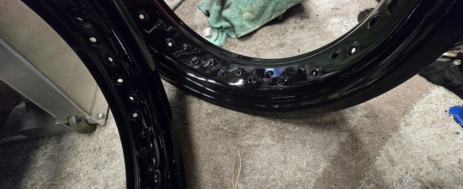

    • Useful Useful x 2

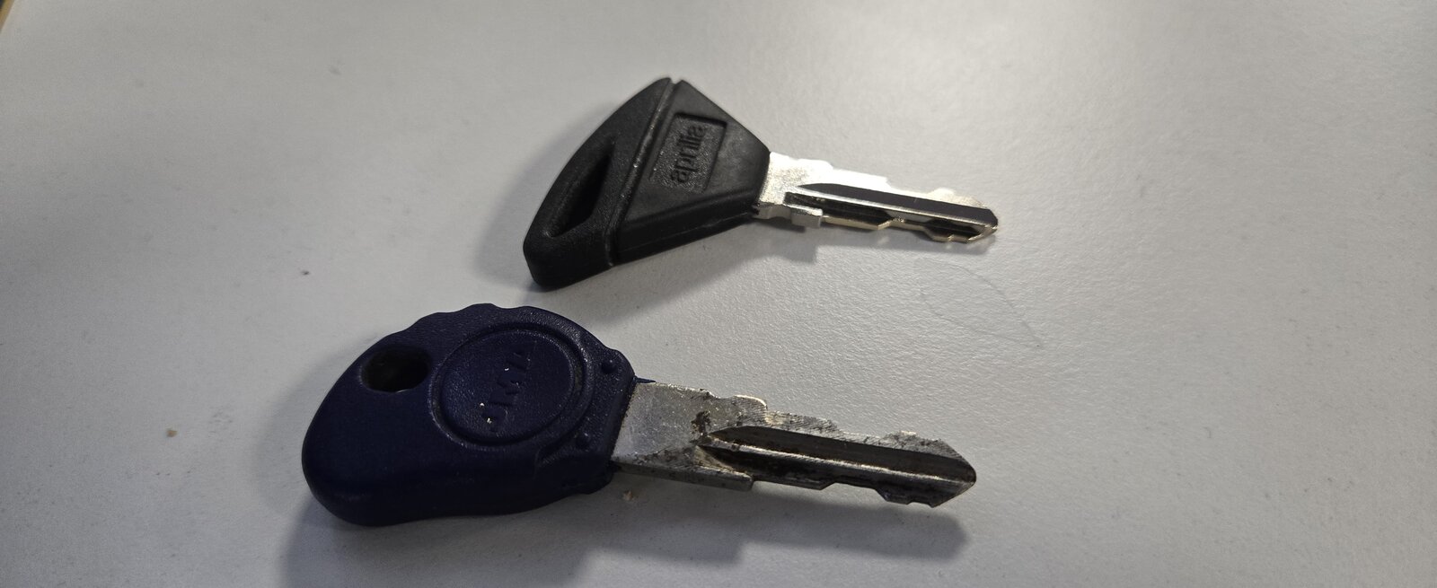

  2. As ive only got the one key, just received an oem key today - no chip inside so dropped it up the key cutters....6 quid and im good!

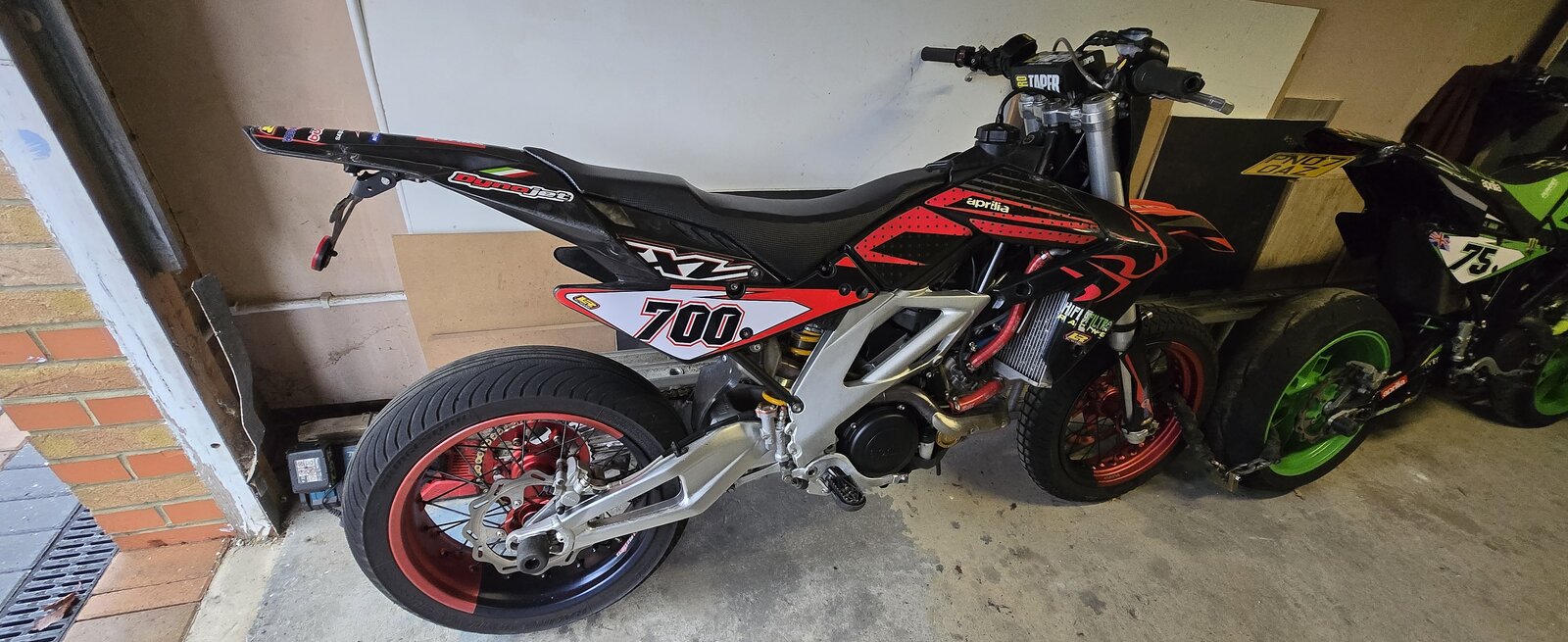

  7. Well - ironically the lad i got mine from had just gotten hold of another one....it needed a full engine refresh which he had just done....alpina wheels - silmoto full system also...i dont think hes even put it up for sale....it went straight in for racing - previous owner did some hill climbing on it....looked beautiful....i think he was in the middle of applying for a v5 for it as, as i say it was used for racing from the get go....think ive got a pic of it...
  8. Yep - this is it...

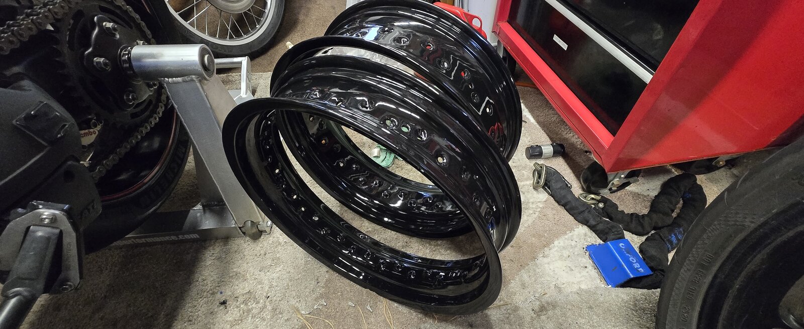

  17. Rims are ready, so collecting those tomorrow if i can coax the other half into doing it for me - if i get a barrage of abuse ill be going out at lunch time.... :)
  18. Rims collected.
