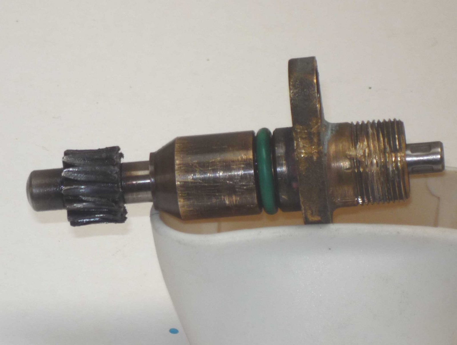

    There is no gasket, but there is an oilseal / o-ring around the boss........when you get it out, inspect the pinion gear for damage......
    If it looks like this you have a problem.

  3. Thanks friend. I desired this gentle advice before I got to further grips. wasn't sure of the precise manner of its engagement with worm drive and so thought 'patience..'
    Like the idea of the leather and molegrips. I'll give it a go before chisel, which stands by, ready and sharp.
    Yes, I read the post with your input concerning same worn pinion or worm drive. It's a good opportunity to take look, an important detail to cover really on a takeover. We would do it as a matter of course on Nortons.

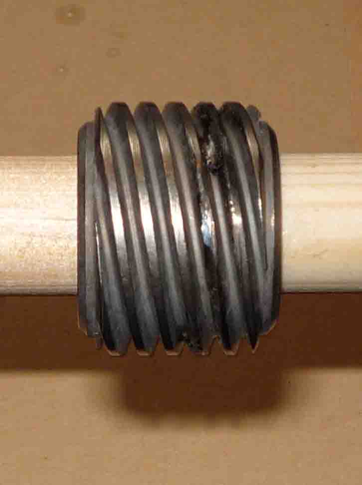

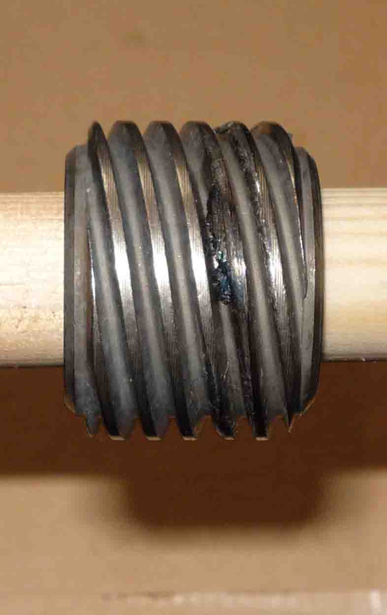

    ......then the worm drive on the cam will probably look like this.........and that's when the fun starts.....
    When you get the boss and pinion out, get a mirror and a very small torch........then look down the hole.......you can just see the section of worm drive that matters.......whip your plugs out so you can turn the engine easily.
    If AOK, when reassembling, as you put the boss and pinion back in, you may find it doesn't want to go right down........turn the pinion until it drops in nicely.

  5. As Al says, do it that way. I have a worn drive which has corresponding worn teeth on the screw in the head. I have a new drive but will need to get the head out at a later date when I have the other part as if I put it in then it'll chew up the new one.
    Having taken a couple out, they can be a pig to remove.

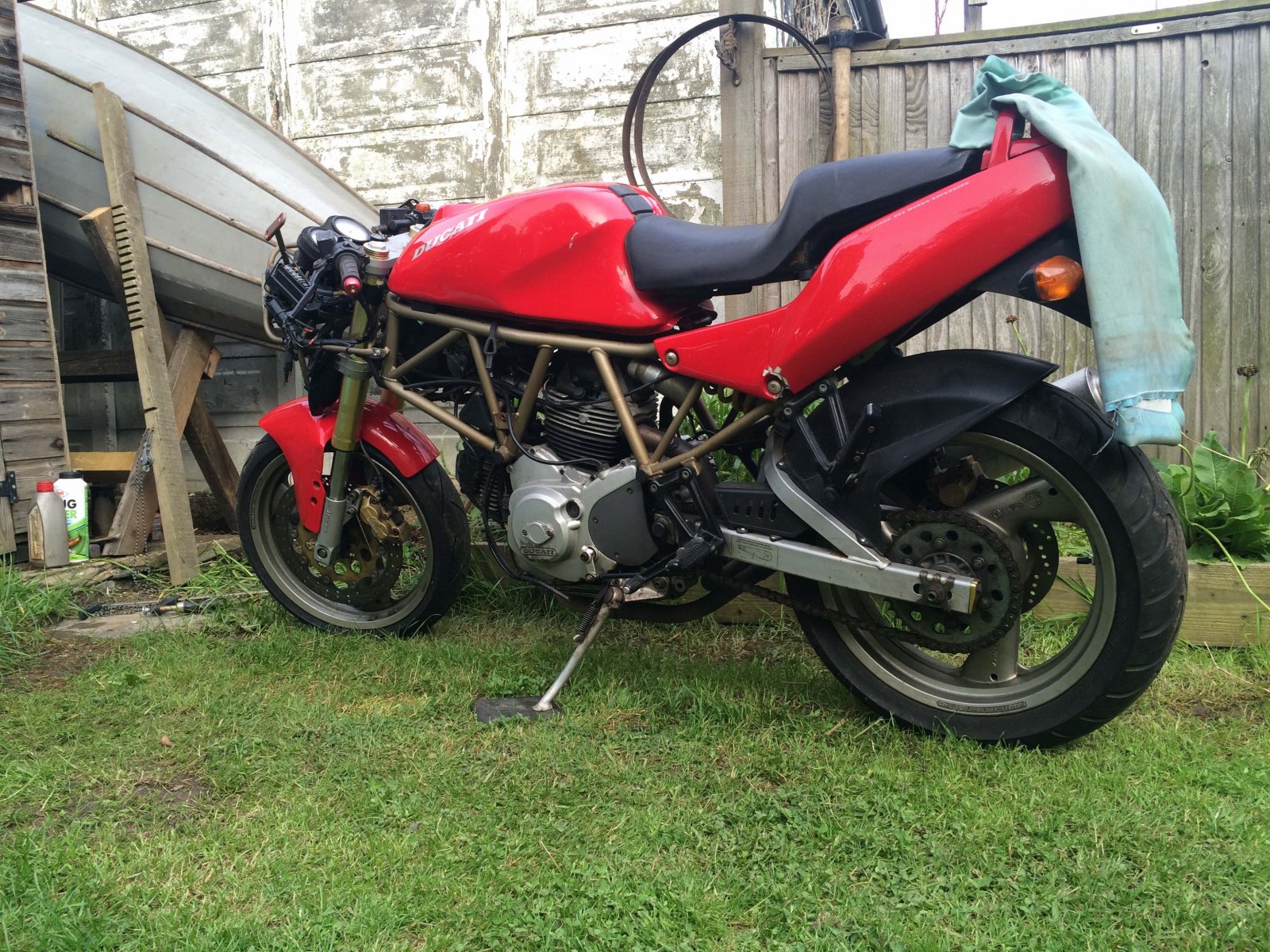

    Enclosing a picture of the bike, as formerly promised. fairings are removed for servicing, almost completely done.
