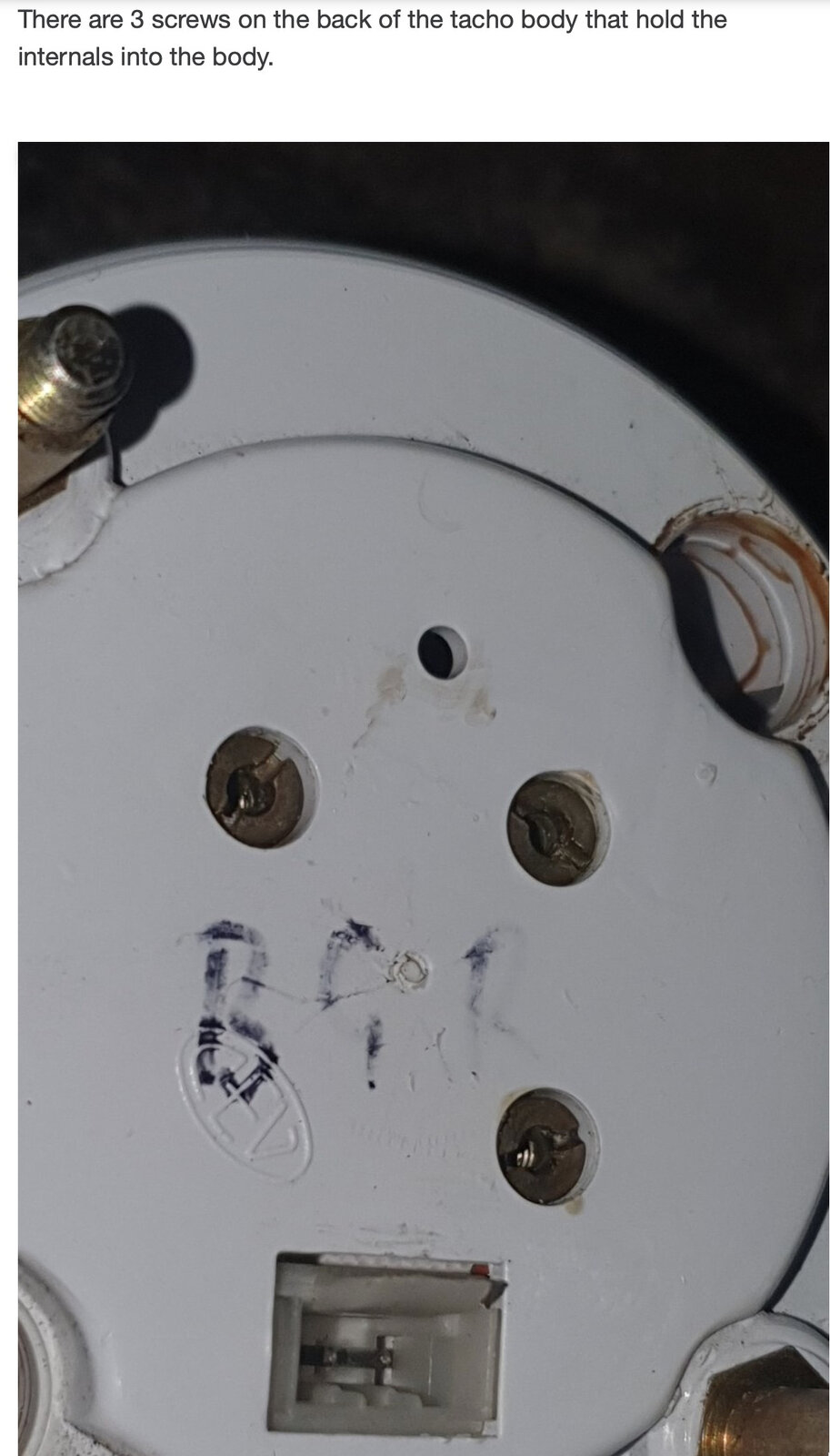

  2. Electronic tachometers give erratic readings when the base voltage is low, usually caused by a loose or corroded battery connection — so check this first.
    There are three brass screws that make an electrical connection on the back of the tach. These loosen up and cause erratic readings. Sometimes if you push on the tach lens, it'll momentarily go back to functioning normally. If so, tighten them up (not too tight or you'll damage the unit).
