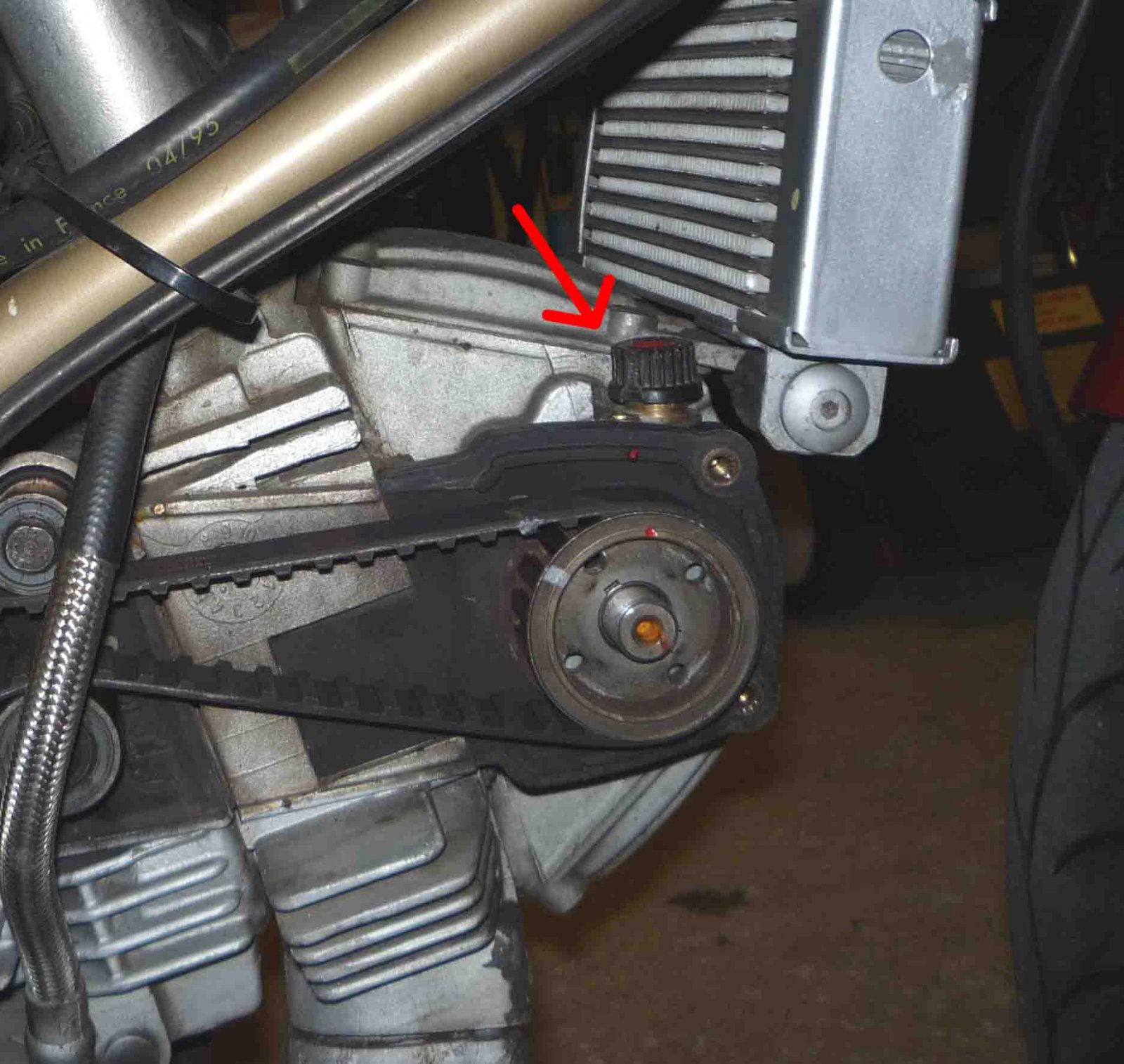

  6. See the pic below...........I assume you are working on the arrowed item........ignore the black knurled cap......I used that to stop oil from coming out after I had removed the faulty drive pinion.
    If you have removed the allen bolt, you could try tapping the lug of the boss in a rotary direction to loosen it......use something like a wooden dowel because the boss is brass (I have a spare boss if you bugger it up, though).
    If you can budge it, try twisting it around as you remove it, because you have to disengage the pinion teeth from the worm drive as you pull upwards.

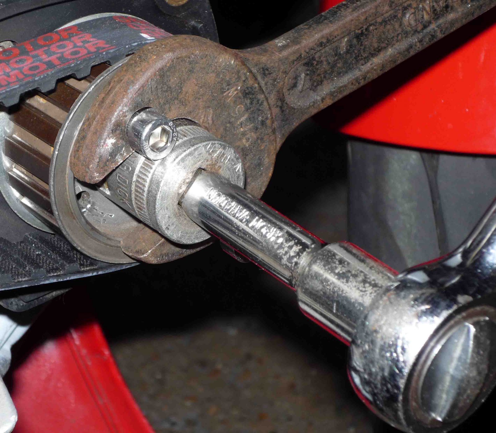

  8. The one you can't see in my photo above because I have already removed it..........
    When you have the belt cover off it will be apparent.........but you will need to buy or make a socket to be able to turn it, plus something to stop the cam from turning while you do it.
    See pic below....

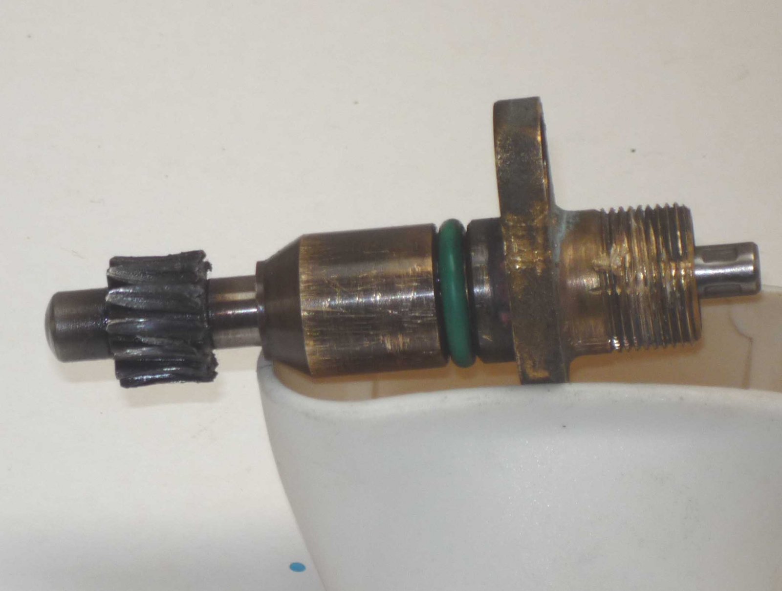

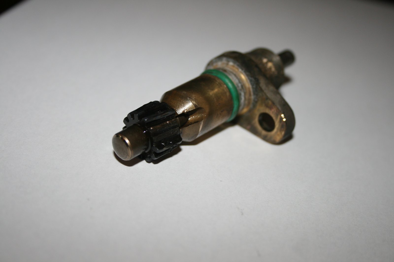

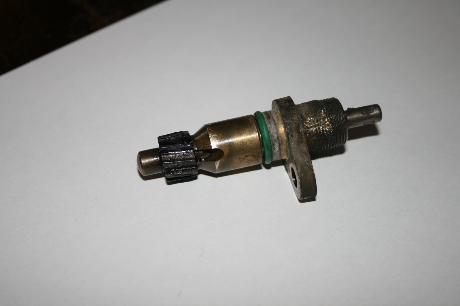

  11. Hi,
    Quite pround of myself. (not being a mechanic). Got the brass boss out to find that 2 teeth are missing. I assume that they have ended up in the oil filter? The cog does not turn. That can't be correct can it?
  12. Looking at my boss compared to yours, I don't have a gap between the cog and the main housing
  13. If mine was pushed right into the boss there wouldn't be a gap.........so the two are identical.
    I suggest you now enlist the help of a friend.

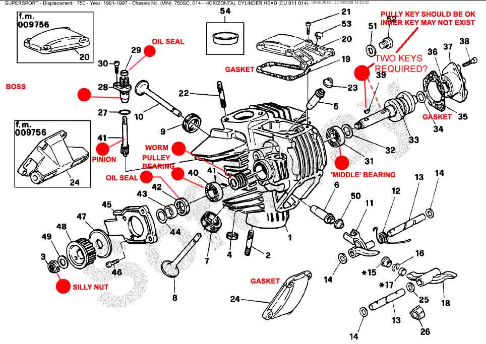

    The image below is for a 1996 - 1997 750SS (I suspect yours is the same)...........It should give you a clue as to how it works etc.

    If you have to replace the worm gear, what you will need at least, is the following:
    Silly nut socket (make one instead of buying it??)
    Tool to hold cam pulley still while you are loosening or tightening the silly nut.
    Tacho drive gear kit (both Items 41)
    Oil seal (Item 42)
    Bearing (Item 40…….I doubt if you can remove this without damage)
    Gaskets (Item 19 x 2)
    Gasket (Item 35……….you will need to remove the cam to get the bearing 40 out)
    Silly nut (Item 3)
