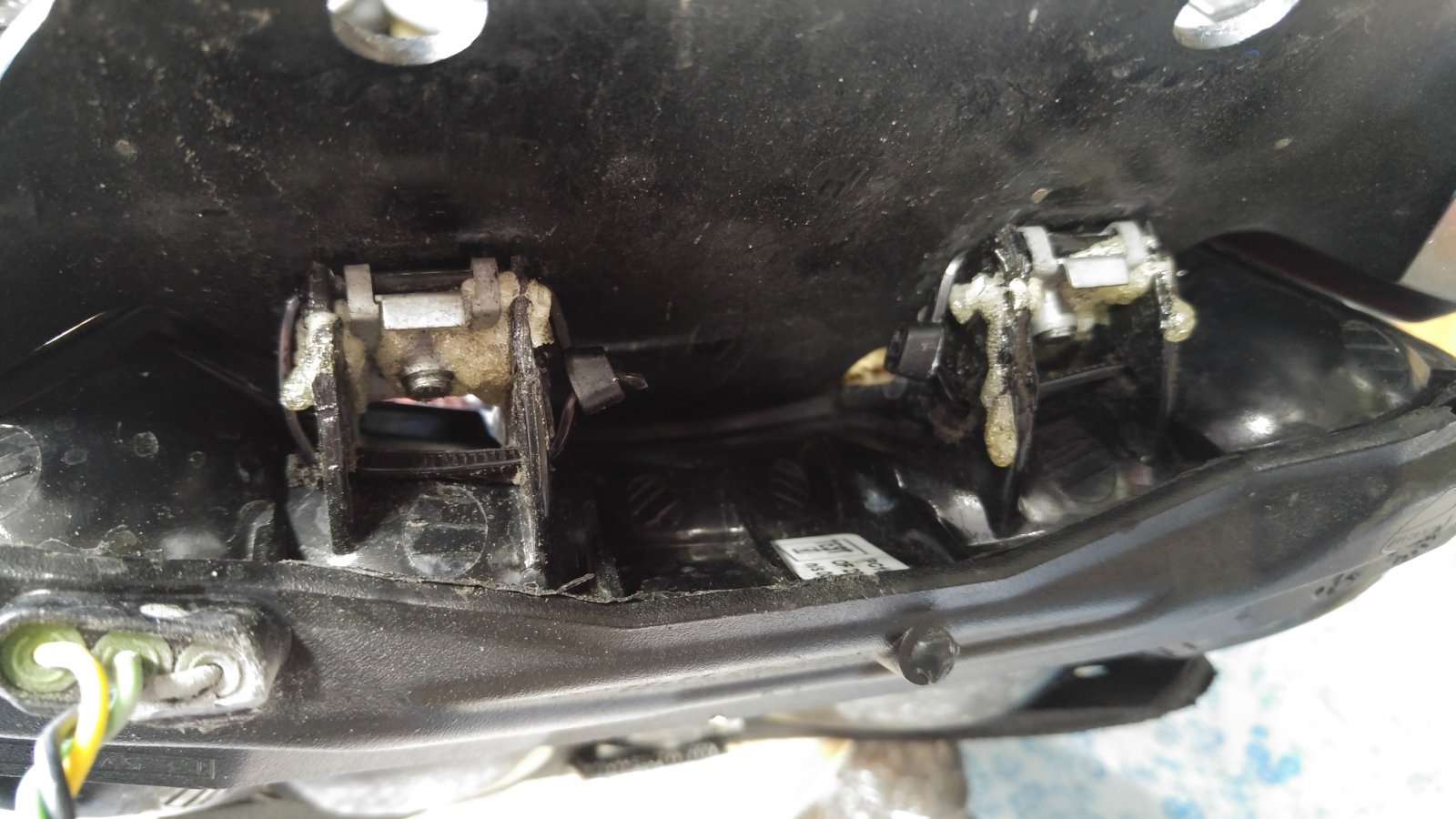

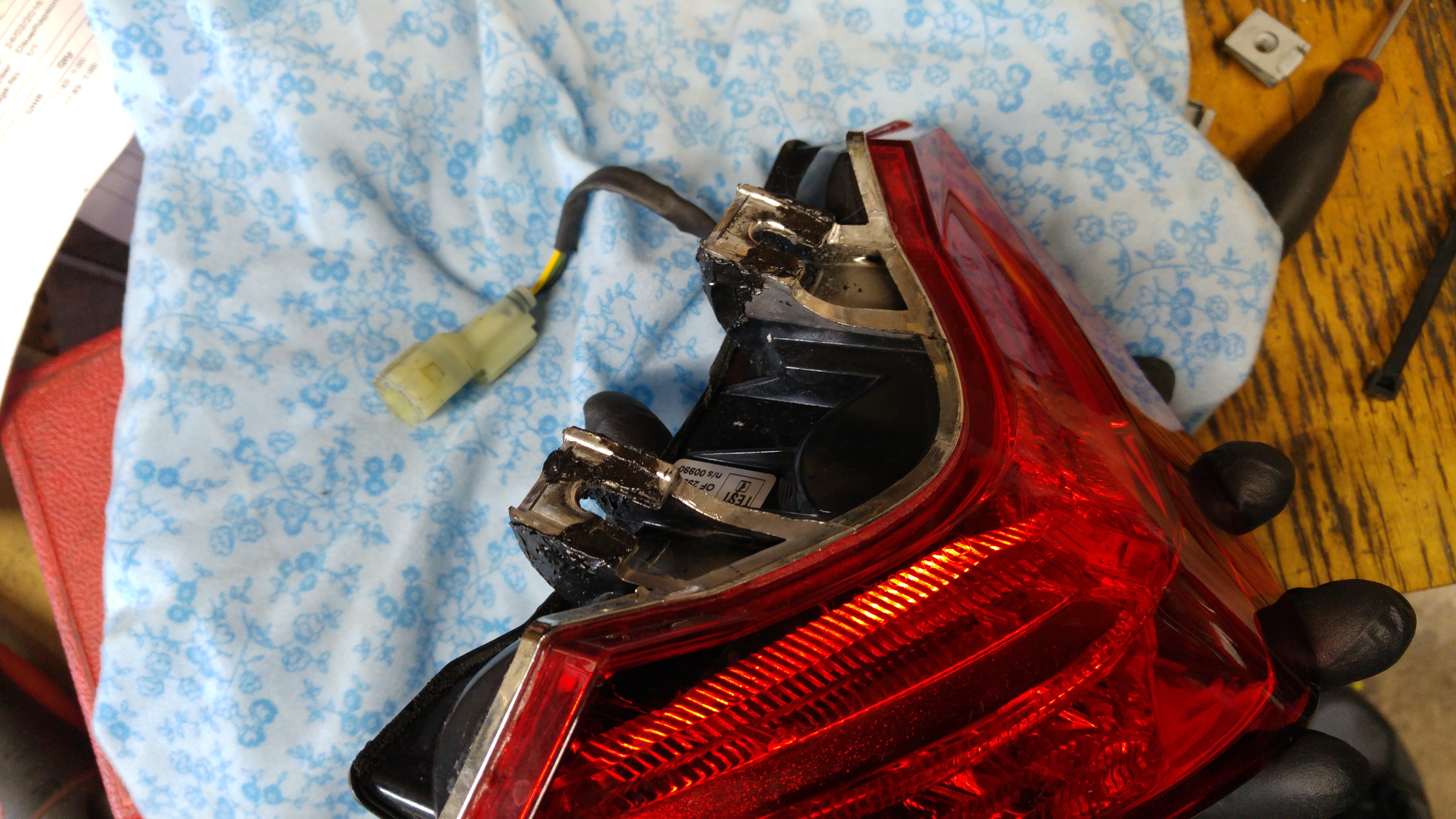

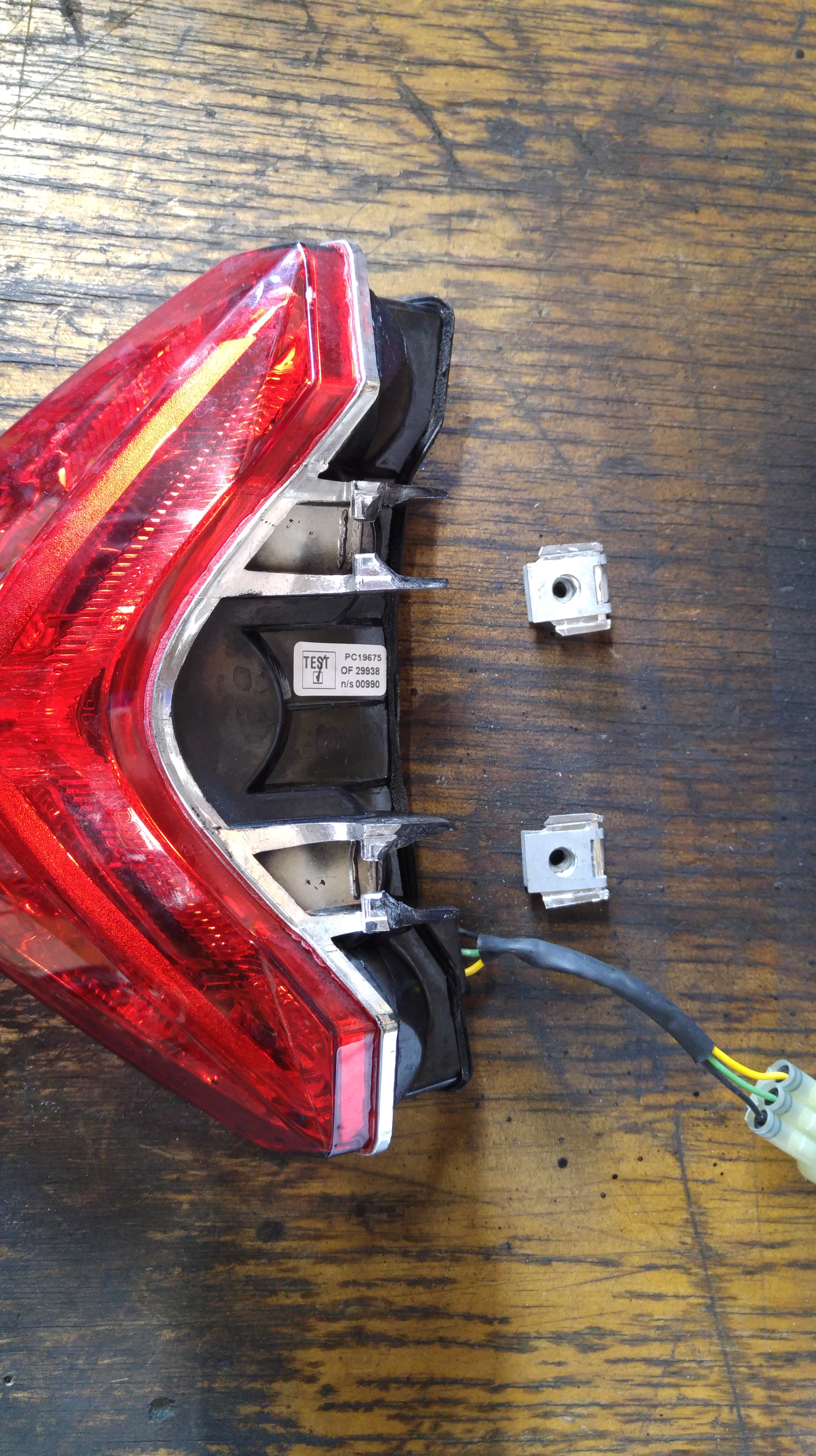

    The tail light broke it's mountings and was flapping around so I taped it up and headed back to the place that I bought it from, I paid a chunk for a warranty so I thought a vibration related failure (probably) would be covered. Nope, they said it was probably caused by someone leaning on it so was not a manufacturing defect.
    1, it is under the tail
    2, the bike has a givi top box rack
    3, they wanted around £180 to replace it.
    So back in the empire of clutter I find 'Gorilla Glue superglue' the packet said it had rubber in it for vibration resistance. Don't bother, it lasted a mile.

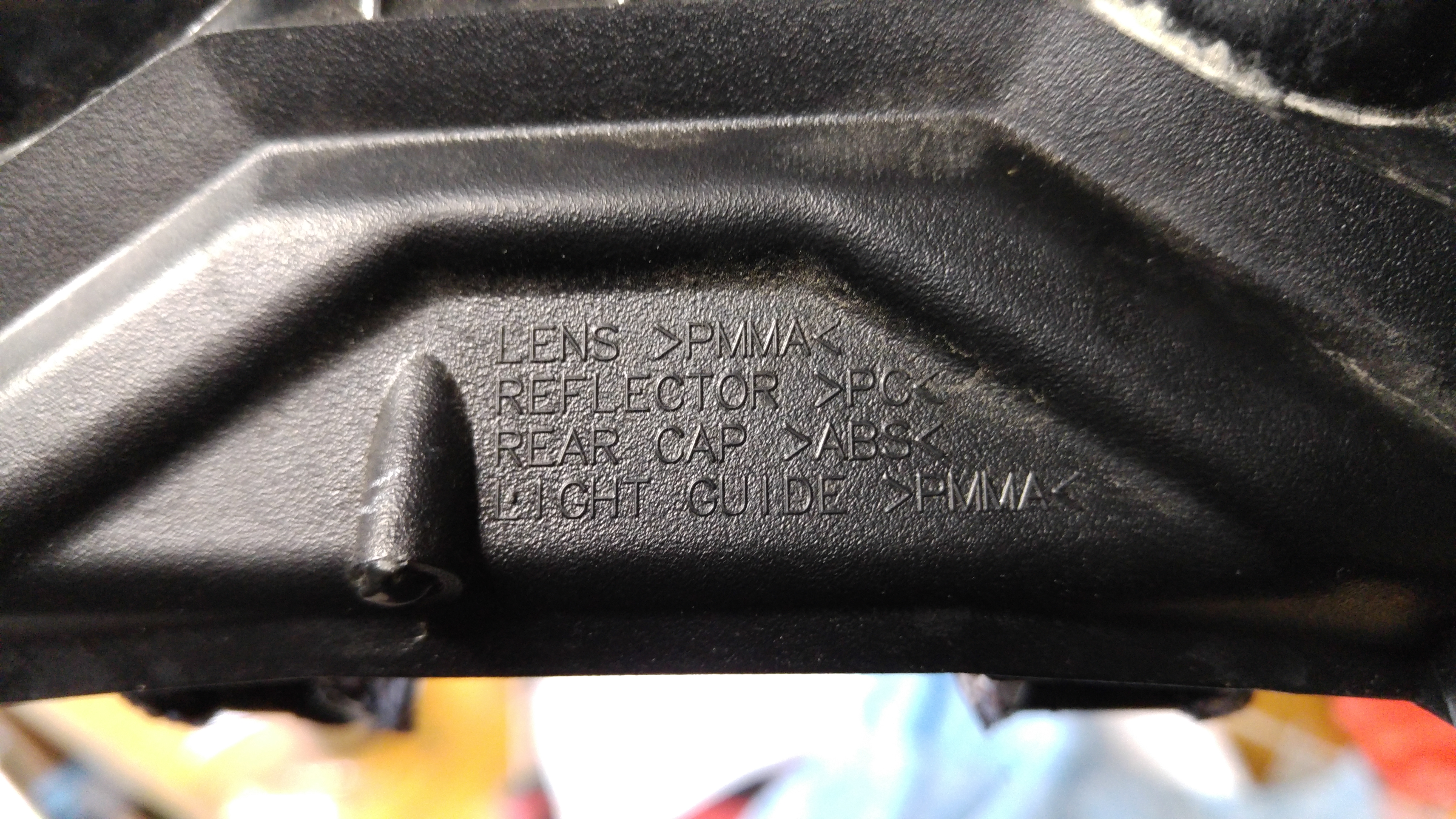

    Plastic welding? I have an old gas soldering iron with a blade tip, the case is ABS plastic and I have loads of zip-ties (also ABS).... This one worked for 5 miles but then failed right next to the seams from the repair, I think some left over superglue contaminated it as the plastic in the breaks looks bubbly, like an Aero bar.
    NEXT

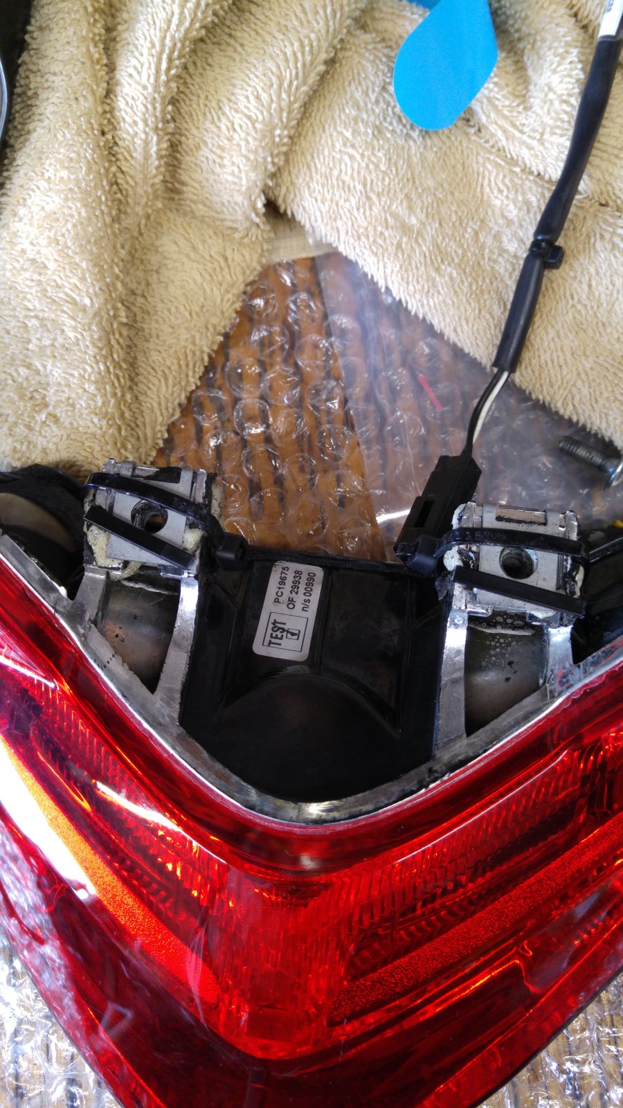

    Proper Gorilla glue, given 24 hours to cure it did it's expanding magic and this time I dremel'd a couple of slots in the supports and put zip ties around the repair... 20 miles to get the bike MOT'd and home again and it's all good, another 20 to Squires and the glue had failed but the zip ties are doing the business.
    My FINAL attempt will be some Sugru after getting rid of all the contaminated plastic, I also have a brand new light in the post but I want to cure this problem before throwing a new light in there. Just ordered it online so it will be a bank holiday project.

  4. I only took them during the Plastic weld repair...

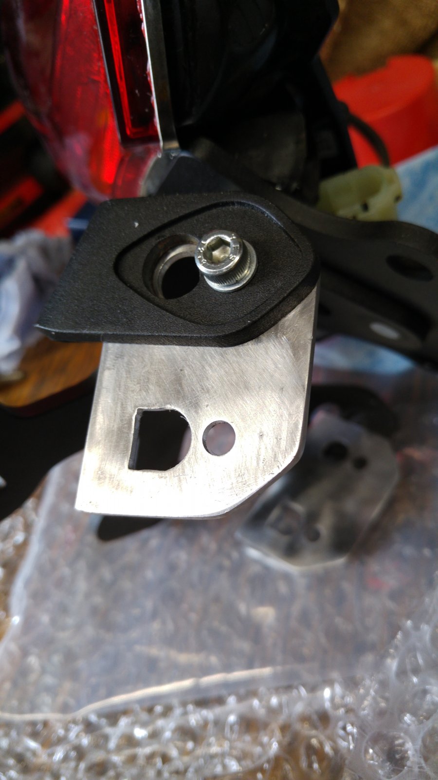

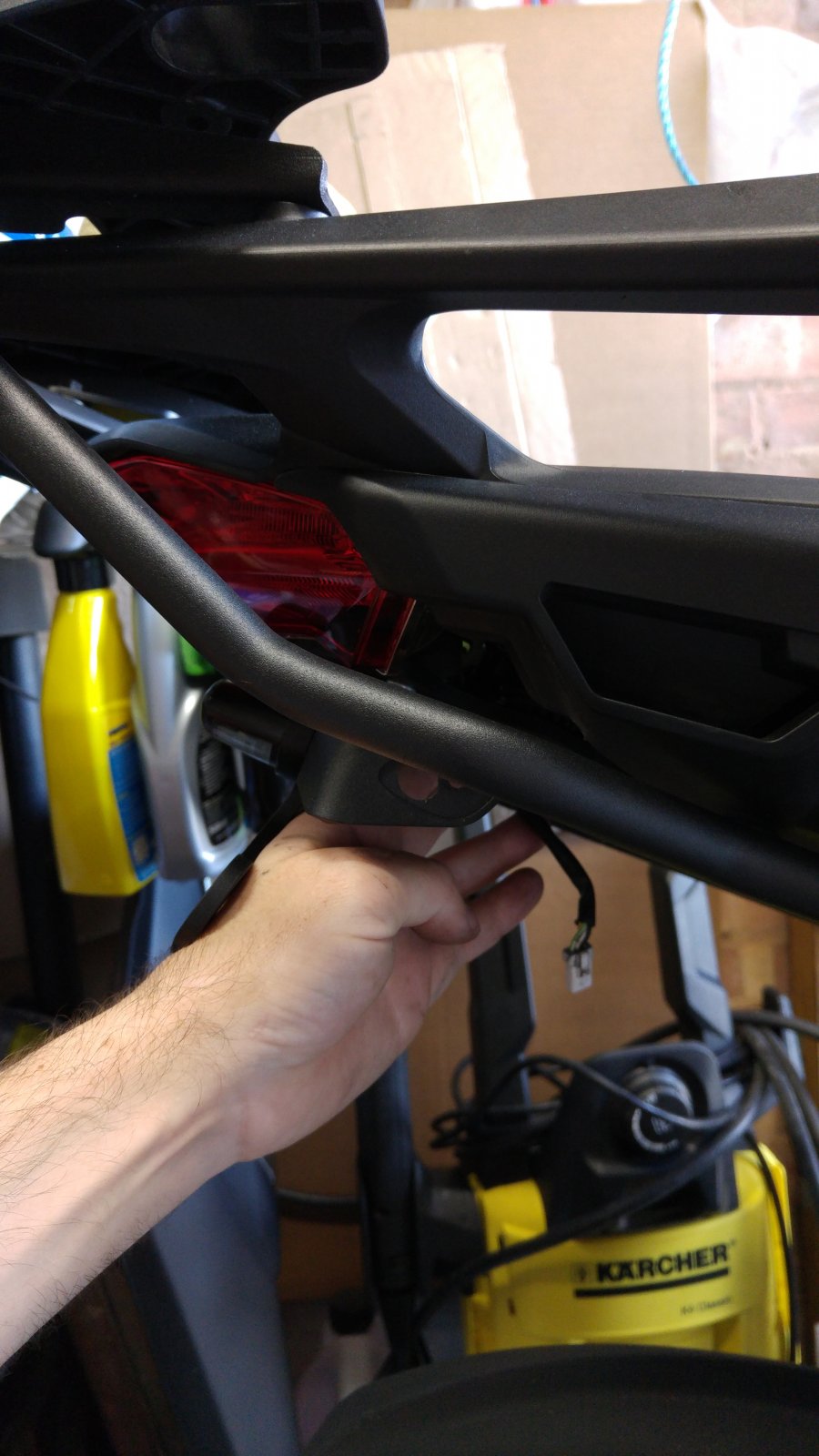

    My other bikes have had big floppy numberplate hangers, the STR was the most notable but here's the thing, the designer knew what he was doing, he designed the tail light to attach to the subframe, not the floppy bit... I think that may have to happen.
    If I do it then I will take plenty of pictures and if it's successful I will do a guide.

  14. I have the new light and the Sugru so will put a bit of that on there to re-enforce it a bit, also just decided to go for the Evotech tail tidy as it should be more rigid and looking at the pictures Shorton linked to it should work with my Panigale LED indicators and panniers, if not then I will have to get some Rizoma's.
    I will probably get it fitted on Friday.

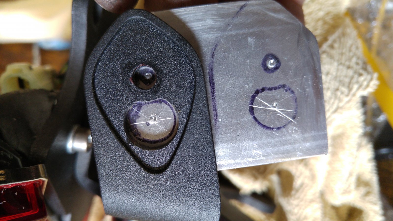

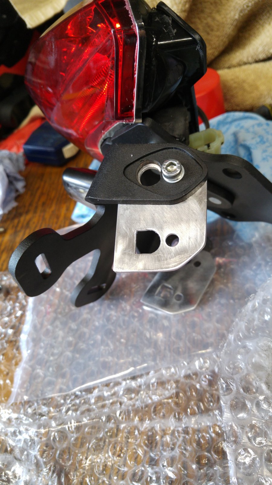

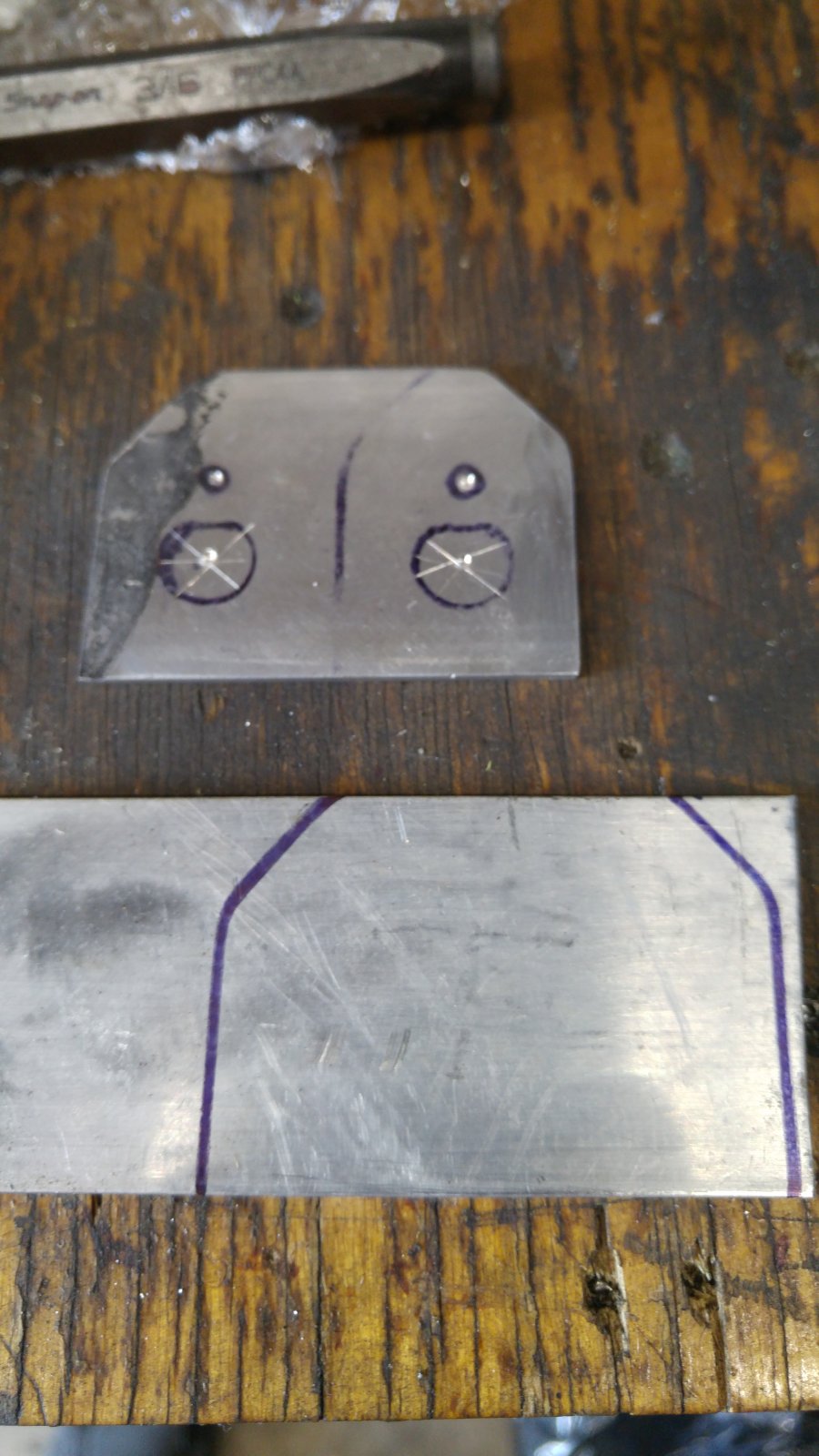

  15. A little update, the Gorilla glue has NOT failed, I was trying not to over tighten the bolts and over stress it so as it turns out they worked a little loose :blush:
    So the tail tidy, that has not gone on either as the indicators and top box rack can't both be on, and I like having somewhere secure to leave my helmet.
    I took some pics of the repairs to the original tail light and my solution to the tail tidy problem so I will upload those.

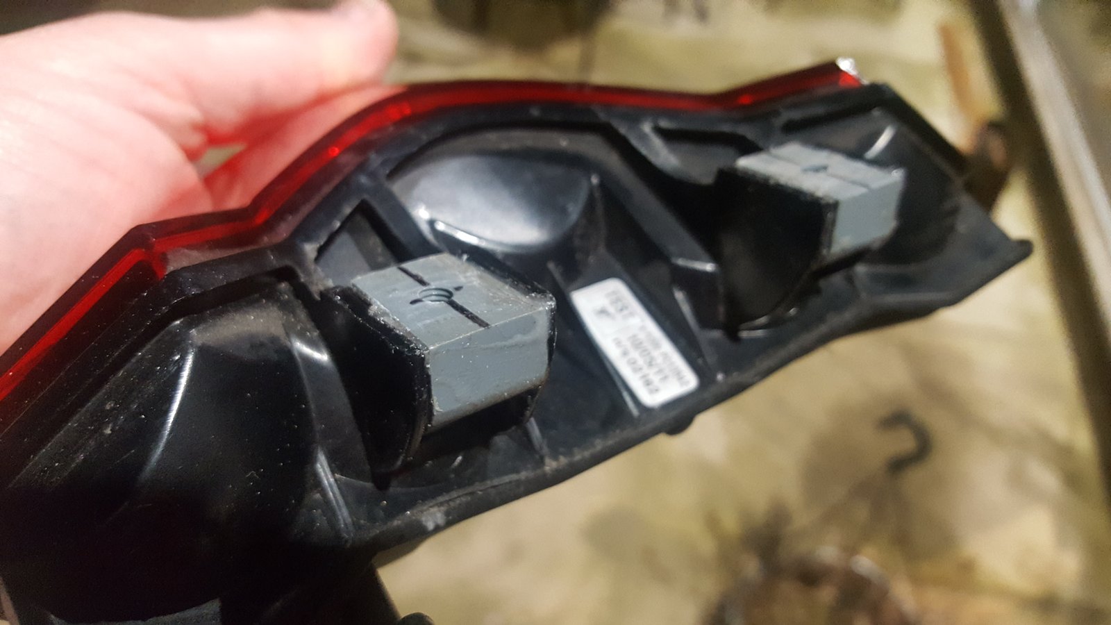

  17. Mine failed last week. My fix in the photo. 2 blocks of nylon cut and glued in place then drilled and tapped. Solid as a rock now.
