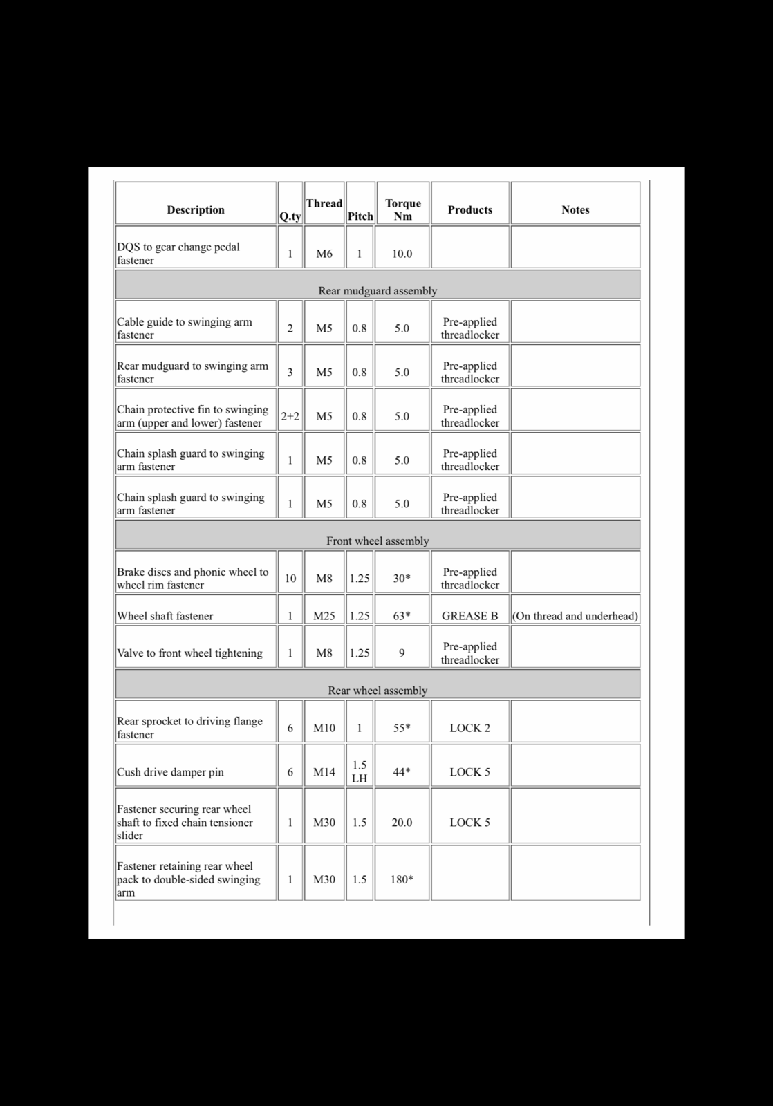

  1. I was looking in the owners manual to get the rear wheel nut torque setting for chain adjustment. The manual says "take it to your dealer to adjust the chain". So even the most basic of tasks; they don't want you do do. !!!!!!!

  7. The problem is not many of us have the correct tools to get to the very high torque settings on the rear wheel nut torque, sometimes a long crowbar is also needed.
  8. A crowbar is never going anywhere near my Italian mistresses.
  9. :p:p
    Well 280nm for your nut at the moment, it will need one:p:p

  11. So does anyone have torque settings for the V4 Multistrada, the ones I’ve seen suggest 180 Nm ?
  12. Yes is 180nm for rear M30 nut.

  17. I had my V4S serviced today, when asked they advised the double swinging arm rear axle nut is torqued to 180 Nm, the 280 Nm is the single sided swing arm.
