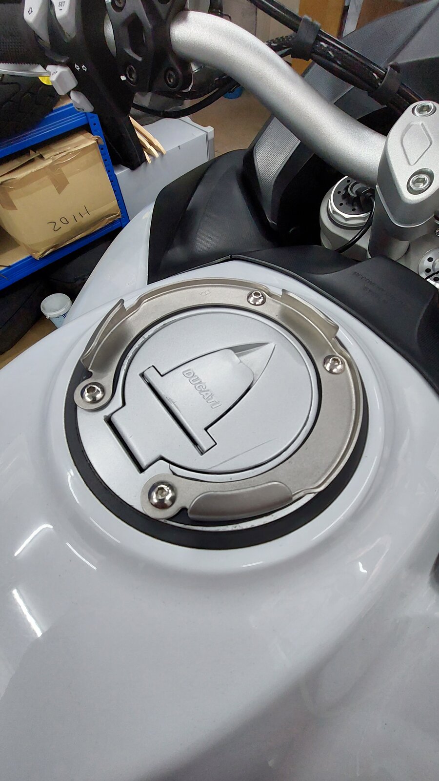

    Second question - There is a tank bag ring, but the previous owner has kept the bag. Can anyone identify which brand this is? It doesn't look like Givi or SW-Motech ...

  2. Front is fine, rear needs more umph'
    Nice tank bag ring no idea of make. Undo it & it might have a brand or serial code on it you can search.

    Sorry, I can't help with the tank ring.
  4. It's an Oxford tank bag ring.
