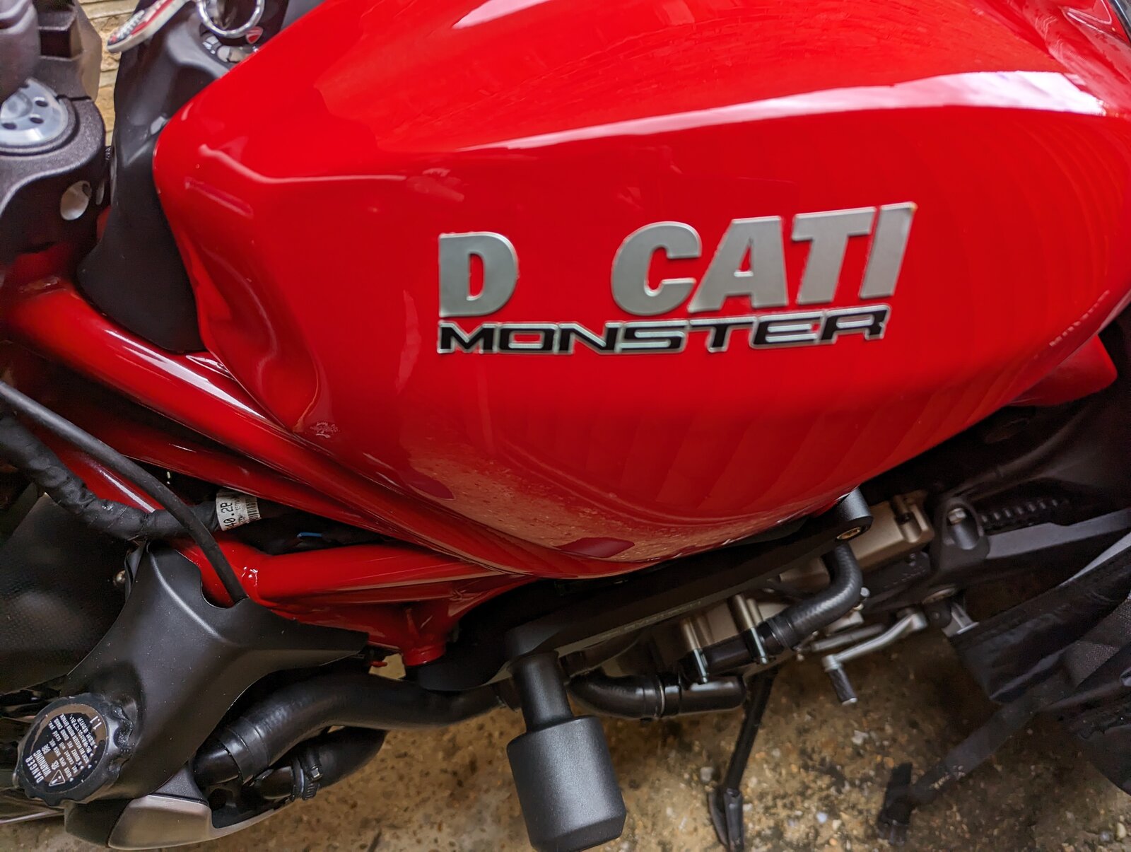

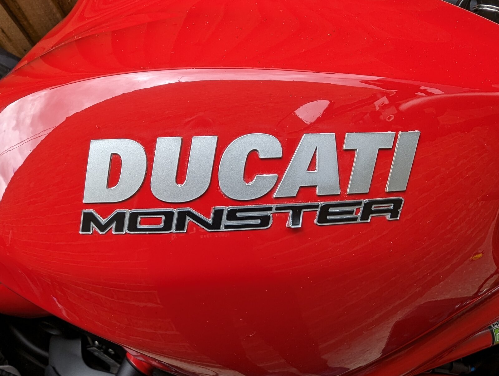

  1. Hello all,
    I have a 2014 Monster 1200S and over time it has been an Ucati and currently D’cati as various letters fall off, which is getting quite tiresome. IMG_0695.jpeg IMG_0696.jpeg
    I’m interested to see what other owners have done, whether to buy replacement lettering/decals from Ducati or Steine Dinse, or some of the aftermarket kits that are available?
    Thanks
  2. I’ve not experienced this on mine but I have had lots of trouble with the adhesion of tank pads. In my experience it always comes down to preparation. Don’t do it on a cold day. Thoroughly clean the surface, use degreaser and/or alcohol to ensure an oil residue free surface. Warm the surface and the sticker with a hair dryer. Sorry to teach granny to suck eggs…
