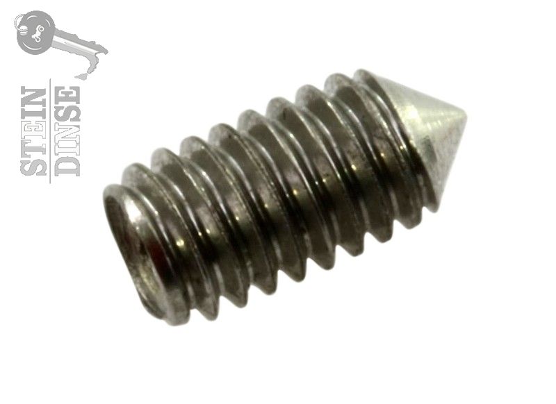

  1. Hi, anybody know what size the grub screws are that hold the tank ring to the tank, what length are they, M4? And are they cone or cup etc,?
    Thanks in advance
    Jon
    0.80 euro on stein dinse
  3. Thanks, but does anyone know the actual size and type of grub screw

  8. I think it's m4 and a cone grub screw (not certain), just don't know the length. You could buy 100 for that price.
    Jon
  9. If the picture above is one (which I think it is) then it is a cone, if M4 then scaling the photo it looks like a thread length of 8mm and 10mm with the cone. Not sure if you would measure the overall length or just the thread when specifying though. So either 8mm or 10mm depending.

  11. M4, 8mm overall length, 6mm excluding the cone. Take a 2mm hex key. Make sure the ones you get have a deep recess for the key too.

  15. didnt have one to hand thought a picky would give a vague idea especially the type
