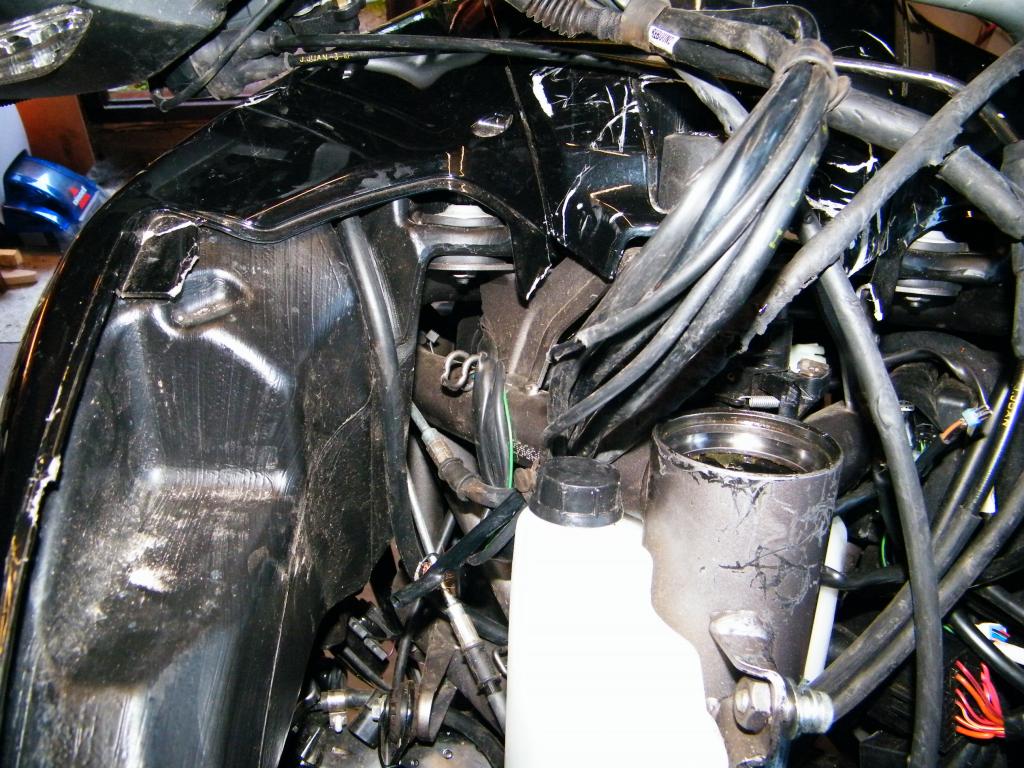

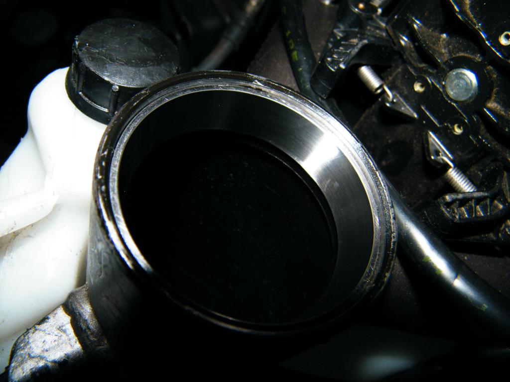

    My Cat C write off (bought off e-bay on pallets...three of them!) had the whole front end ripped away and I had to take out the old traditional buggered up bearings and replace them with tapered.
    Have to say they did drive out ok with a blunt heavy duty screwdriver from each end of head stock. Ducati Photos 029.jpg Ducati Photos 011.jpg Ducati Photos 098.jpg
