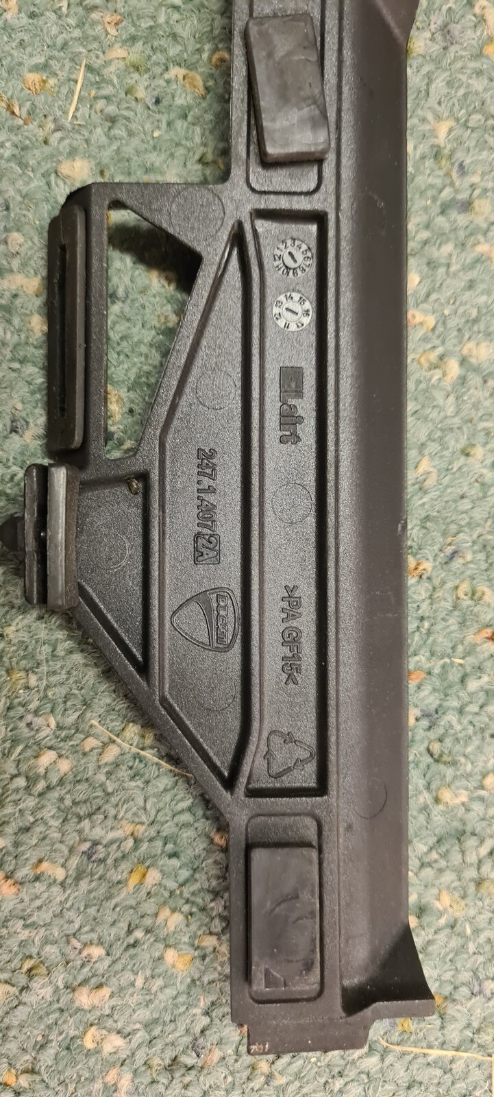

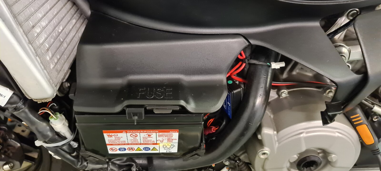

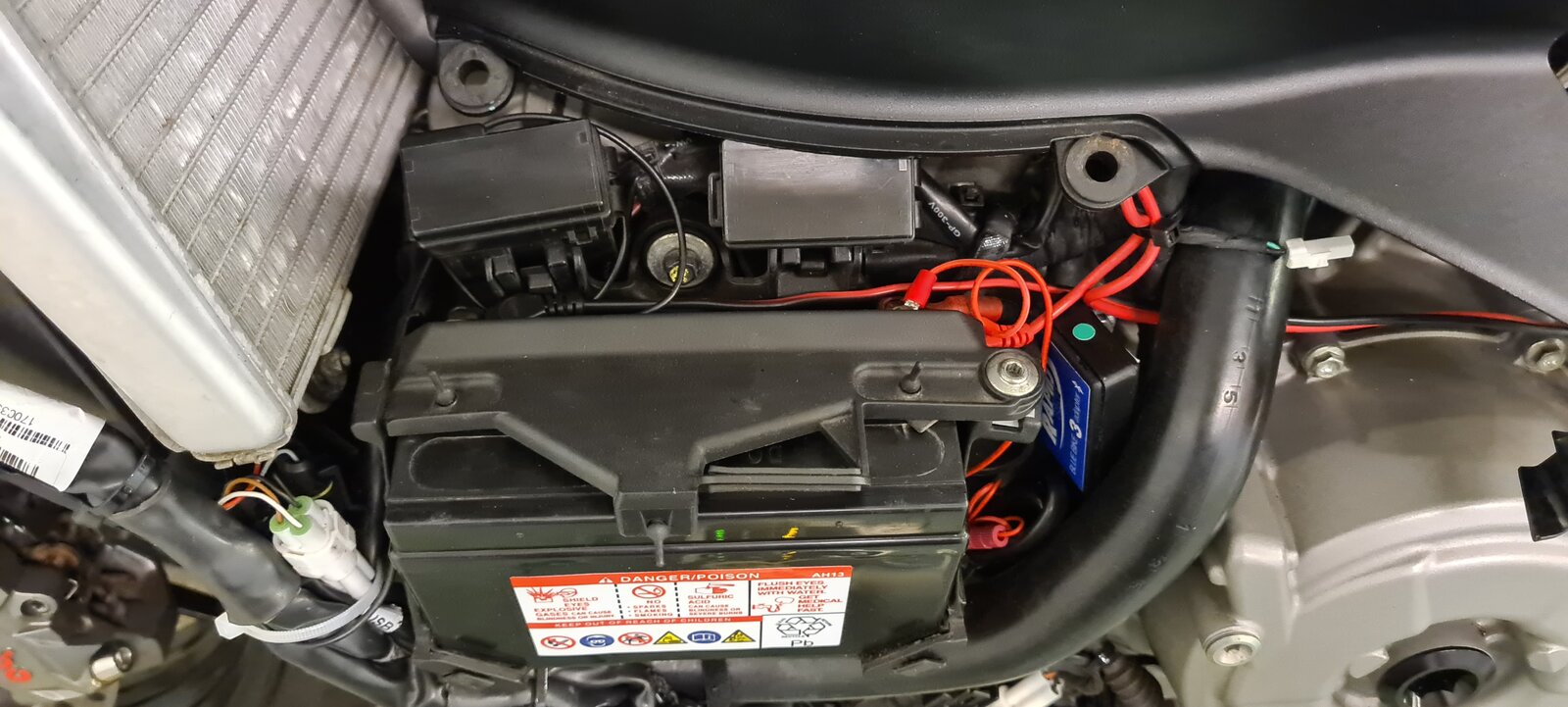

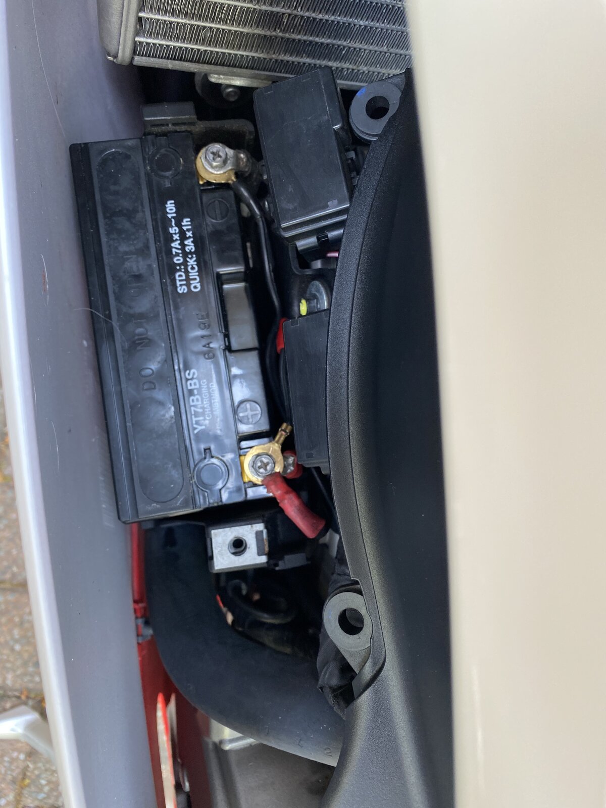

2 actually; 1) Just got my bike back from the shop and they advised she smokes a lot (via exhausts) when you first fire her up. W/o knowing much else they’ve suggested it’s possibly/probably the valve stem seals. I explained only had her 6 months and due to winter barely ridden but yes she does smoke but once warmed up it stops. Took her a thrash tonight and same thing, plenty smoke for first few mins (as I put helmet and gloves on) but then zip, and certainly nothing when I pulled in 60 miles later. Not questioning the dealer, as we agreed I’d ride her and see if it continues/if just a lack of use issue but what do you guys think, any other suggestions? Would valve stem seals only allow oil to pass during warm up, would they expand/seat once engine up to temp perhaps thus explaining problem going away? 2) looks like there’s meant to be a cover over the top of battery? Only see a CF one of eBay, which is fine I guess, but are screws meant to hold it in place on right side of pic as eBay one doesn’t appear to have holes? Anyone know a part or have one they want to sell? Thanks

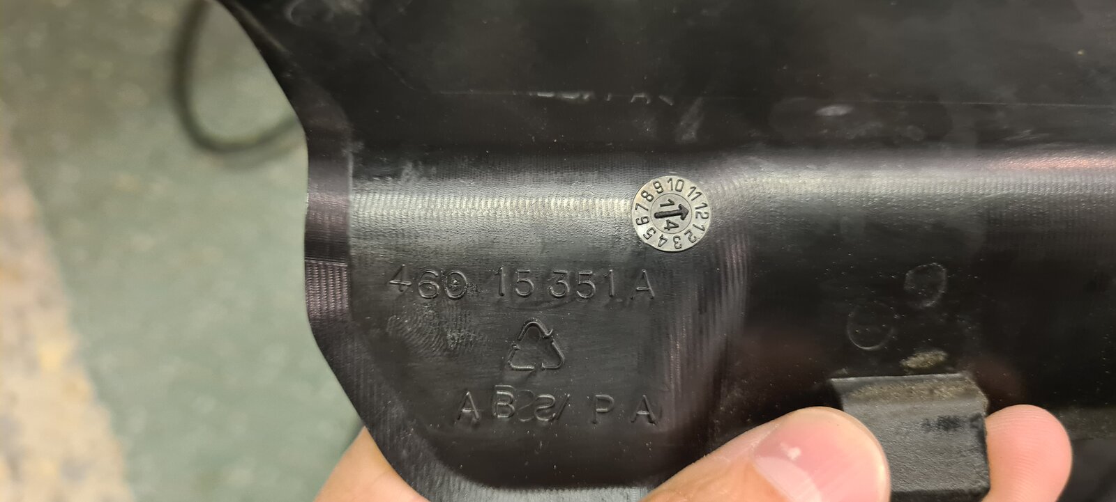

For #2, there is a plastic cover which mounts on the two holes on the right of your picture. There is also a plastic bar that holds the battery secure in place. See pictures which have part numbers I think. Can't help with #1

Cheers Petsmith, I've ordered a stock plastic piece, although when I was talking CF I meant for the top cover piece, not the part that actually holds the battery in place. You don't recommend that either?
