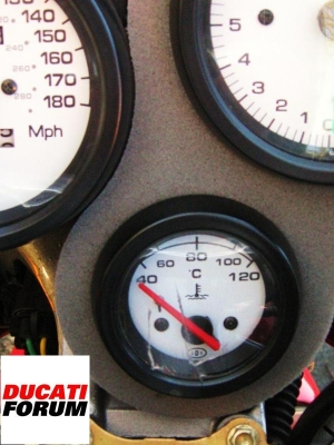

  1. Why does the temperature gauge glass always crack? and is there a way to stop this?
    Does anyone know where I can get a replacement as they seem pretty rare.
    Thanks.

  3. Gary, I have white clocks on mine and the temp gauge has that dreaded Ducati crack, I think the clear plastic 'glass' is too tight in the bezel and cracks when the gauge gets hot. I bought a second hand black one on ebay for around £20 - they come up now and then. I thought it would be a doner for the 'glass' but they need to be cut off very precisely, the bezel will not come off without breaking. In the end I forgot about it and the bike has had the problem for the 10 years I have owned it with no detriment to it working

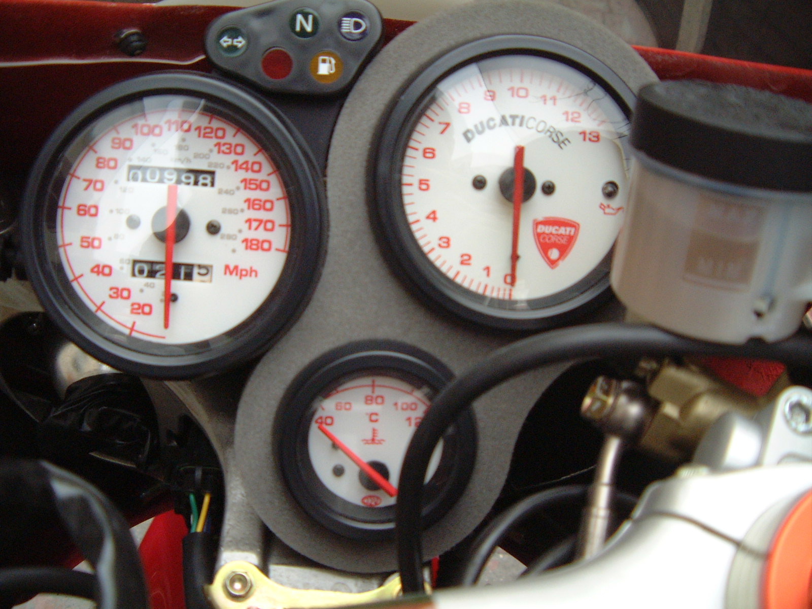

  6. How did you get the odometer to show the model of your bike?
    Nice trick!
  7. Pure luck, it just happened to be on 998 miles when the gauges were swapped, you can see that I had also done 21.5 miles on the trip meter, so that was the last run I did before the gauge swap.
    The now defunct Superdials, run by Rob Driver at the time, did the swap and he was the one that explained how to crack the bezel open without damaging it. Quite worrying watching him do it!!
    Rob sold out to Lockwood when he gave up the business.
