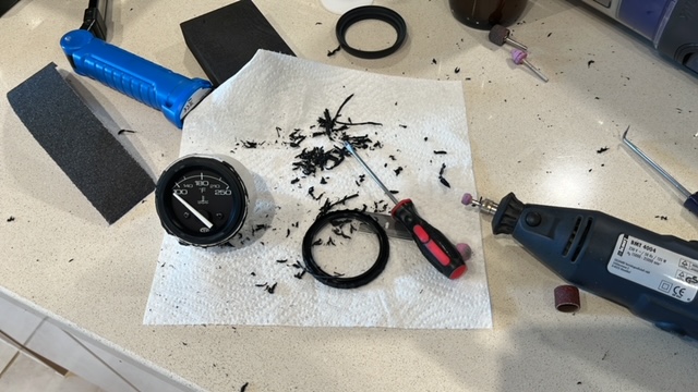

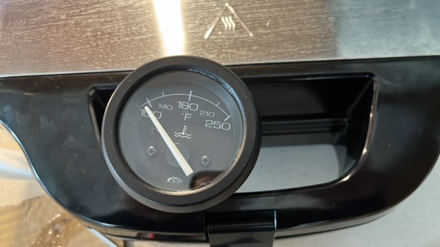

  2. Hi All, found a chap not on the forum who supplied new bezel/ perspex to solve the cracked glass on the temp gauge, not sure as he is on Ebay I should post a link as it may not be the done thing? but used a dremmel to cut away old bezel which is very soft and although takes a while very easy then refitted new bezel etc and problem sorted

  8. I repaired mine by carefully removing the bezel. It's held on with several spots of glue
    I then removed the broken glass.
    Purchased a 2" domed watch glass and glued it all back together.
    If you look carefully at the original you will see that it is domed

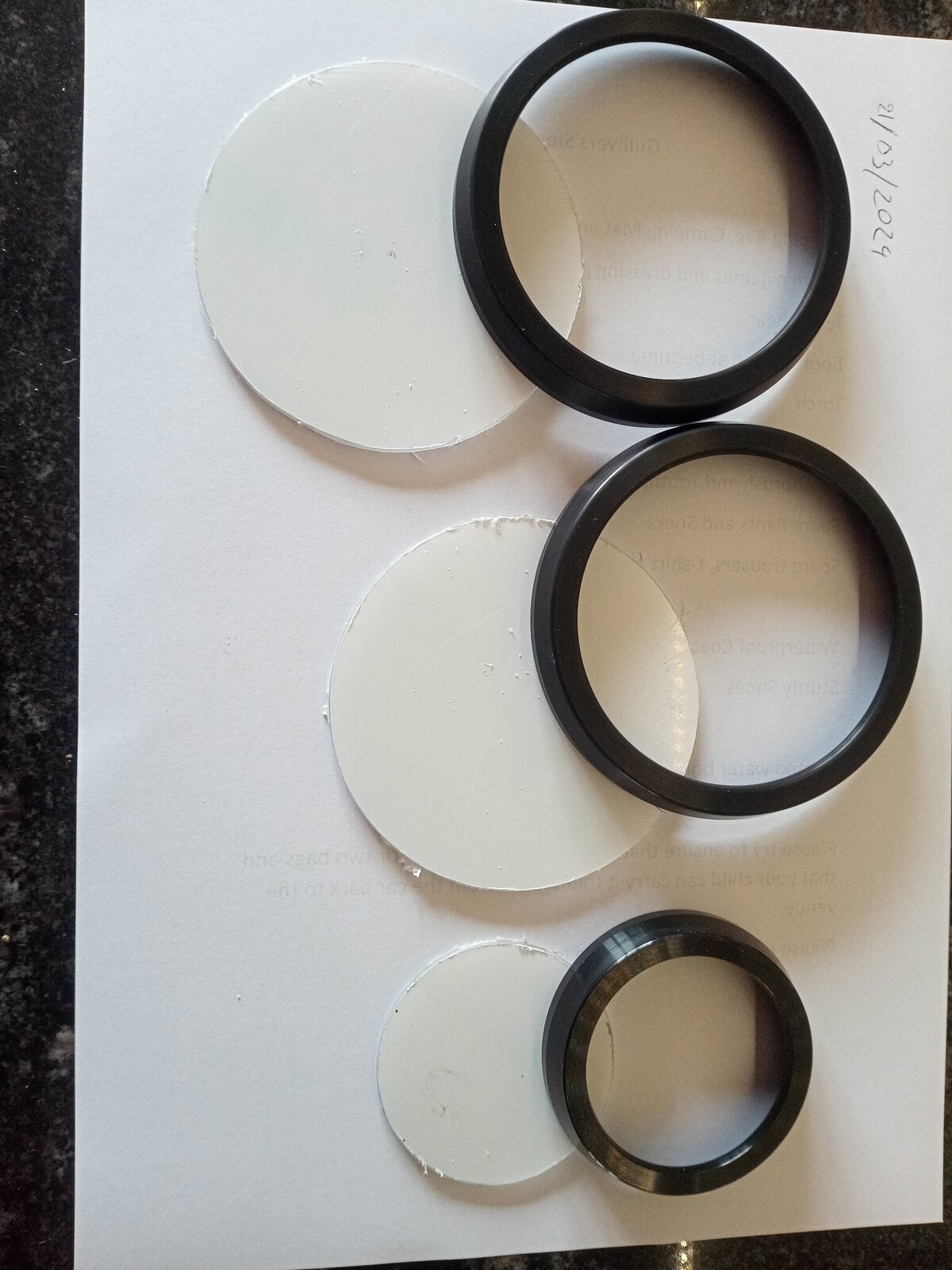

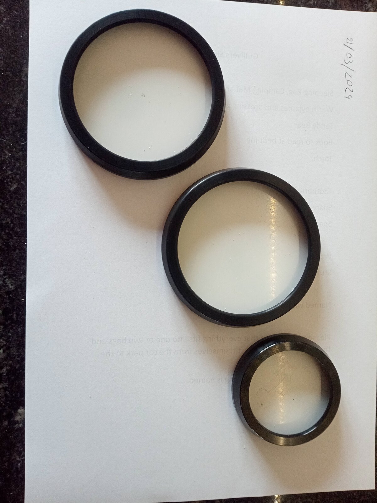

  9. I make replacements in anodized aluminium with polycarbonate lenses. IMG_20240321_113201_984.jpg IMG_20240321_113150_403.jpg
  10. t
    Yes its very close and looks original when done

  14. I sell them for £40 each or £100 for a set of 3 plus postage. I usually make them to order but I think I have one set of 3 left at the moment. Can't check as I'm on holiday. Otherwise its 3 weeks or so for me to make some and have them anodized.
