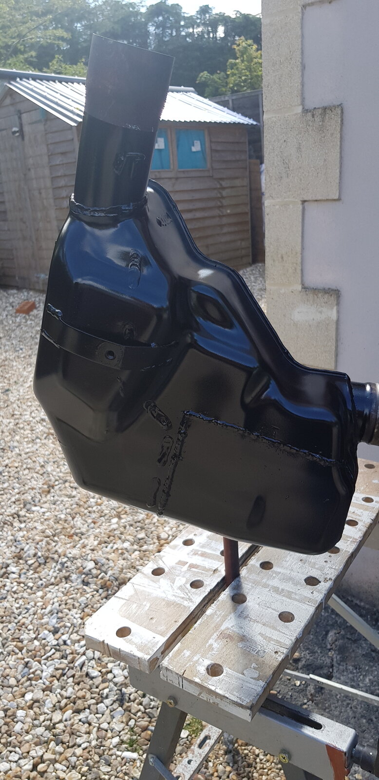

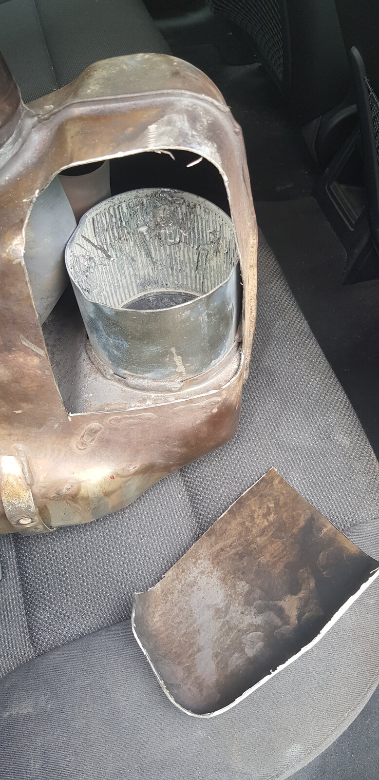

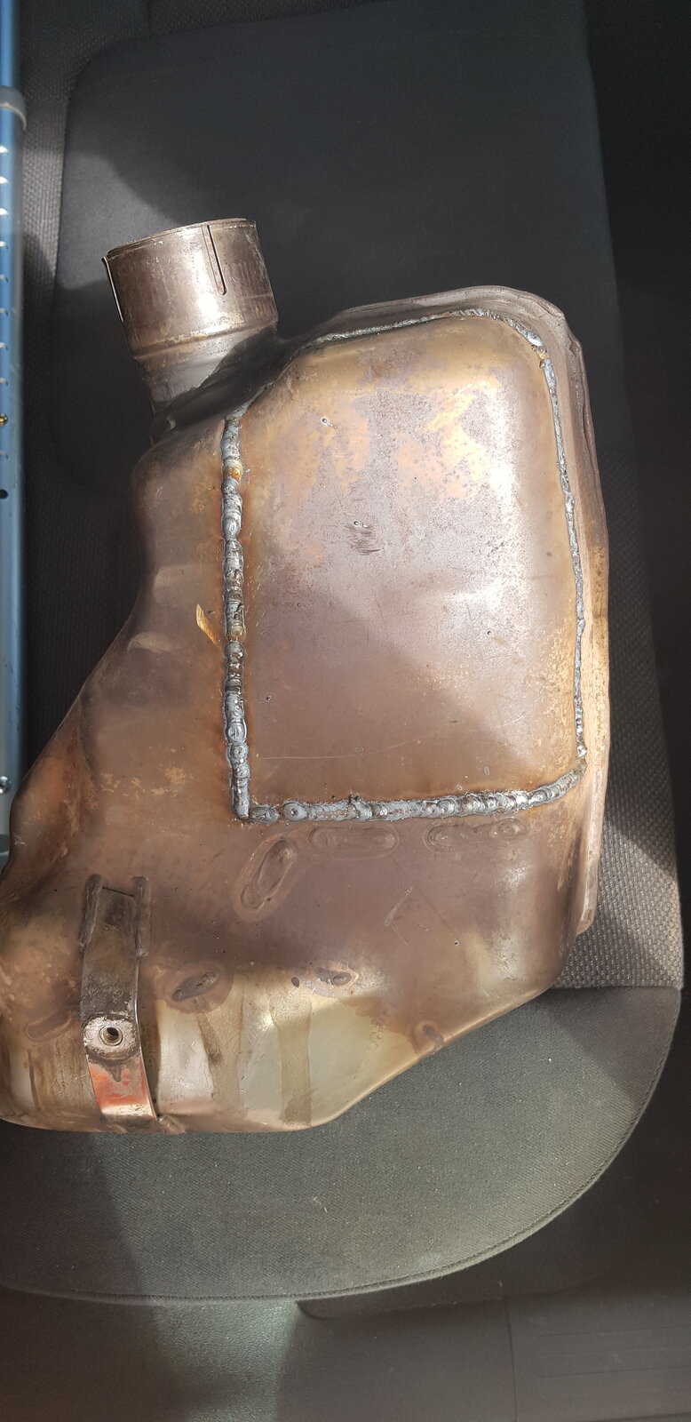

  3. The Termngoni end can is straight through so without the cat it would be too loud, I cut my box open and removed the internals before welding it up, the sound was just about right but I've now invested in a full Termngoni which has a removable baffle in the can.
