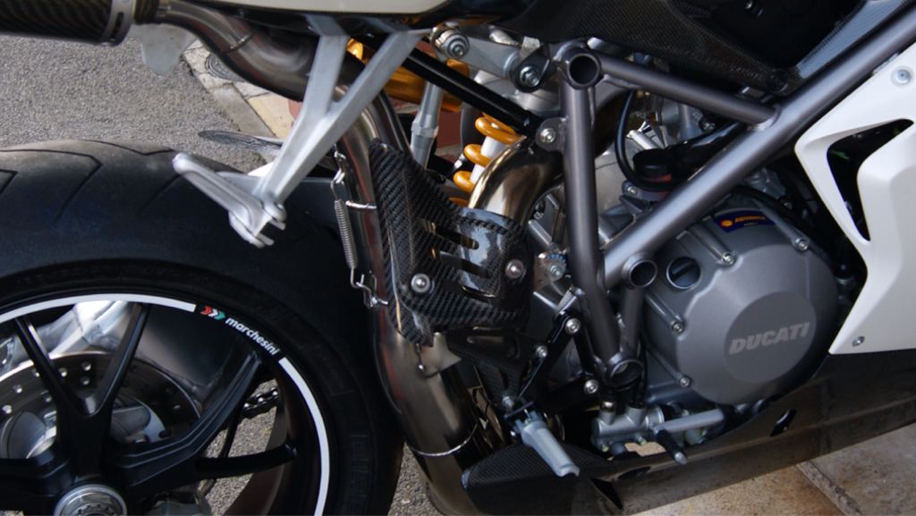

    If you look at the right side where your tea tray is.....then look at the tiny carbon heat shield that is supplied with the termi system....it's a whole lot neater and that servo you loose weighs a ton.
    Mmmmmmine!
  8. Sell your granny or get the missus to work the street to raise the extra!
  9. How can I say no to that! By the way your bike is ridiculously clean!
  10. Ain't they all like that? ;-)
    And I don't polish it half as much as I polish my helmet ;-)
