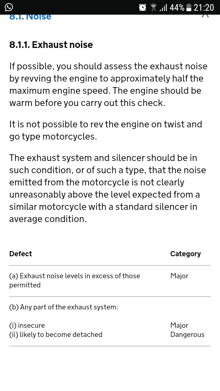

Doubt you will have a problem but if you are massively worried put a sticker over the for race use only - and put baffles in @cookster will confirm but noise is mot testers discretion I believe.

To the letter yes it should fail if exhaust has not for road use on it and as mentioned just put a sticker over It, as noise is concerned as long as it's not stupid loud you should be ok.
My Termi’s had metallic stickers on the inside face saying not for road use so I just peeled them off. I left the baffles out and got an advisory. It’s very loud, but not as loud as say your standard Harley Fat Boy. If it doesn’t fail the MOT and you’re marked up not for road use I’d find another MOT place, best to be safe on your bike, it’s the one area where it’s worth having a proper check.
